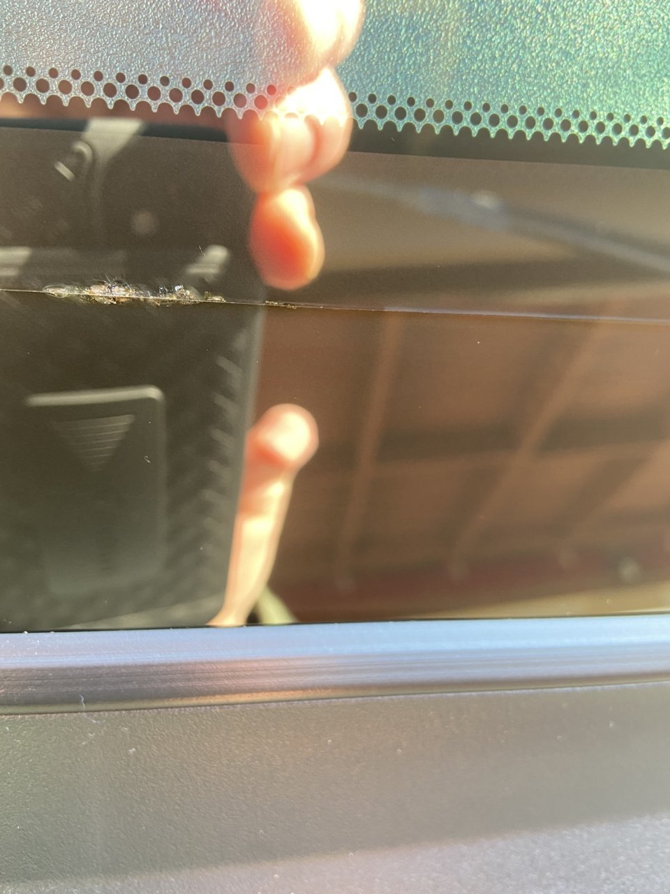

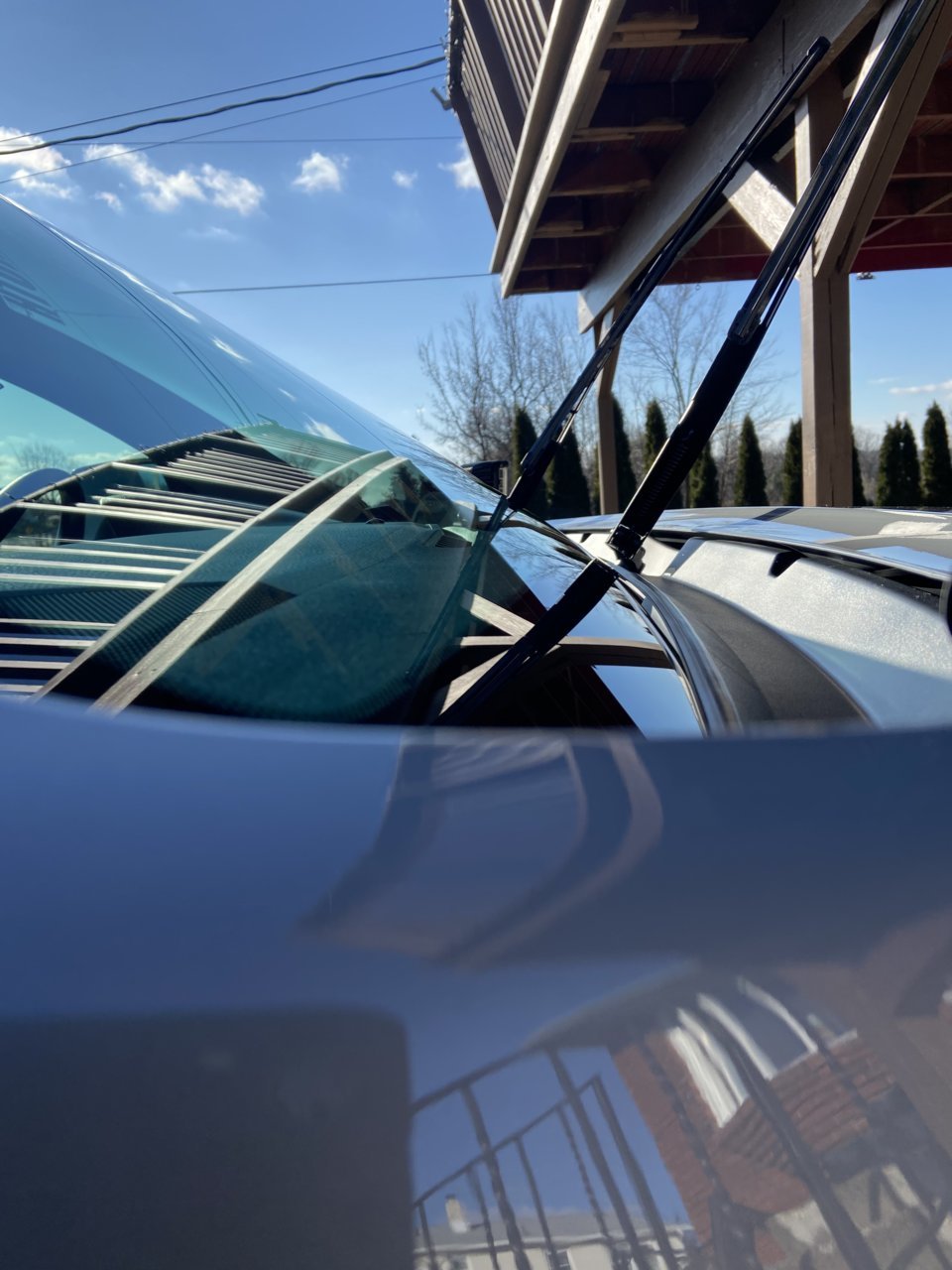

    Now I have to wait until Monday, service manager not in today. Run down, glass all cleaned. The what looks like a chip is in the middle of glass. Look closely you will see a line run across. All the bubbles are behind that line.
    where’s the stone chip impact chip??

    Once the outer glass cracks, it allows air and other contaminates to infiltrate into the crack to the laminate layer.
    Windshields are technically 2 pieces of glass sandwiched together with a plastic layer in-between.
    Water and moisture will penetrate into the crack and cause further deterioration.
    What you are seeing is the plastic layer+ bonding agent separating and oxidizing from one side of the glass.
    It looks like a clean break on the top of the outer glass, but not a clean break all the way through the outer glass IMO
    If the crack never occurred, the "bubbling" would not be seen.

    I really think you're wasting your time going to the dealer when there is clearly an impact point and that area of the glass is well below where the defrost starts.

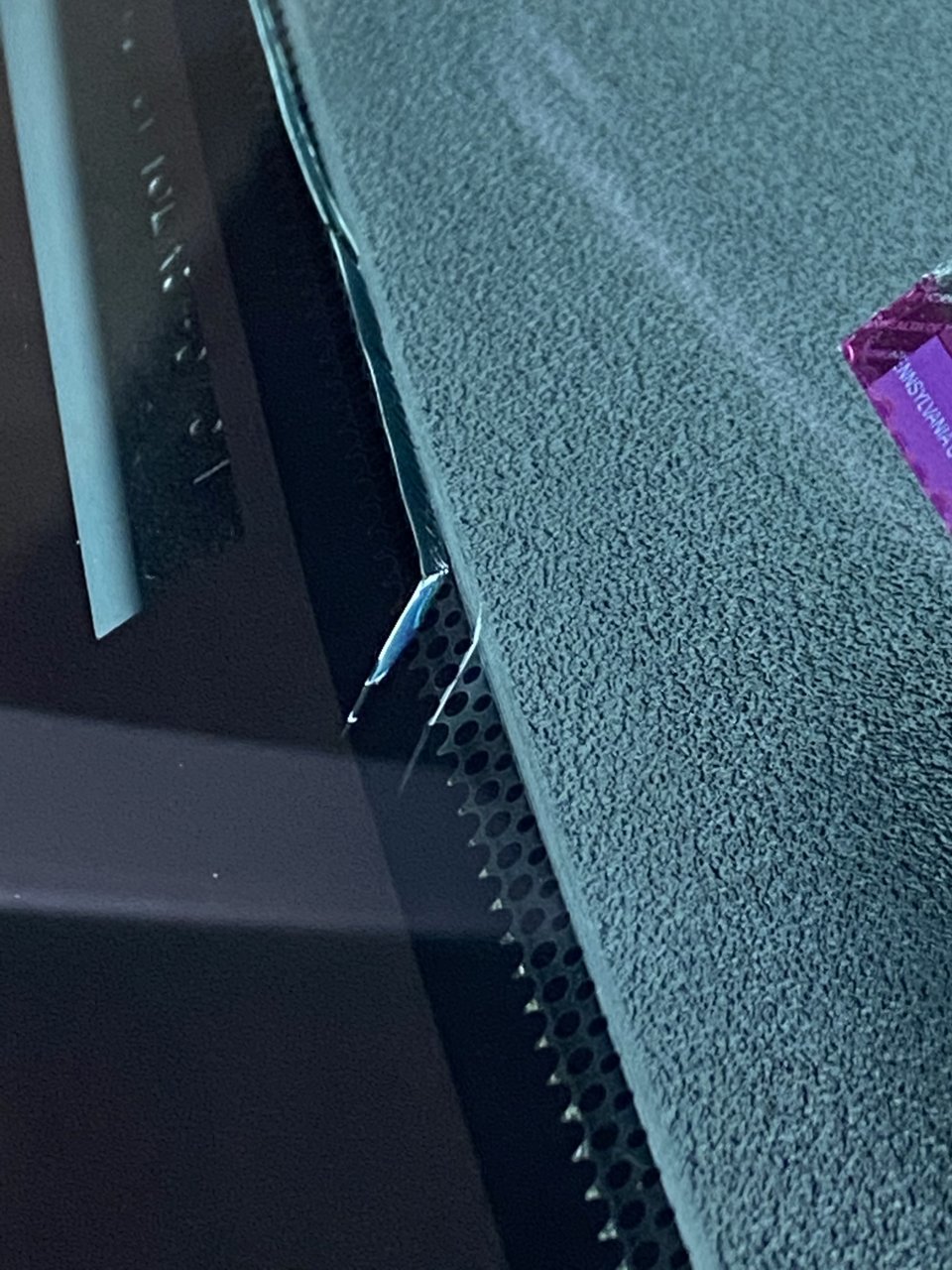

    Found some new crack this morning. The main pictures I’ve been showing are on passenger side. This picture is on driver side and there’s a 2nd crack going on. This is behind the also everything is smooth on the out side of the window from meaning no chips and on the passenger side to driver. If you take you hand and rub over the whole area you everything feels smooth but if you take your nail and scratch up you don’t the crack, if you scratch down you feel the split to about just shy of middle which you barely feel. I known pictures are had to tell and looks different in real life. I’m not trying to be anal but just want proof this was an impact of something. Also when I first noticed this, there was a burning type smell for 2 days but I don’t smell it anymore. Maybe a stress crack? All this happened about the 21 of dec when the first show happened. I’m ok if Toyota or the dealer proves to me an impact but I’m telling you there are no marks out, just what I stated above about the feel.

    Once a crack starts it’s very easy to crack more and elsewhere.
    Especially in temperature swings and when applying any pressure.
    I learned this the hard way when attempting to repair a small chip.
    I put the hardening compound in and thought, it’s cool out, let me turn the defrost on to speed things up.
    I reached up to examine the chipped area from the inside, reached up up to feel it with my index finger, applied a very slight amount of pressure and the window went from chip to 8” crack instantly.

    Yeah I know cracks spread and can do whatever as it becomes more weaker. I don’t know what caused this because there’s no chips or cracks from stones. the whole window is smooth as you run your hand across. I can see if there was pit or stone marks but nothing. Just wondering if it’s a stress crack and curious about the smell that went on for a couple days. This is why I’m going to dealer and or have a Toyota rep show me proof an explanation. And yes my area temps are not normal, one day 20 the next 60. I’ll find out in time, and let everyone know. I appreciate the answers you guys gave.

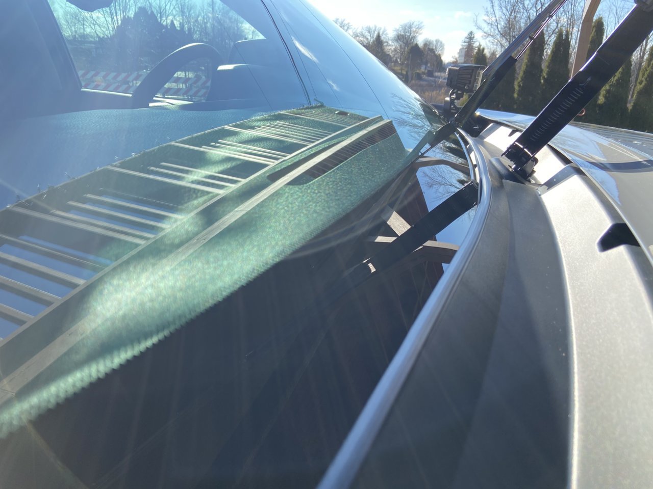

    There’s no whole, everything you see that looks like a stone chip is behind the line running across. Everything is smoothly on the out side and can barely feel the cracked line. You can only barely feel it with your nail going one direction. Dealer has me scheduled for this Wednesday. I’ll report back and let all know.

    We had a long crack along the wiper heater line the second time the heater (mirror & wipper) switch was turned on after some cold nights ... The car (not a Toyota) was practically brand new and you could NOT find a ding or even a scratch anywhere on the windshield. The crack was all internal and you could not feel it from inside or out.
    Dealer said you must have had a ding but could not find one and even the insurance guy told me that it would be hard to get the dealer to replace it ... Insurance replaced it minus the $50 deductible and the guy at the shop told me he has seen many cracks caused by the internal glass heater. I asked him not to connect the heater wires and he said it's a good idea.
    It may not be a very common failure but it creates a weak spot or if you already had a weak spot (possible impact or a ding), it will make it even weaker. We haven't missed the wiper heater thing so if you can live without it just don't plug it back. It takes me 5 minutes to reconnect just have to remove 2 small screws but I don't want to risk it.
