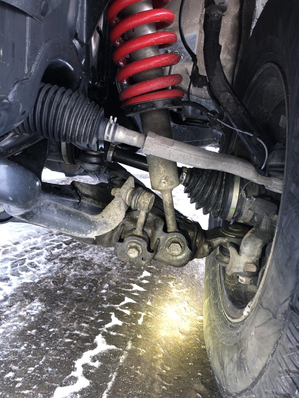

    I’ll add an easy one, do your shocks have a heim or ball mount at the bottom? Your weather kills them fast.

    Not sure I know what a helm joint is but here’s a pic
