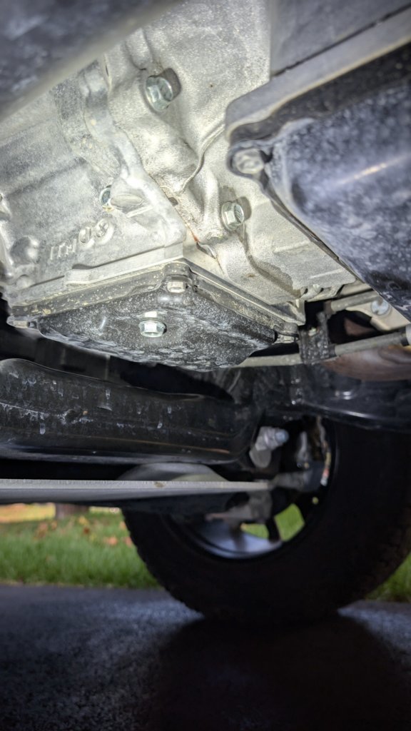

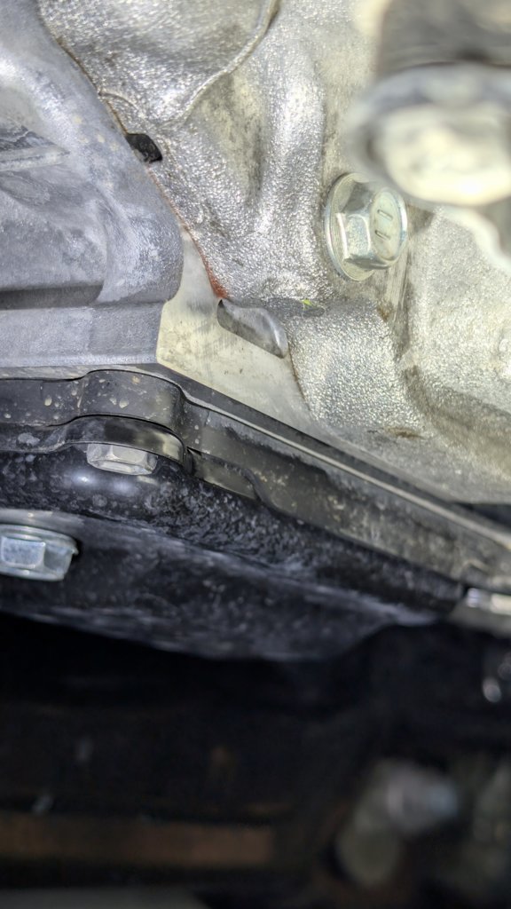

    Surprise, my '23 with about 11k miles on it has a similar issue:(, spot of oil on the driveway and crawled under the truck to find oil leaking between Hybrid motor and transmission.
    I wiped the oil on the transmission/motor in the pictures... Will be calling dealer Monday morning.

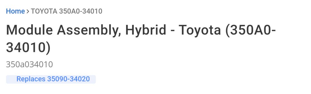

    Has the replacement hybrid unit fixed the issue?
    I see that the unit on your invoice is replaced by a new one.
