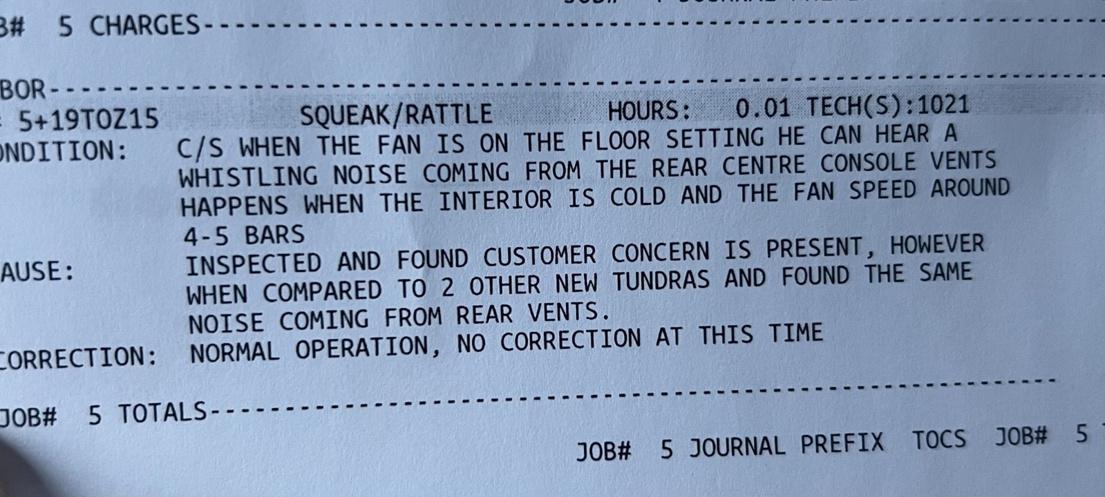

    My 2023 Capstone went in the other week for the dash lighting up like the fourth of July (every sensor, every audible alarm, every warning and error.)
    During that lengthy stay, the dealer came out the other end saying the part for the interior whistle noise was still "on backorder" (have had it in a few times for this.) Seems/feels like this is all legit, but the length of time this special order on back order has been taking is mind boggling.
    Could be inventory problems leftover from the government lockdowns. Could be Toyota legitimately ran out of parts for the new generation truck that costs an arm and a leg. Or could be simply Toyota didn't think of it. Or, could IT be this is not going anywhere?

    I took mine in yesterday for the 10K service. Recalls and I mentioned the whistle which I'm not that wound up about. Imagine my surprise when I went to pick the truck up and they had disassembled the lower right passenger dash to access the diverter flaps. He refitted the flaps and I don't hear it anymore but they weren't satisfied with the fix. They ordered an HVAC assembly under warranty. 2 days to instal it which concerns me some but what they did next was outstanding. The technician sent a complete video of the service and it showed the flap and where the whistle is with audio. Included with the video was a run through of the checklist inspection. First class stuff. They went beyond the extra mile. I've had many high end cars and never had a full video log of them finding an allusive problem. Rare in current time.
    Compare and contrast to the Ford Dealer that would have done the "we can't find the problem" refrain. Those asses were so overwhelmed.

    Very cool. I'd post the disassembled plenum and flaps video if it wasn't for the Gen2 guys. It looks to me like 50% of the time it can be fixed by tweaking the flap.

    I've been using the heat last night and today. Even though the tech isn't satisfied it's 80% quieter than it was.

    Brought my truck in for recalls, had two technicians looked at the issue, all Tundras have the same whistling noise so it is normal operation. LMAO

    Let me be more detail on this. Tech took off the vent cover, sent in an endoscopy camera to see if there is any debris causing the sound. Vent was nice and clean. Then they compared with other Tundras which all have the same issue more or less. Had a chat with the service manager, he leased two Tundras, one has noise from rear vents like mine, the other one the noise is from the driver side upper vent. They think it might be the vent duct or the vent fins design flaws. They will pass the issue to Toyota warranty representative. Until Toyota engineers look into this and come up with some redesigned parts, the problem remains no cure.

    My “whistle” is 80% better since the tech fiddled with the diverter flap. If someone can send me a screen recorder that works on iOS I’ll post the video of what he did.

    I have this sound also. My dealer "confirmed noise while driving with heater blower motor on. Recommended to replace heater core box assembly and will need a picture of the date code on heater box."

    I'm 3 weeks after the Toyota tech adjusted the diverter flap. The whistle is 80% gone. Even though they have a new airbag on order it's not worth screwing around with. I'll leave it as is.
