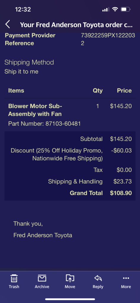

    I waited forever to take care of this. I've had my fan not even turn on multiple times and now that's its creeping into winter I can't keep putting this off. Just ordered with the Fred Anderson 25% off sale.
    $108.90 out the door.

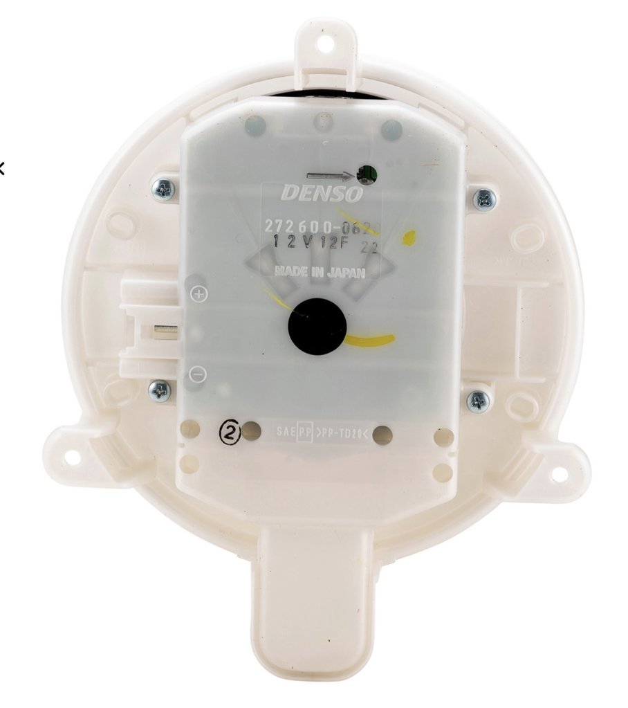

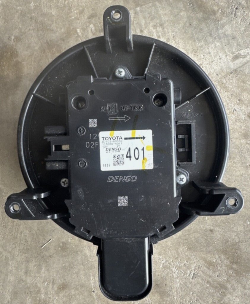

    Arizona
    2018 Crewmax 1794 4x4
    whats the difference between 87103-60560 and 87103-60481?
    i know there's an old part # 87103-60390 that was replaced by the 481 model. OP here used the 390 which is now 481

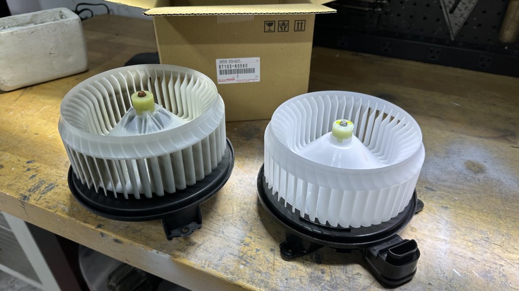

    We’ll need to open up both and compare to find the significant differences.
    Here is the 87103-60481
    87103-60560
