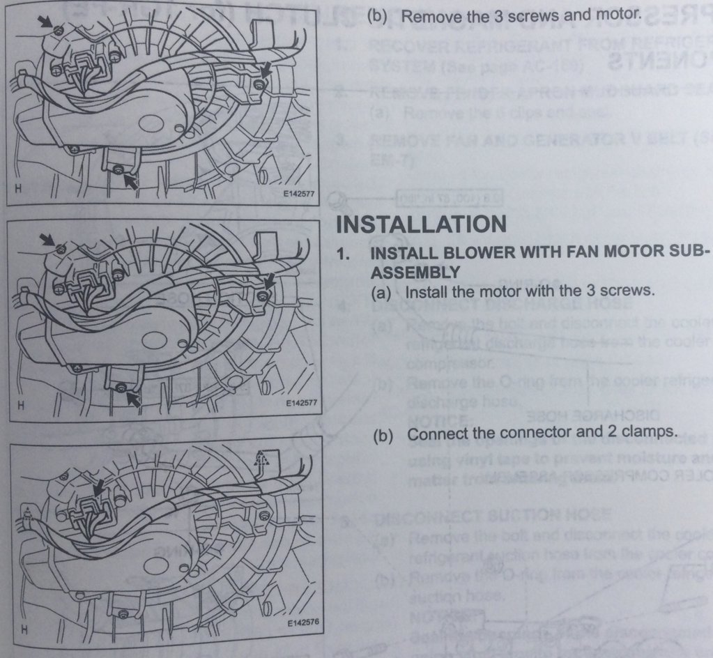

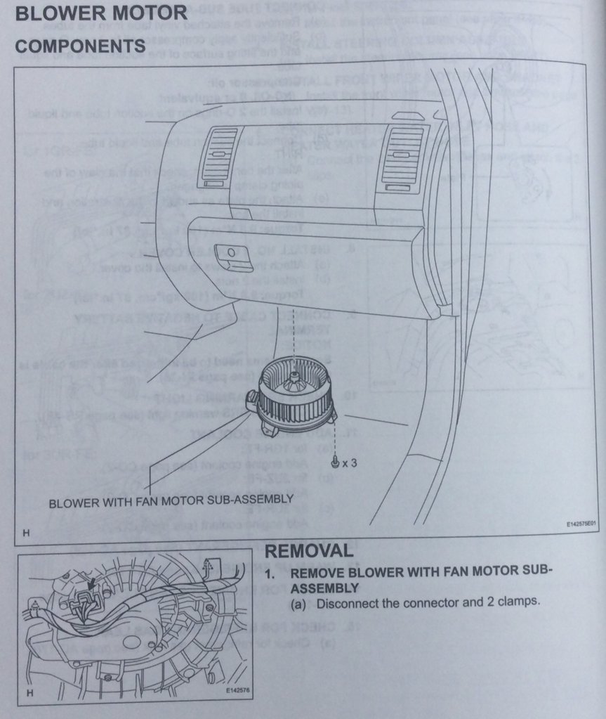

    Does anyone have pictures of said blower location and install?
    I read some installed it in 10-15 mins but am wondering where is it?

    Yes, very quick to R&R.

    Oh, that's where it is. Got it, right under the cabin air filter.
    So I guess this also begs the age-old debate, which way does the arrow on the filter face? Up or down?
