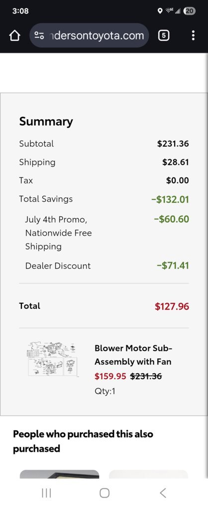

    Just Ordered from Fred Anderson Toyota, My two local Dealers were not willing to price match. This Site has a way to spend money on things I did not even know I needed:monocle:

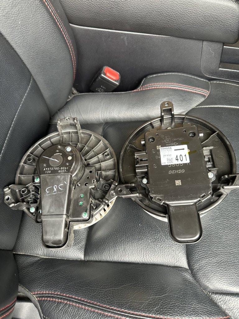

    Just finished installing mine. What a difference in winds lol. Happy with it!

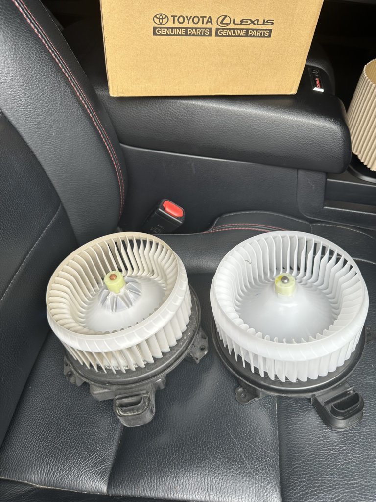

    got mine installed about two weeks ago, pretty happy with it. the first thing I noticed when I was installing it is, it is SO much lighter and you can barely hear it run, makes my 1794 a touch more luxurious. closer to a Lexus

    Ordered 87103-60481 through Fred Anderson Toyota in North Carolina. Ended up being the cheapest. $158 including shipping to Idaho.
    My local dealer was $298.
