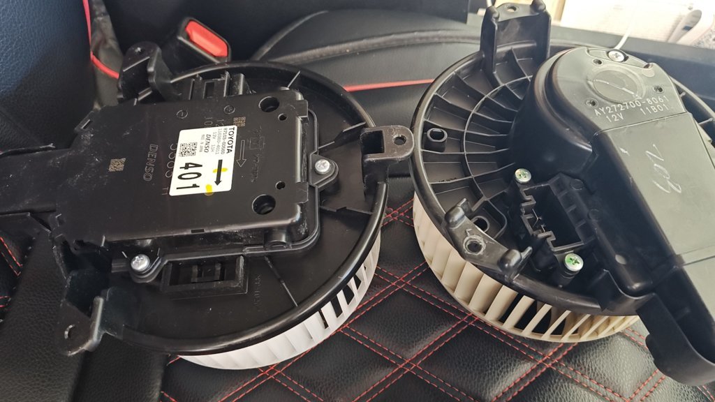

    Just installed my upgraded blower motor a few minutes ago. It really makes a huge difference! First off no more tapping or clicking sound from the motor and I noticed it moves way more air that my motor from 2020!

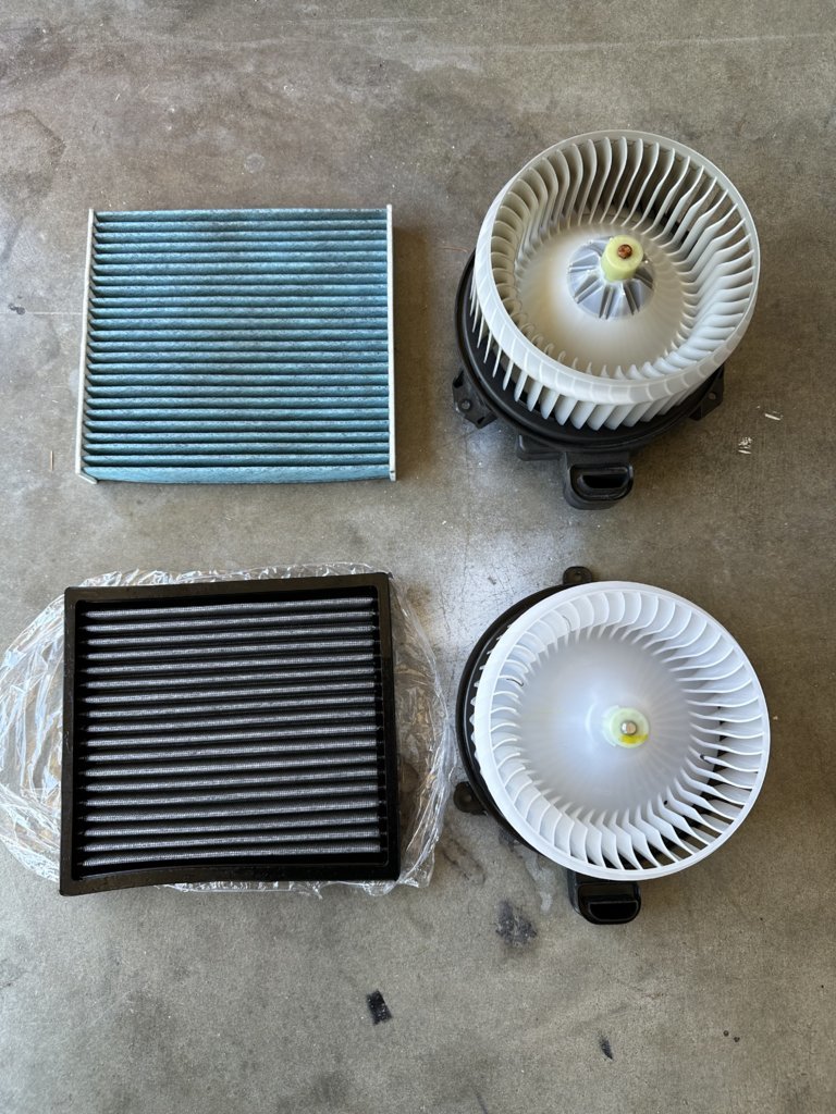

    I finally got around to I installing this.
    I gotta say.....this thing blows......hard! Lol
    The difference is much more than I thought it would be. I could hear (maybe) a slight electronic sound but nothing crazy. Very happy with the 20min upgrade.
