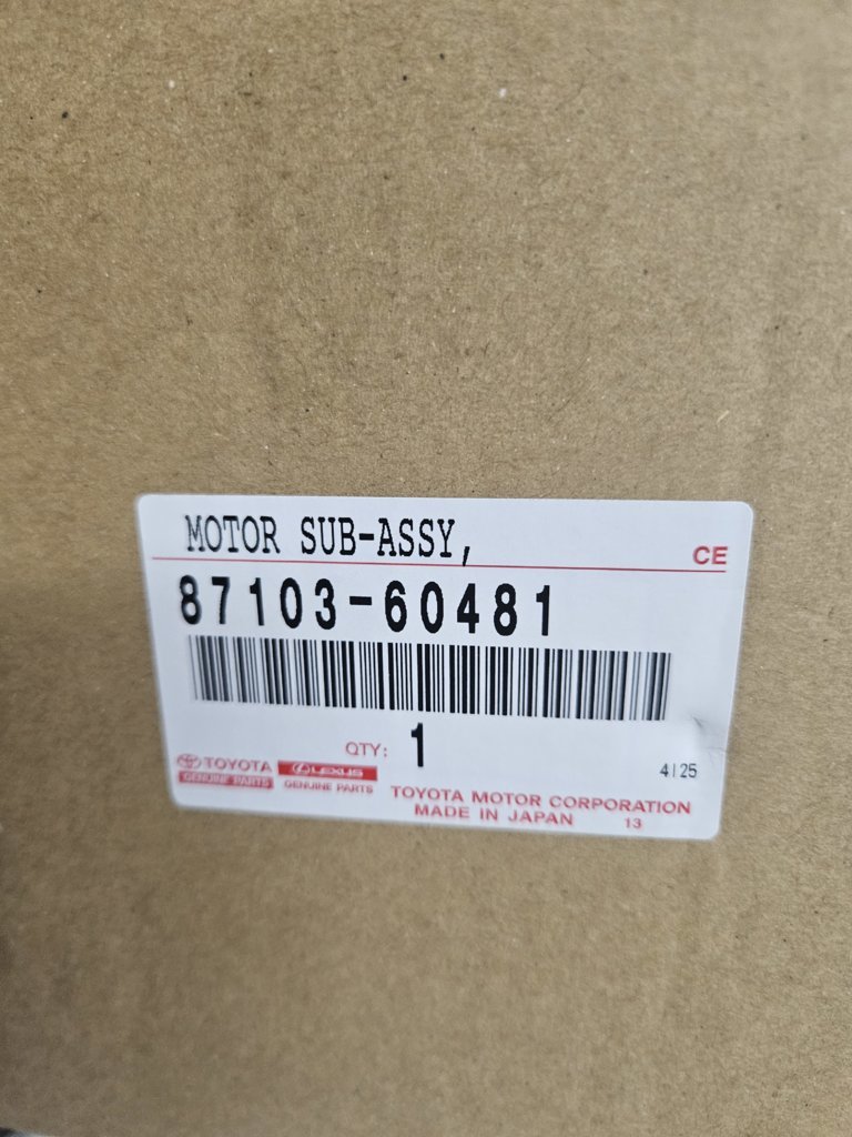

    Because I’m a degenerate with two Tundras, I figured why not be a guinea pig and order one of each part number to compare them side by side. I won’t go as far as dissecting them, but I can of course check some of the visual differences. Depending on how much time I have to expend, I may do stock vs. “old” LC vs. “new” LC airspeed installed in my 2010 CrewMax; that way I can also check if the rear blower airspeed is any different between them.
    I think I even have a new Continental blower motor laying around that I bought a few years ago from autozone, so maybe I’ll throw that one in and get a measurement too.

    I too am a double Tundra (2.0 and 2.5) and i too bought one of each. Have not had a chance to throw them in with winter but will soon.

    Awesome, glad I’m not the only one. When I saw a chit show all of the 3rd gen’s were having I decided it was now or never to get a clean low miles 2.5.
    Will be good to have two test results comparing the different blower motors.
