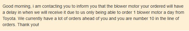

    Ordered. I guess I’m number 13.
    Good morning, i am contacting you to inform you that the blower motor your ordered will have a delay in when we will receive it due to us only being able to order 1 blower motor a day from Toyota. We currently have a lot of orders ahead of you and you are number 13 in the line of orders. Thank you!

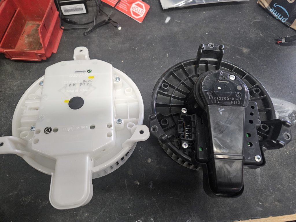

    I didn't need this but was caught in a moment of weakness. Since you guys constipated the system ordering all the 87103-60560, I saved a dollar and tried 87103-60481. We'll see what happens!

    The 87103-60481 should improve delivery time. It might even be a better unit as Toyota tends to cut costs every generation, but until we open both up, that is speculation.

    Shipped next day! I didn't even get a number in line! I was telling my automotive buddies and they all agreed that the newer part is probably equivalent, just from a lower cost supplier.

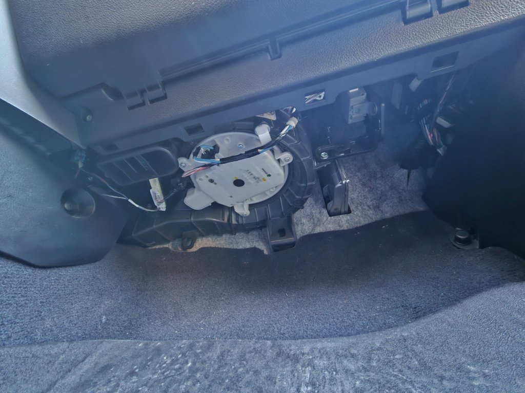

    Arrived already. Installed in 5 minutes. The plug is oriented differently but the harness easily reaches. Its slightly quieter at mid and high speeds, and has a "different" sound at low speeds. I don't notice a difference in airflow at first non-scientific test. I feel kinda duped, but also like I own a little bit more of a land cruiser. Thanks tundra forums!
