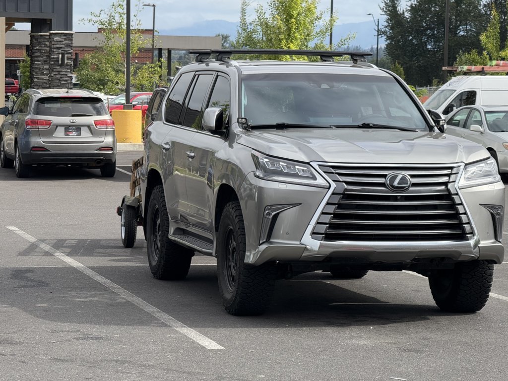

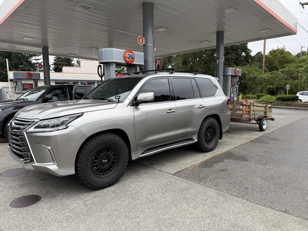

    I gave up Instagram so you guys have to follow along on this little adventure.
    here she is not in low mode.
    Plus, I got a little inspo at the tractor supply when I stopped for a bucket

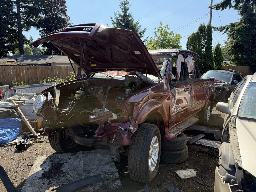

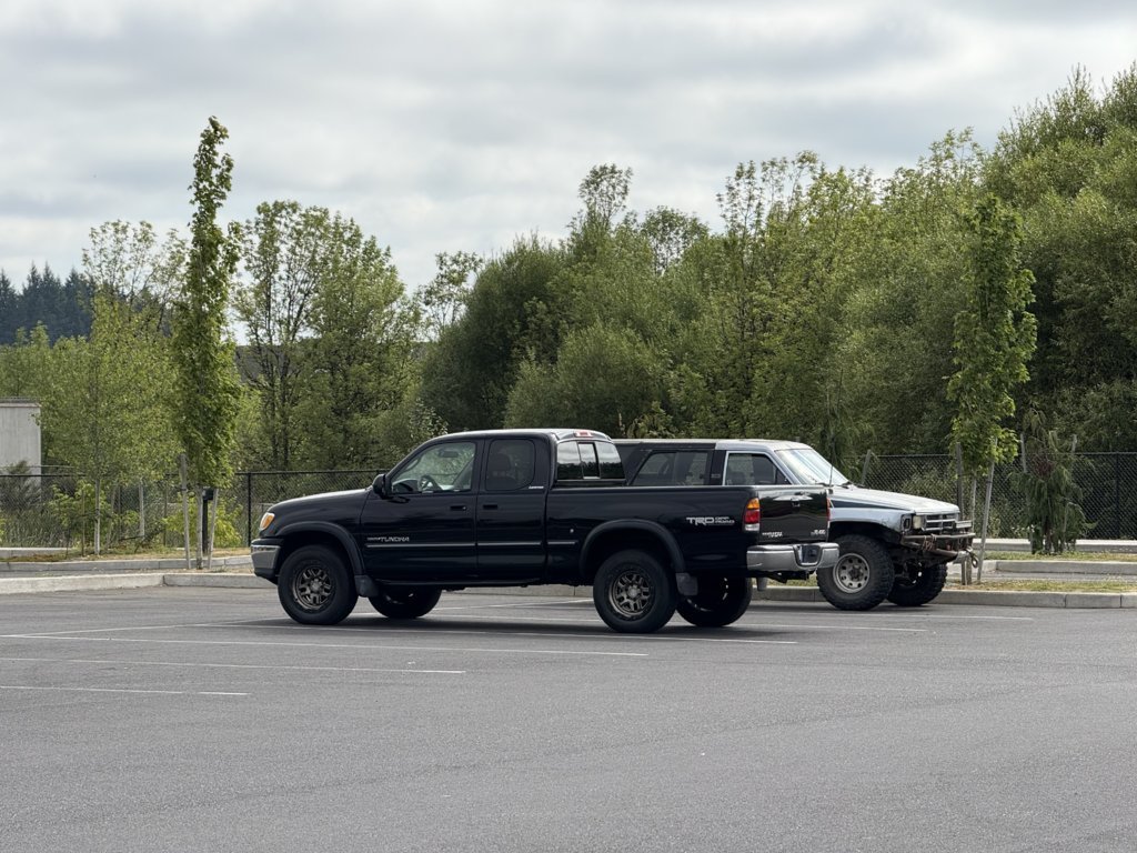

    Our patient

    Looks like it has one of the unicorn master cylinders. I'd snag that as a spare if the price is right.

    Ah damn too late. Happy with my haul though

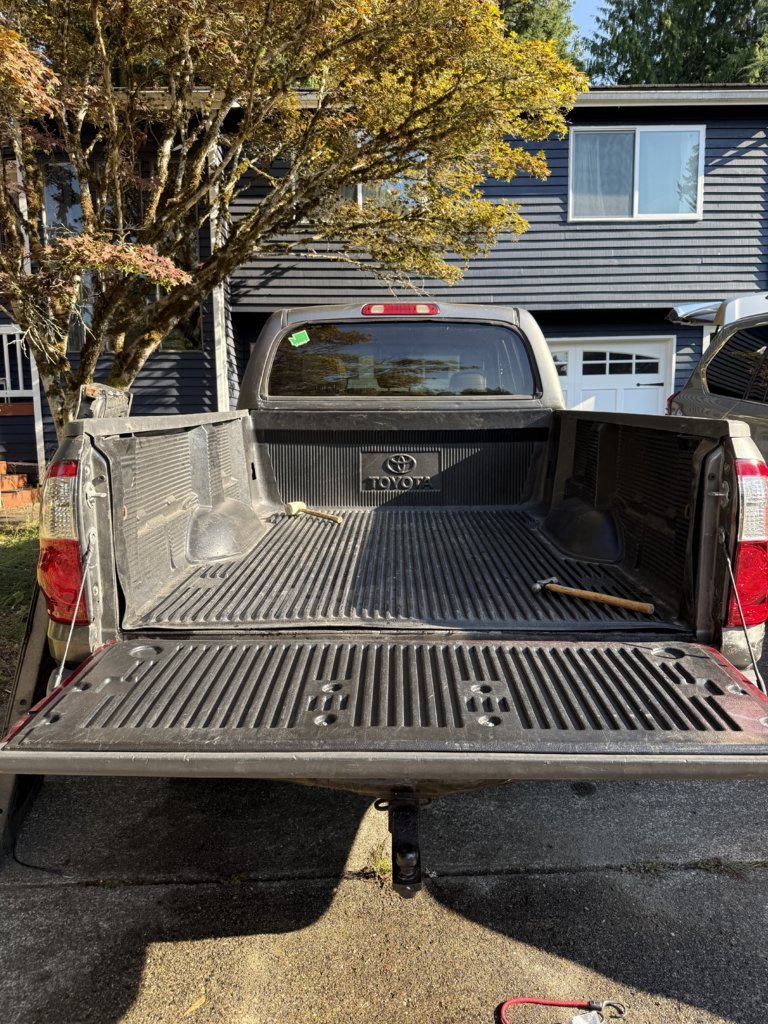

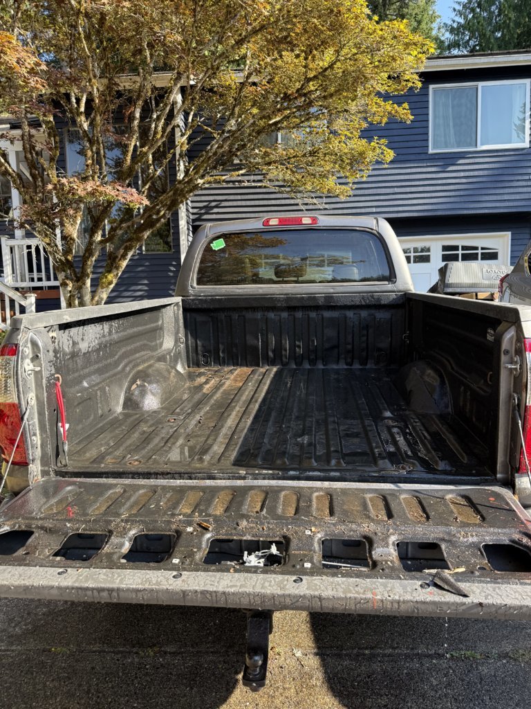

    Alright, my donor was much rustier than my truck which sucked but also made me feel better about mine. The bummer is most of the shit I wanted from the underside was basically junk and the hard line I needed was completely seized in the connectors on both ends.

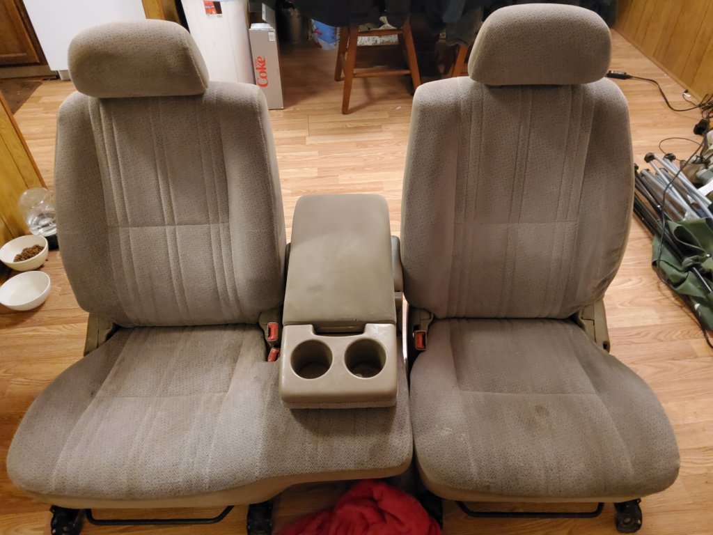

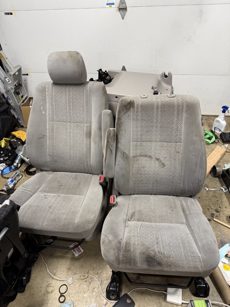

    I came away with a full set of minty manual cloth seats so I can toss my obliterated leather seats. Unfortunately the mouth breathers at the yard threw an oil soaked crossmember into the immaculate interior so hopefully I can get the oil out.
    I also got a bedliner to go with my new tailgate. I was able to add another color to ol’ Methanie.
    Before
    After

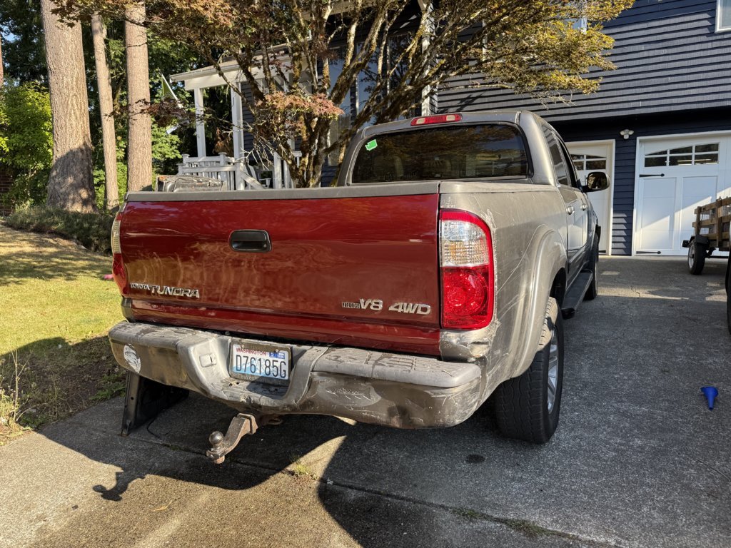

    Ass like a baboon (that receiver hitch is rusted in there which is why I needed another one)

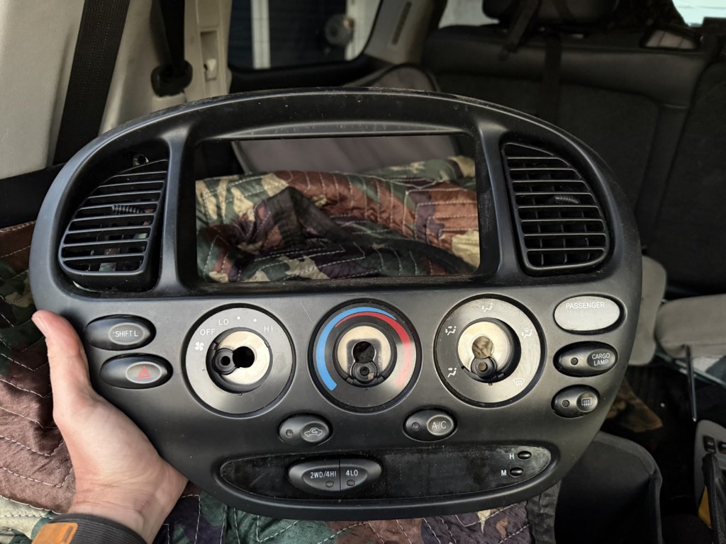

    I got a full set of not-fake-wood trim pieces and door buttons.

    A drill brush and an extractor will clean that seat right up.
    That spot on the pass seat is oil. Came right out with hot water in the extractor.

    Just know the HVAC controls aren't universally compatible, even within the same years and cab types, so test your A/C immediately after swapping out, and know someone here may want the woodgrain stuff, it's sought after.

    Awesome, thanks. I have two little kids so a hardcore carpet cleaner was something we invested in a while ago. It’s been doing work on this truck. If that doesn’t cut it, I’ll bring out the big guns.

    Rad, I can swap my hvac unit into the new piece, correct? And thanks for the heads up on the wood stuff I was going to toss it.

    Right, that should be possible. Test for function first with the part you have, look at it for obvious differences. If all looks same, plop it in, snap the center dash on the truck without screwing it in, test it. If good, finish securing it and reward yourself with a cold one.

    Its the passengers airbag thing i believe.
    I have a double cab limited, it came with the wood grain. I bought all the black stuff from an SR5 Sequoia (unknown year) but it had the same style dash as mine. I just swapped everything, all the plugs clock and all, and the passengers airbag thing was lit up, and the airbag and ABS lights were lit up on the dash.
    I had to disassemble the dash piece and swap the airbag plug and lock mechanism from my Tundra wood grain dash and swap over to the sr5 black dash.

    Interesting. This is from an 05 DC and mines an 06. We’ll see I guess. Hopefully that doesn’t affect the new seats I’m really excited about too

    pretty sure, on paper, those are the same

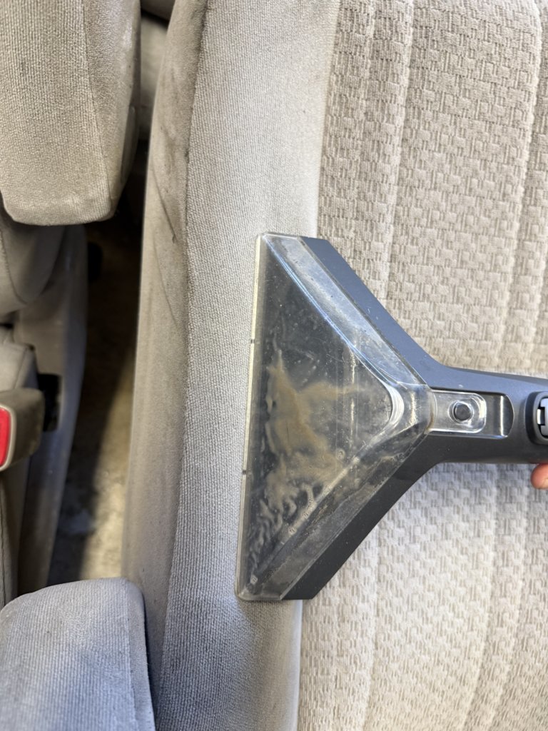

    Sucking the poison out

    I thought you had to incinerate meth infused furniture to get the smell out?
