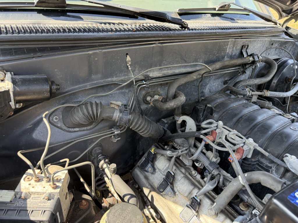

    Ok so one thing that’s holding me up is I want to make sure there’s nothing leaking from the back of the engine, but there’s so much oil all over everything it’s hard to get a good eye on it. The steering rack bushings were a colossal pain in the ass, I kept dropping tools on my face because there was so much oil everywhere. Anyway, how common are rear main seal leaks and such? I don’t want to pull this bad boy apart and then need to do it again because I missed something. I spray everything down with simple green and power wash it, but I can’t do it with the engine running since it just makes it worse. I don’t need to worry about anything below the valve covers getting wet as long as I’m using a 40 degree nozzle, right?
  7. Jun 2, 2025 at 12:54 PM
    #37
    bmf4069
    Sep 1, 2018
    #18880
    9,764
    Beau
    TX
    02 AC sr5 4wd v8
    Rear main seal failures aren't common at all. You said your valve covers were leaking? If bet dollars to pesos that's your problem.
    Nimitz_[QUOTED][OP] likes this.

    I mean it’s PISSING oil while it’s running. Valve covers are first on the list and I’ll see where that gets me, but for some reason it seems like way too much for just that, but I’m new to any kind of issues like this.
  9. Jun 2, 2025 at 1:03 PM
    #39
    bmf4069
    Sep 1, 2018
    #18880
    9,764
    Beau
    TX
    02 AC sr5 4wd v8
    Clean up the back of the heads and block as best you can. That'll get you pointed in the right direction.

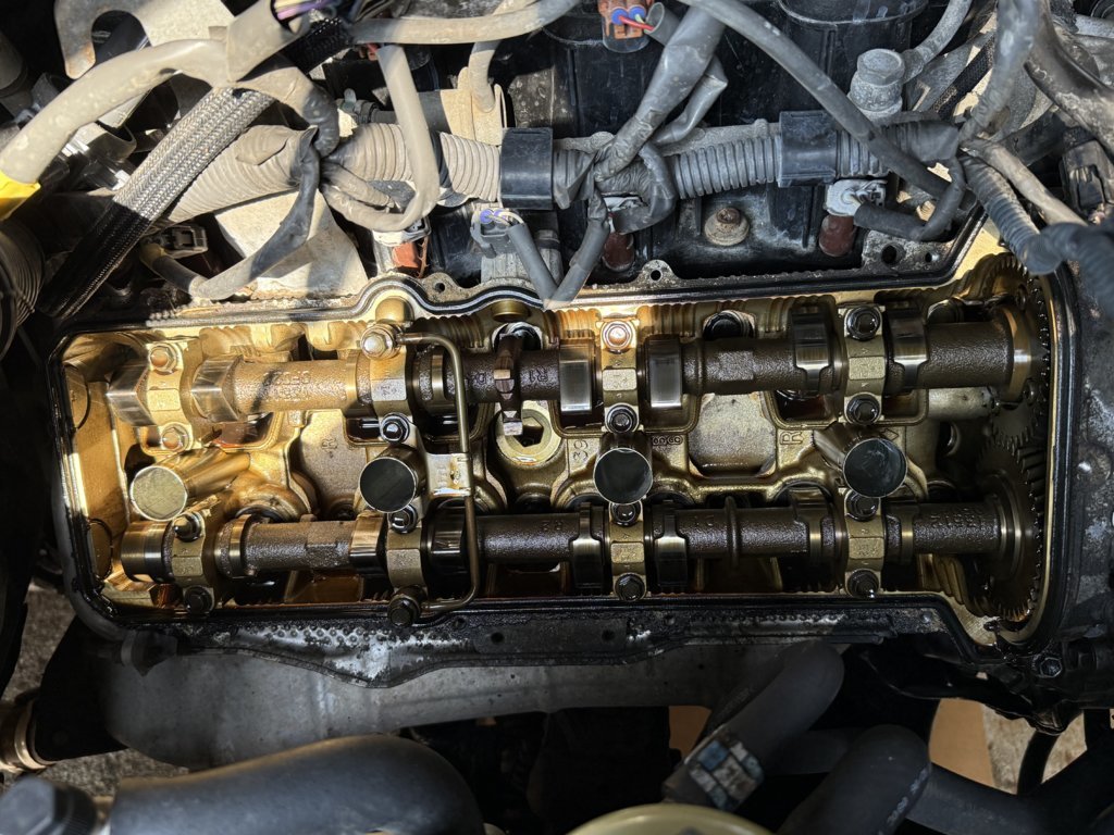

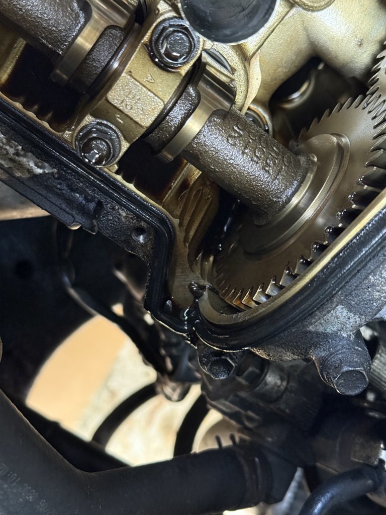

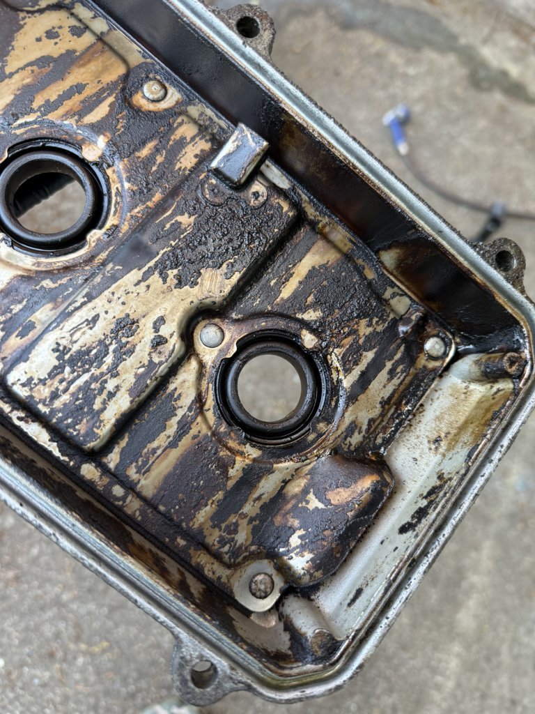

    Alright halfway through the first half. Are these fel pro gaskets decent or should I hit the dealership on the way to work tomorrow?
    Looks like the bottom front corner is our culprit, but like everyone else some of the bolts were less than finger tight.
    FirstGenVol, Bmktw2 and G_unit3000 like this.
  11. Jun 2, 2025 at 6:07 PM
    #41
    shifty`
    shifty` Countin' and breathin', disappearin' in the fade
    Jun 20, 2020
    #48239
    30,201
    ATL
    '06 AC Limited V8/4WD
    FelPro is about the only other company I'd trust.
    Yeah, leaking from corners, be sure to hit all surfaces with Brakleen after you clean out the old sealant, to remove any oil residues, before FIPG.
    Someone else has potentially been in there before, the half-moons at the back of the head look like someone have a wrench on them (normal).
    You have FIPG already, and plan to do the half-moons, right?
    Be sure to check for random little bits of FIPG down in the head before you put the cover back on (and probably before FIPG).
    Having a larger sized socket makes it easier to drive in the spark plug tube seals, be sure to install the correct way, the inner ring's ridge I believe faces toward you (will be pointing down in toward the engine).
    You went with the easy side first, I see :rofl:

    Yep have FIPG in hand and am planning on doing the half moons. Just got it all cleaned out and ready to install but will save that for another day.
    I just did the side the guy on YouTube did first, I didn’t even know there was an easy side. I’m very comfortable working on cars so I’m not too worried about it, you guys just have a granular knowledge about these things I’ve never seen before so I’m asking a billion questions.

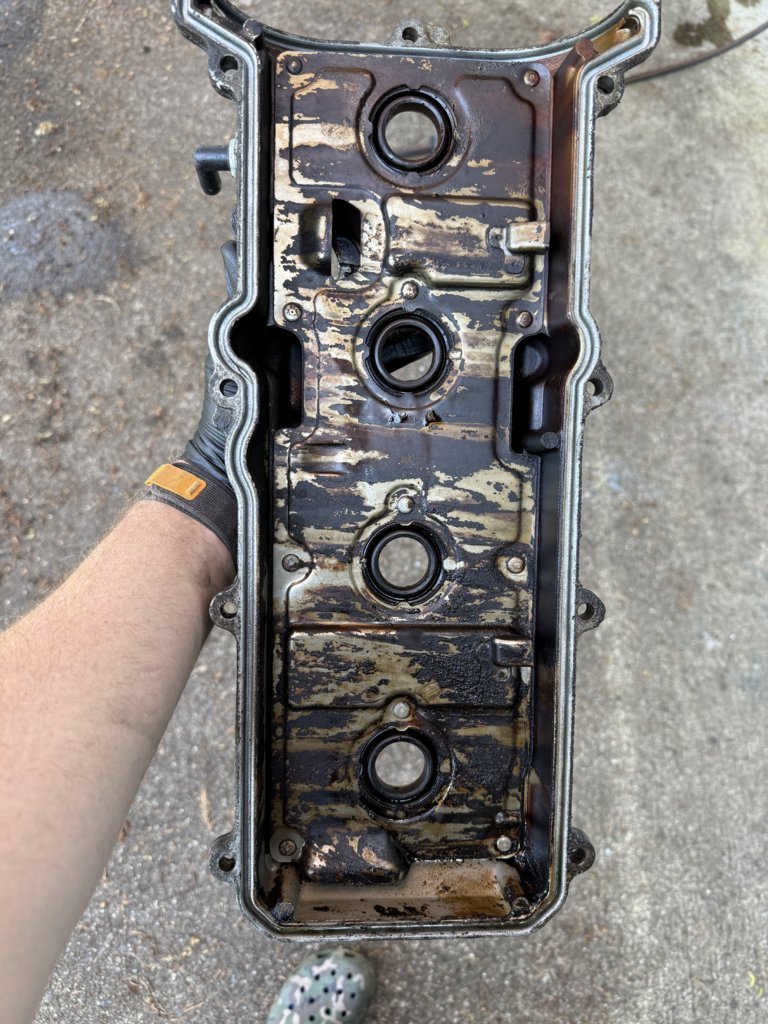

    Alright I finally got more time to work on this. The easy half is back together and the driver side is pulled apart. Lots of wet oil on the mating surface of the old gasket and tons of caked dirt and oil all over the top and back of the block. Also a concerning amount of gunk on the bottom of the cover. Feels like dirt. I’m guessing I need to do a few back to back oil changes with some seafoam or something.
  16. Jun 6, 2025 at 3:36 PM
    #46
    shifty`
    Jun 20, 2020
    #48239
    30,201
    ATL
    Back half of the driver head/bank1 is always caked and dark. Inherent to the design for some reason. And for the cake inside cover, scraper and Brakleen worked great for me.

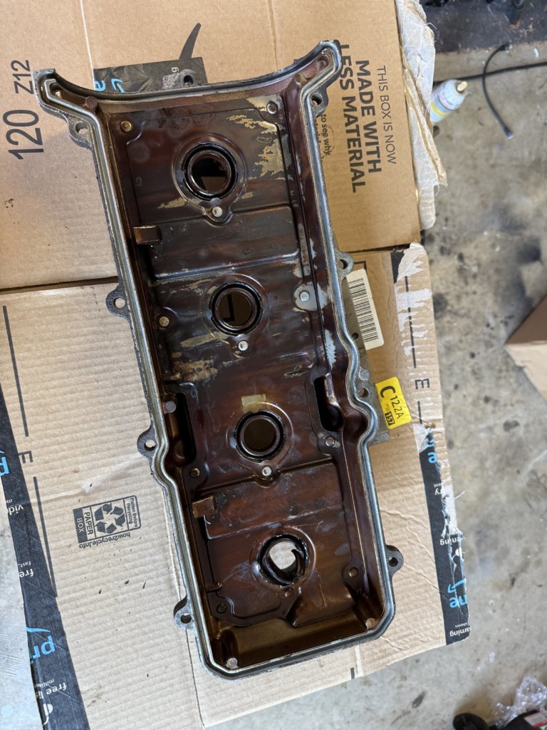

    Oh sorry I meant to ask, is that normal inside the cover? I was freaking out thinking there was a ton of grit in the block. I just changed the oil and it was DARK but there was no clumps or glitter in it.
    G_unit3000 likes this.
  22. Jun 6, 2025 at 6:18 PM
    #52
    shifty`
    Jun 20, 2020
    #48239
    30,201
    ATL
    Dude. The inside of my covers, at 70k original miles, looked like someone poured maple syrup in them, let it dry 3-4mm thick, then took a torch and blasted it until it was black and flaky. There are pics in the megathread, I believe.
    Yours are mild in comparison.
