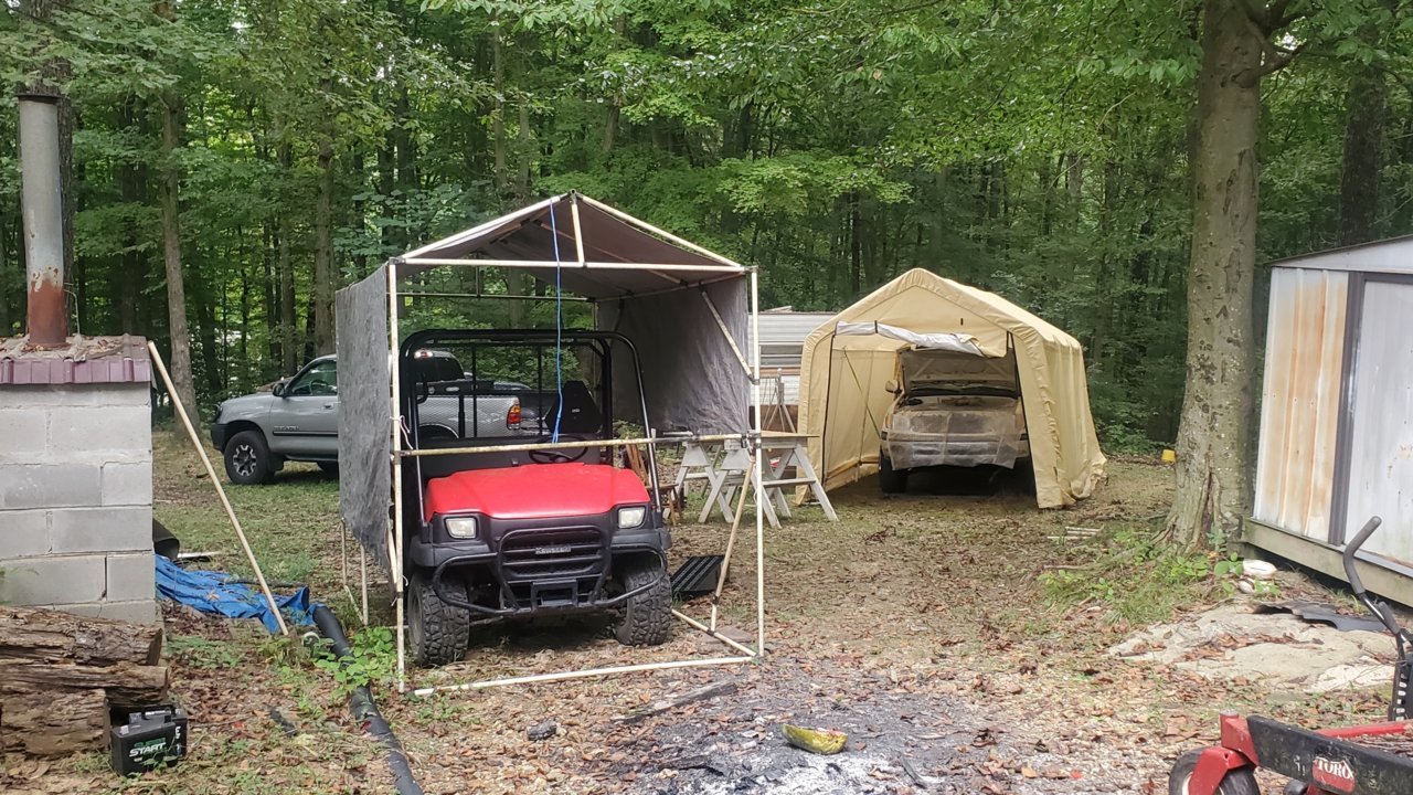

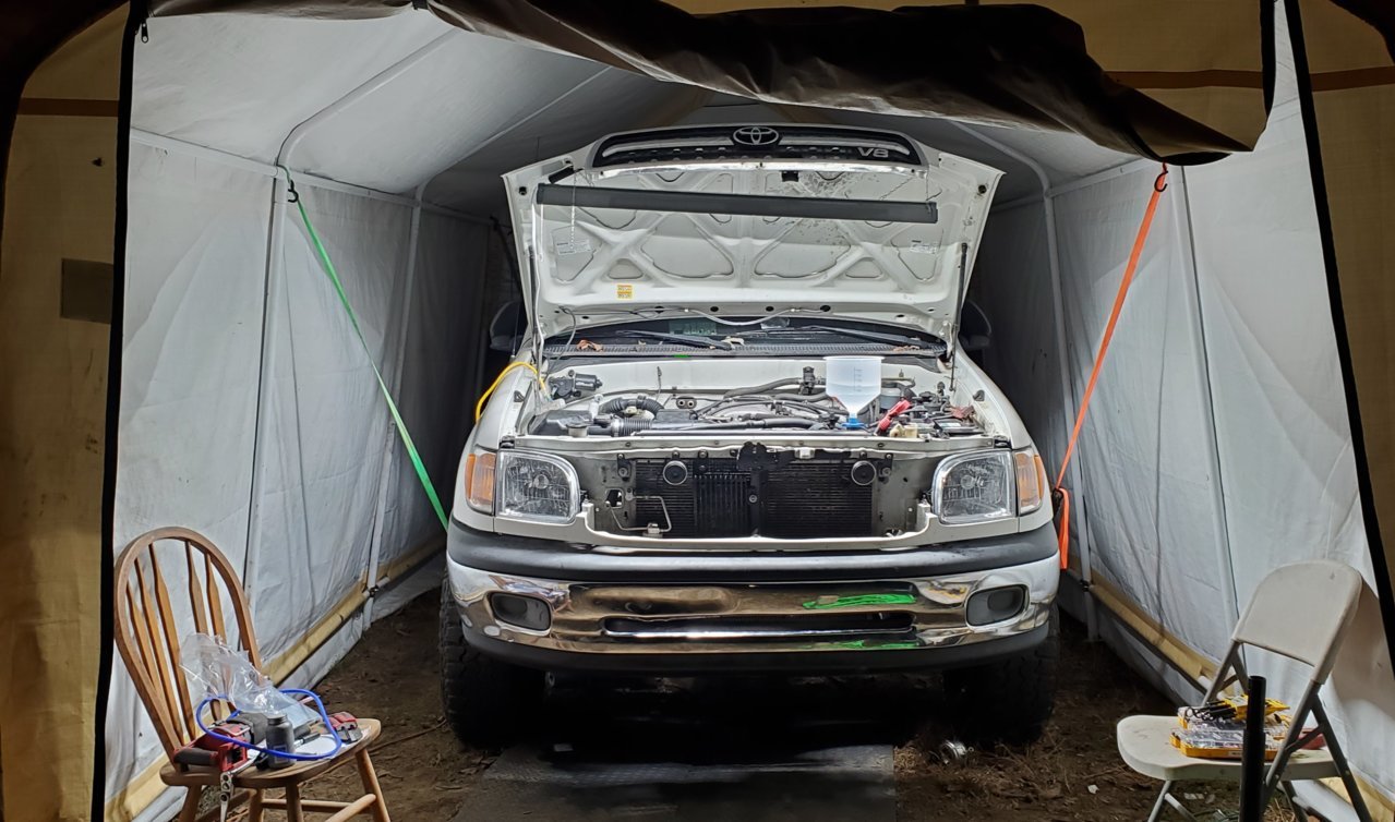

    There’s always a ‘gulp’ tent of pain, er I mean shame, or is it fame???

    @Tundra2 called it the tent of pain, I called it the tent of shame, but only cause I heard there was half-naked kentuckians in there. Sounds like OP would be working Bmf style, aka the driveway of despair.

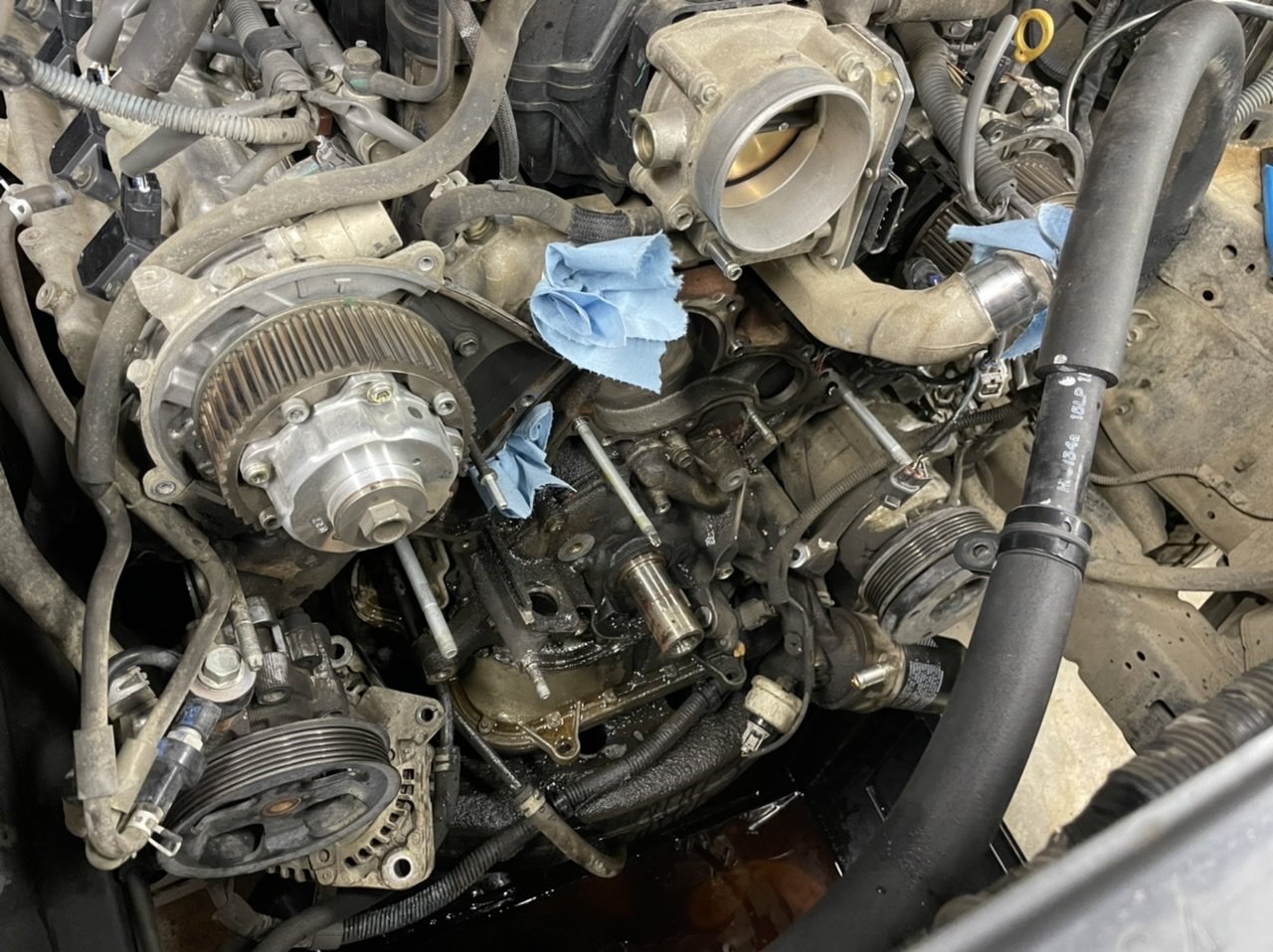

    I don’t have my first gen anymore but I did all of my timing belt changes. I did them at around 95,000 miles and timed them for good weather and no schedule pressure. I did a total of five belt, pulley, water pump, hose and tensioner changes.
    The first one I did took 12 hours because I didn’t have everything I needed and I was not familiar with the process. The last one I did took six hours and two Dr Peppers. The service became an opportunity to me. Swapping out all of the parts and fluids at that interval kept my truck reliable. In the 500,000 miles I drove my truck it only left me stranded twice and both of those were my fault.
    The 4.7 engine is a trusty work horse if properly maintained.
    Watch the several videos on it, buy Toyota parts (there is a difference that benefits you), do the water pump, use a new tensioner (easier reassembly), change stiff hoses and label everything and where it goes. It’s just a process.
    As my dad used to say, if man built it, man can maintain, service and fix it.

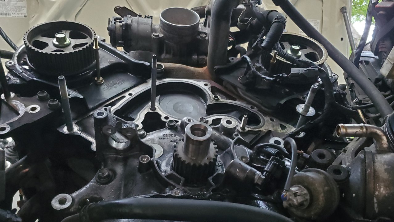

    It’s not too bad, turn the cams to the “T” that’s the neutral position so the cams won’t roll. Line up the dots on the belt to the gears, and the rest is pretty much just normal mechanical stuff.
    I used baggies to keep all the hardware organized.

    @Diablo169 That second picture makes me miss my 1st gen. That is the point where the first Dr Pepper break happened.

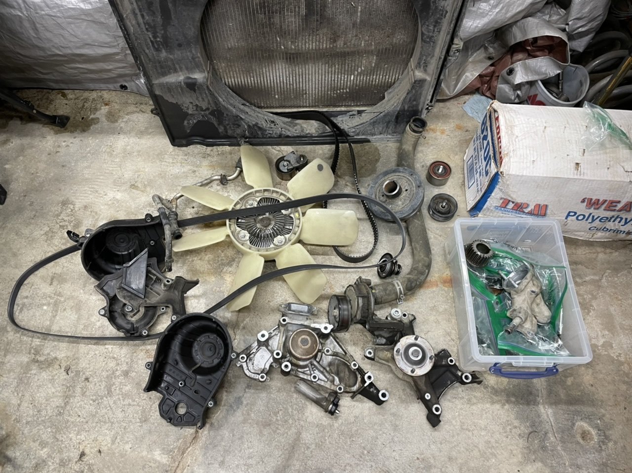

    I allowed 3 days to change my timing belt. I took my time, spread out the parts in the order I removed them, and took regular breaks to consult with the videos. The ground wire on top of the AC compressor gave me the same problems, but otherwise nothing to write home about. I was done by noon of the 2nd day, so 10 - 12 hrs overall. I saved ~$900, so my time is worth $75 - $90/hr...not bad!
