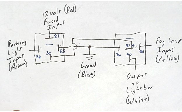

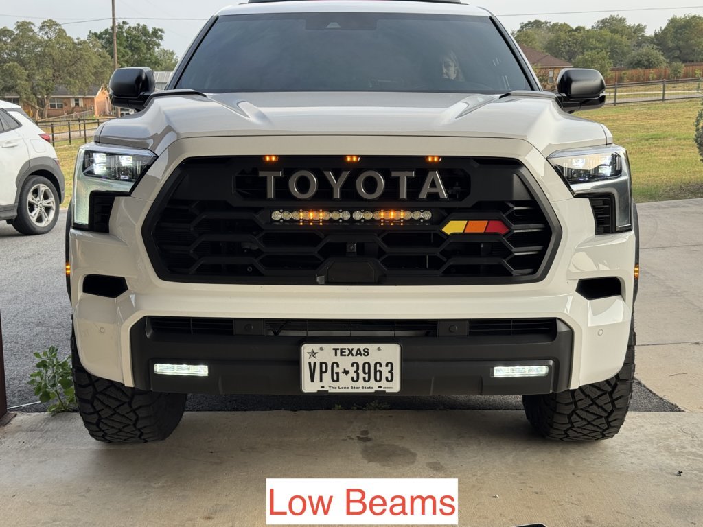

    I appreciated your input on not interrupting the signal to the fog lights and I would have had to interrupt both.
    I was able to do it with just a signal from one of the fog lights by incorporating the light bar relay into the plan. (see post above).
    And yes, I would never use parking / taillights as a power source for the light bar. The original diagram that I posted literally said "To Light Bar Relay #86". I thought it was obvious that relay would have it's own proper power source. Suppose I should have specified that.
    In the end, I tapped the positive wire to the fogs and the parking light feed at the tailight. No too invasive considering I was willing to tap the high beam signal if there was one. I think people are tapping into the taillight for the lighted rear fender flares so same same.

    Next level would be a switch on the dashboard to interrupt power to the lightbar. (I would use another relay)
    This would allow normal headlight functions while having the lightbar off.
    I could easily add the switch but I like the fact that I didn't have to go thru the firewall or under the dash to this point.
    So yes, code officially cracked, light bar function with high beams ... without a $120 Canbus reader.
    Really no downside to this method if you use a switch.

    That's the advantage to adding a switch (which usually comes with the light bar anyway). You can run headlights without fogs and without the light bar by cutting power to the light bar with the switch.
    So no drawback function wise
    As far as the cost, does the cambus reader eliminate the need for a waterproof relay with waterproof connectors? Fused terminal block? No other wiring, loom, ties, connectors needed?
    I can list the components that I used that didn't come with the light bar and it literally would be about $20-$30. Although the components may not be up to your standards if you're spending $35 on a relay and adding a fused terminal block for whatever reason.
    I won't go so far as to say the cambus reader is a waste of money. It definitely makes the job faster/ easier ... but there is another way if someone wanted an option.

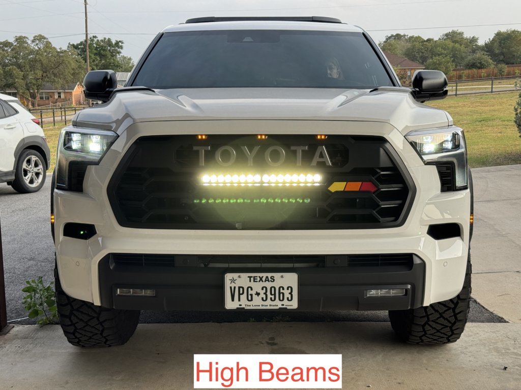

    Most (perhaps) ppl in this thread as interested in "light bar ON when high beams ON" solution, but as I exemplified before, the multiple output CANM8 device is awesome for anyone (me, for example) that wants to use other "triggers" from the truck's lighting system for additional functionality.
    Instead of running multiple "double relay" solutions (or who knows what other ways to get a trigger), I love the fact that a single small box can simply read the truck commands and give me "high beams ON, low beams ON, parking lights ON, etc" outputs.
    Through 1 easy solution I have long range light bar on with high beams, aux/amber fogs with low beams ON, and could have used other outputs for a myriad of applications.

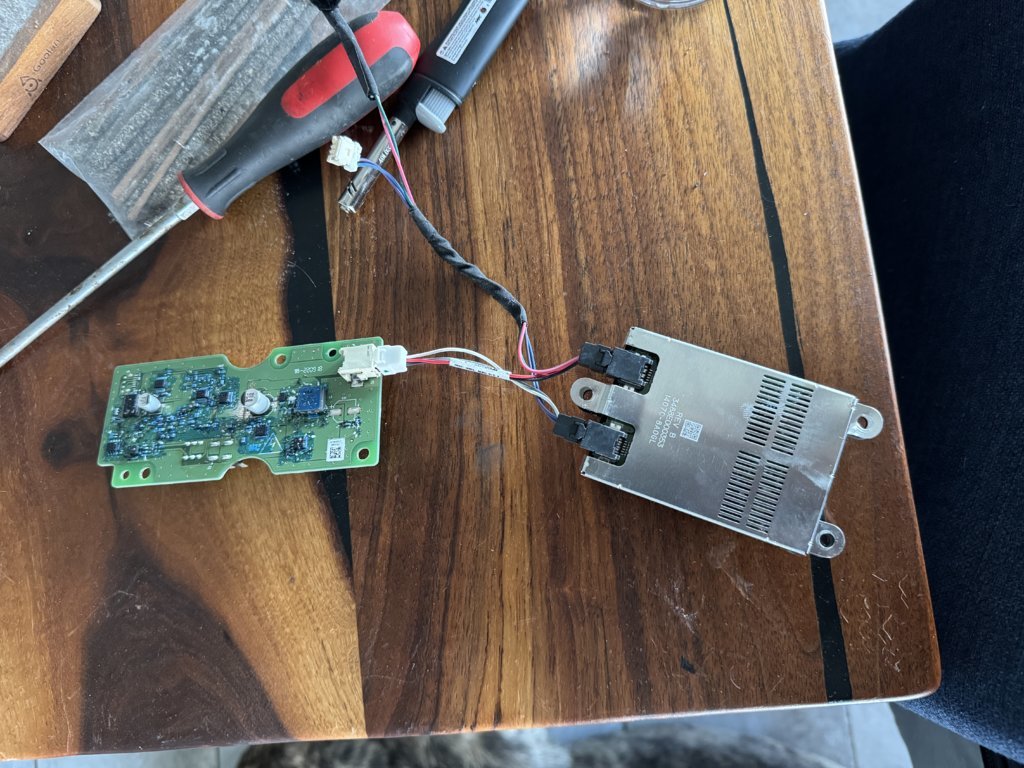

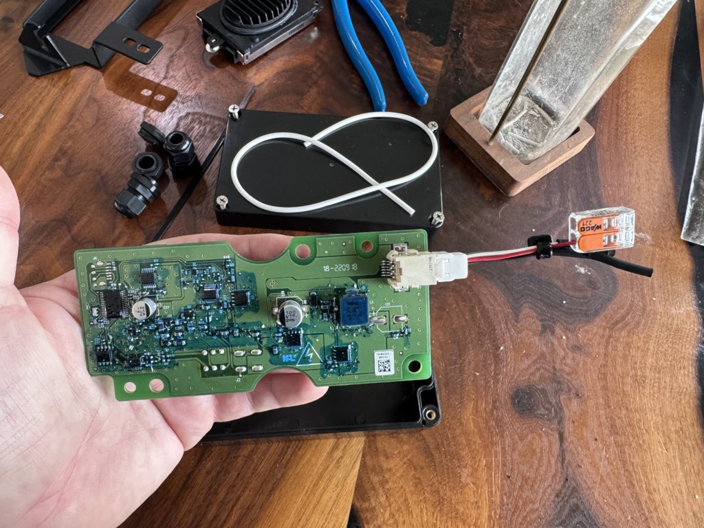

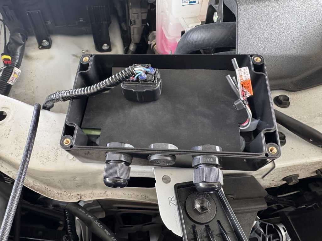

    Hooked up a Deutch connector for integration, haven't had a chance to install yet though.
    I have an sPOD BantamX, so I wanted to take advantage of the triggers.

    I like pro-level wiring jobs; boys @ the dealership always appreciate "professional" wiring and never give me any hard time about all of my aftermarket wiring/accessories.

    I'm a controls engineer, so I have to somewhat make it look good and function correctly.
    I can't stand some of the way stuff is slapped together.

    Are you planning to pick up your connection behind the glove box or somewhere else? I've got my reader I just haven't hooked it up yet.

    Behind the glove box, I've had my dash apart so many times already. It's not a big deal anymore.

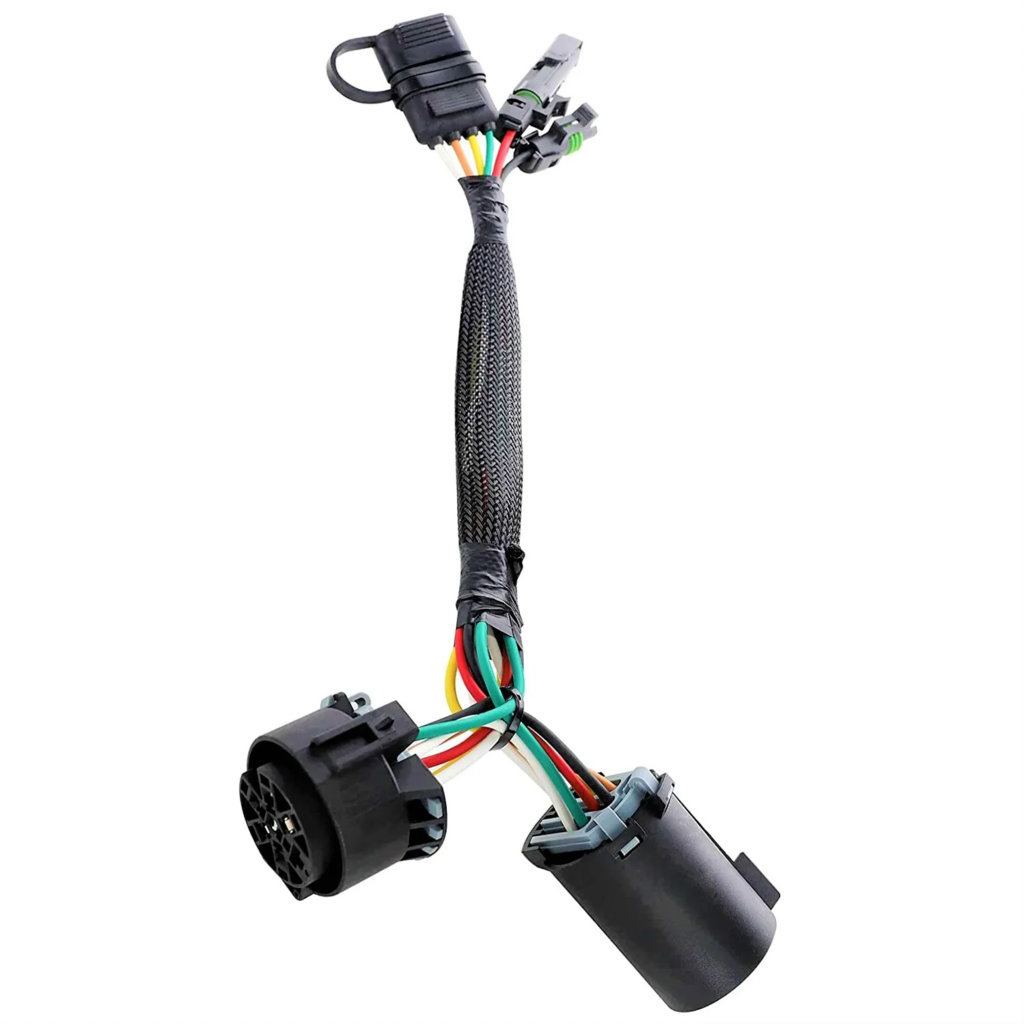

    Best way is to get a 7pin to 4 pin and make your own harness. Super simple. What I did and they act as oem

    Good idea ... so long as it doesn't cause the truck to think there is a trailer plugged in.
    Sometimes that will affect the function of the backup sensors.
    I've used these adaptors before to provide a hidden plug and play connection to the trailer wiring; Putco #529004
    With this adaptor you would tie into the brown wire for marker lights.

    It doesn’t. I have it. Along with a vled plate and hitch pod and diodes reverse kit. It know when a trailer is connected and not. Never have it thinking there is one when there isn’t.
