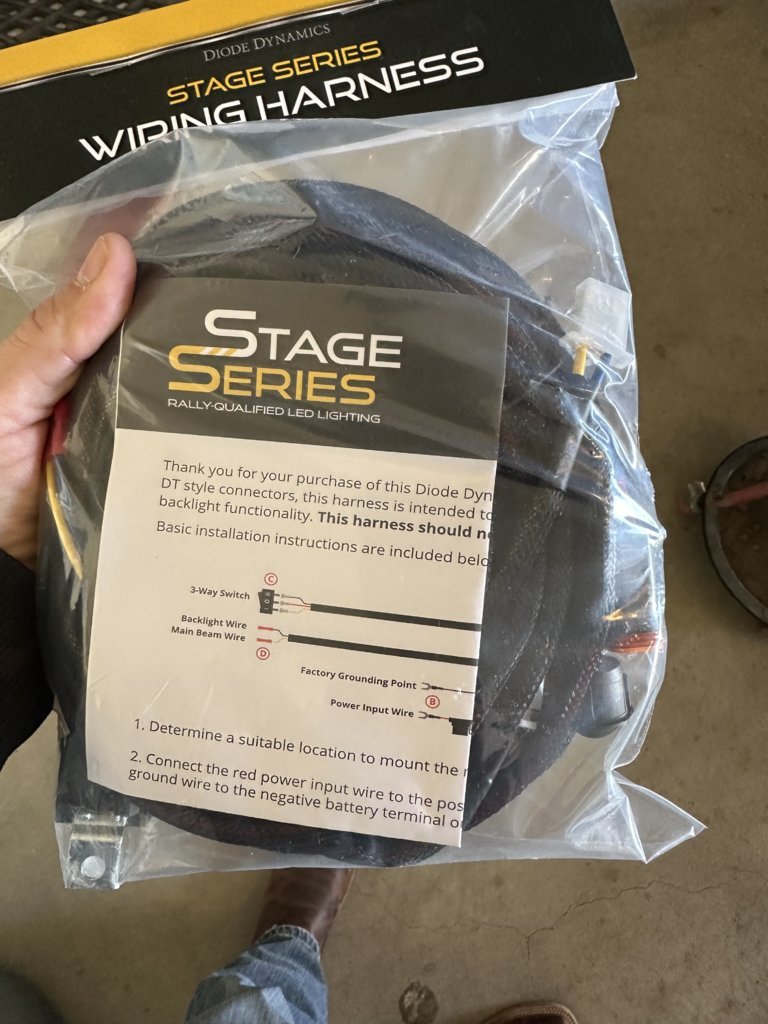

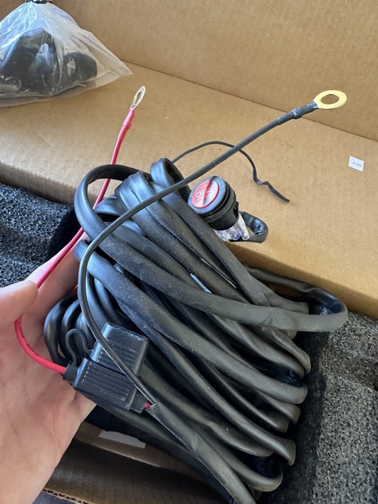

    well for the brights I want to plug these two 10” light bars from Baja Designs
    And fogs I want to do these pods from Diode Dynamics.
    Including some pics of the harnesses also. They all have 3 way switches but I don’t think I want those.
    Basically what I’m asking is can I run the CANM8 for my light bars while keeping my fogs normal functionality (switching off when high beams are on)? Or do I need the IDR8?

    Pretend you don't have OEM fog lights.
    CANM8 will only trigger your light bar(s) when you activate your high beams (using the high beam trigger on CANM8).
    Fog lights will operate as they normally would (high beams on = fog lights off), unless you change their wiring/trigger inputs.

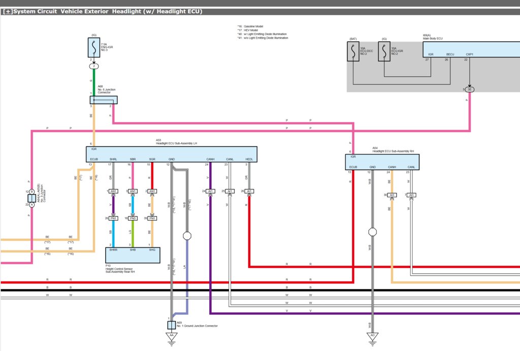

    How did you determine which wires to connect the device to at the headlight? How did you figure out which wires signal High Beam?
    Why is it connected to 2 wires? Pink and White? Same connector but my headlight harness wire colors are different.
    Is it in the instructions for the device? Are the instructions vehicle specific?
  8. Mar 24, 2025 at 1:41 PM
    #68
    beer30
    beer30 New Member
    Oct 17, 2024
    #124365
    105
    You're looking for CANH and CANL

    Reminder that you don't have to "plug into" CAN signal wires at the headlight. You can pick up the same wires/signal right at the ECU, inside the truck.
    I was in "experimental" stage with all this when I did it, and I was doing a whole lot of wiring (regardless) at the time, so it was easier for me to simply do this at the headlamp plug, instead of searching out the right wires by ECU.
    No wrong way to go about it, as long as the CAN signal is strong enough for this /any device to pick up.
    Note:
    The ODBII port inside the cab is not going to work, in case you're wondering...

    I have verified the CANL/CANH at the OBDII does not work. Tapped near the ECU, works perfect.

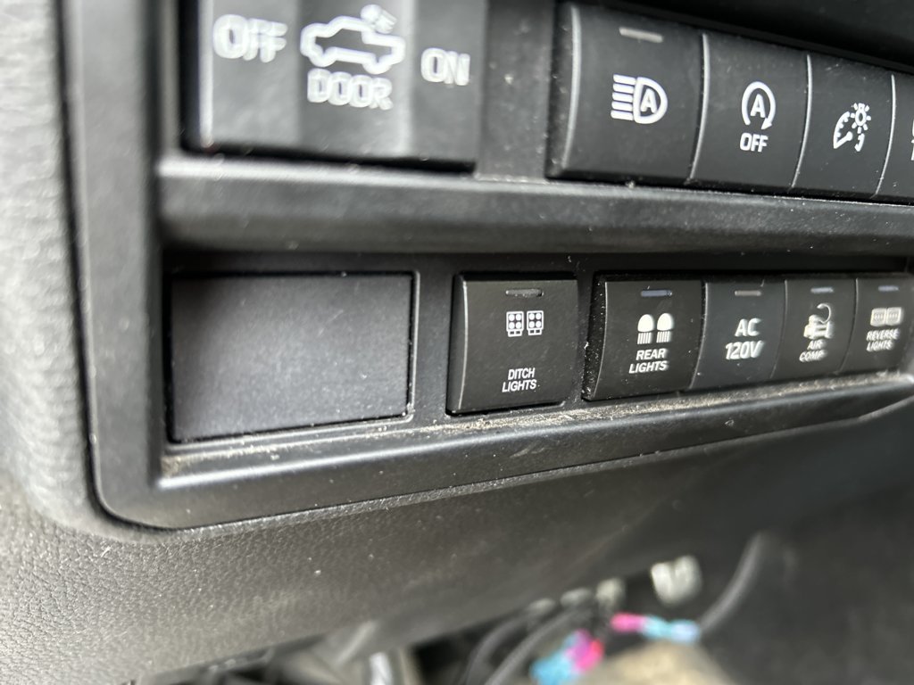

    I found it pretty easy to wire up mine and now it triggers both my diode light bar in my grill as well as two Strands Lighting Division rounds. It works each and every time without a single issue ever since I installed it. It shipped pretty quick as I recall.
    My fogs are wired to the existing OEM fog switch and I added a square switch for my ditch lights.

    I ordered some of these square replacement buttons/switches
    did you wire tap for illumination or hard wire? According to the YouTube comments this guy tapped the wrong wire
    https://www.youtube.com/watch?v=P3YOAMF9NsA
    Any advice for that part?

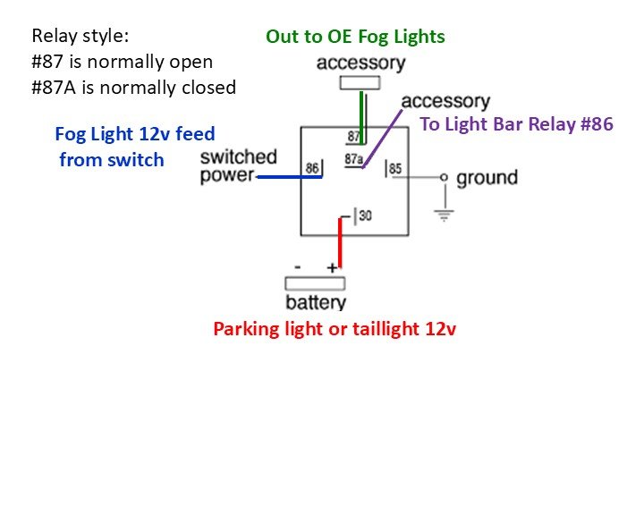

    If someone didn't want to spend $120 to buy the contactless CANM8 system, could a person tie into the fog lights and have the light bar come on when the OE fogs are off?
    (assuming the OE fogs have a 12v feed and not CAN bus)
    Using a standard $6 relay with #87 normally open ... and #87a normally closed
    #30 - Feed would be parking light / tail light so either fogs or light bar would only work if parking lights are on
    In theory;
    - the Aux LED lightbar would work anytime the parking lights are on and fog lights are off
    - the Aux LED lightbar would be OFF anytime the parking lights are off
    - the Aux LED lightbar would be OFF anytime the OE Fog lights were on
    - the Aux LED lightbar would automatically turn on with high beam as the OE fogs turn off (and turn off with low beam if fogs are on)
    - Could actually use the lightbar with low beam by turning off the fog lights

    While what you're describing is doable, I have one problem with your design: use of "parking light or tail light 12v" for power source on the relay.
    The reason to use a 20/30A relay is to provide a steady/proper/direct power source to the accessory. The way you have it drawn out is not much different from not having a relay at all. Imagine you're tapping into you parking light circuit to provide 12V to that AUX light bar.
    I certainly wouldn't want a high powered accessory to run directly off a tap on parking/etc circuit.

    I suspect the approach would be the relay described is the logic that will switch a second relay for the power. Personally, I'd shy away for disrupting vehicle wiring, no need to introduce additional fail points. CANM8 is the simple solution.

    Yes, this relay would be the "switch" signal for the relay that feeds the aux light bar ... which would get power directly from the battery.
    I agree that it's convoluted but seems doable.

    The code is cracked for "Light Bar to High Beam" ... (without the $120 canbus reader). Total cost was about $20.
    2 standard relays, wire, loom, connectors, wire ties.
    Installed, tested, and it is working as it should.
    The light bar will always come on with parking light, low beam, or high beam ... until the fog lights are turned on.
    So if you leave your fog lights on, the light bar will be off with low beam ... and turn on with high beam (since the fogs auto shut off with high beam)
    I can also use the light bar with low beam by turning off the fog lights.
    I did have to source the parking light signal at the tail light as I have the canbus style LED headlights. There may be a better option that I'm not aware of.
    See diagram below:
  29. Apr 8, 2025 at 3:29 PM
    #89
    99ways2die
    99ways2die [OP] New Member
    Mar 30, 2018
    #14012
    668
    NJ
    2022 Tundra Platinum
    Cheap(er).........................yes.
    Working............................yes, mostly.
    Elegant/"user friendly"........not really.
    While what you've done was always doable, the complication (to some) of the wiring, and somewhat non-intuitive usage of the whole "system" doesn't compel me to give an A
    It surely works and as long as you're satisfied then it's all that matters.
    GJ for working out your own solution to suit your needs.
    All of this for $20? Damn, my waterproof relays/connectors were about $35 each, never mind the rest of the crap to go along with 'em.
    Keep an eye on that Chinesium (if not weatherproof/etc); I've seen a fair share of rusted out connectors and burned out relays in the past (usually due to "unfortunate" mounting location + element exposure + time).
  30. Apr 8, 2025 at 8:25 PM
    #90
    Noobo Baggins
    Noobo Baggins New Member
    Jan 15, 2025
    #128906
    116
    Glenn
    2025 Platinum Lunar Rock
    OE 3" Lift, 35" BFG KO2
    Yes, it was always doable ... but nobody in here thought to mention it as an option.
    True, it's not ideal for some as you will always have either fogs or the light bar on but I can't think of a situation where I wouldn't want one or the other on.
    It is ideal for how I want it to function.
    2 pack of waterproof relays are $12 on Amazon.
    https://www.amazon.com/dp/B0C49J4JY7
    I'll assume these are more waterproof than that canbus reader. One of the relays came with the light bar (and the fuse holder) Not a waterproof relay but I've had the same style in my '09 for well over a decade without issue. It would take about 90 seconds to replace if it ever comes to that.
    ... and I actually used components that I already had so just guestimating the total cost. I suppose you could spend a lot more than $20 but I would think that a person attempting this themselves would have some of this on hand already. Wire ties, elec tape, etc.
