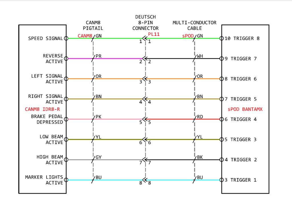

  25. Mar 14, 2025 at 10:23 AM
    beer30
    beer30 New Member
    Oct 17, 2024
    #124365
    117
    I figured this might be helpful.
    I created this wiring diagram so that I could connect the CANM8 to my sPOD trigger inputs.
    I didn't want to splice wires together.
  26. Mar 15, 2025 at 6:50 PM
    beer30
    beer30 New Member
    Oct 17, 2024
    #124365
    117
    Looks like you have a Limited, which uses canbus for the lights.
    Which is what the CANM8 is used for.
