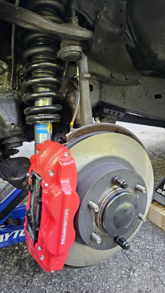

    Just finished up the brakes on this old truck. The light turned off after bleeding the other drum cylinder. It was the air in the line that triggered the light. I didn't take photos of the rear brakes but after swapping out all the parts (Bell crank, wheel cylinder, springs, shoes and drums), bleeding and messing around with the E-brake cable and parts, the rears came out great. Definitely challenging compared to disks. I did the fronts today. I think it's well bled and will give it a few days for the pads to bed in. I moved the LSPV nut up a few threads too. Thanks everyone for all the help. Here is a photo of the fronts. I never figured out the LSPV breeder screw size so just cleaned up the old on the wire wheel and reinstalled it. I bought a M7x1.0 and M8x1.0 and neither fit. I thought for sure it was one of them. Oh well the old one still works. 20250814_161839.jpg
