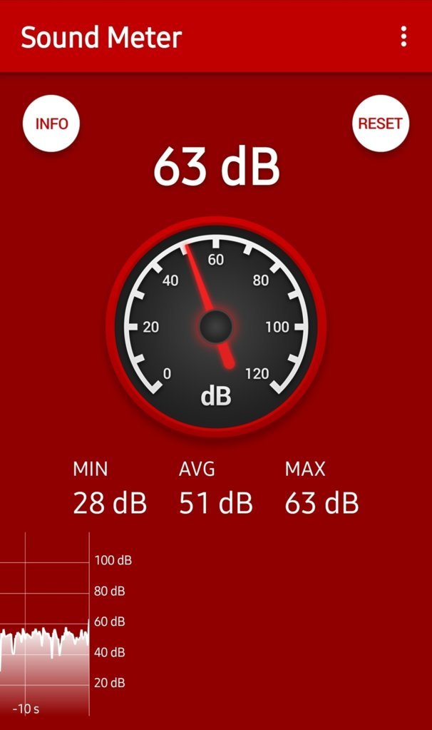

    Would you be able to use a sound meter to report back on the difference in decibel levels? Screenshot of the app I use...

    Didn't measure the sound levels before and after? You say it's quieter to your ears, ok... but taking that simple step would have provided actual proof positive.
    ADDED: What part numbers did you use for the Capstone (acoustic) side glass?
