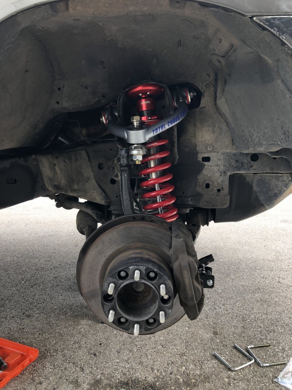

    here’s what everything looks like on one side from underneath
    KNABORES, Sirfive and Drainbung like this.

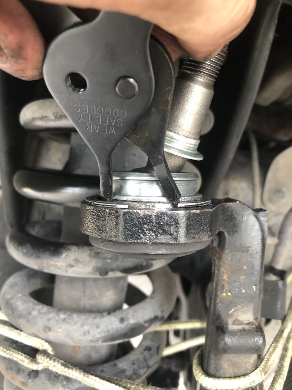

    It was going so smoothly until the c-clip came. Other than that I was able to wack it free in 2 hits.

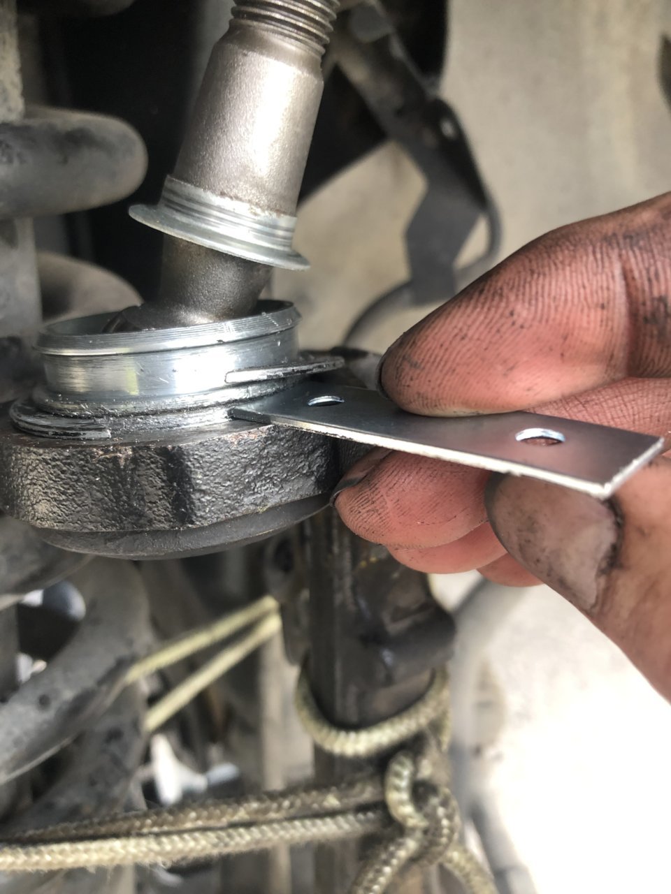

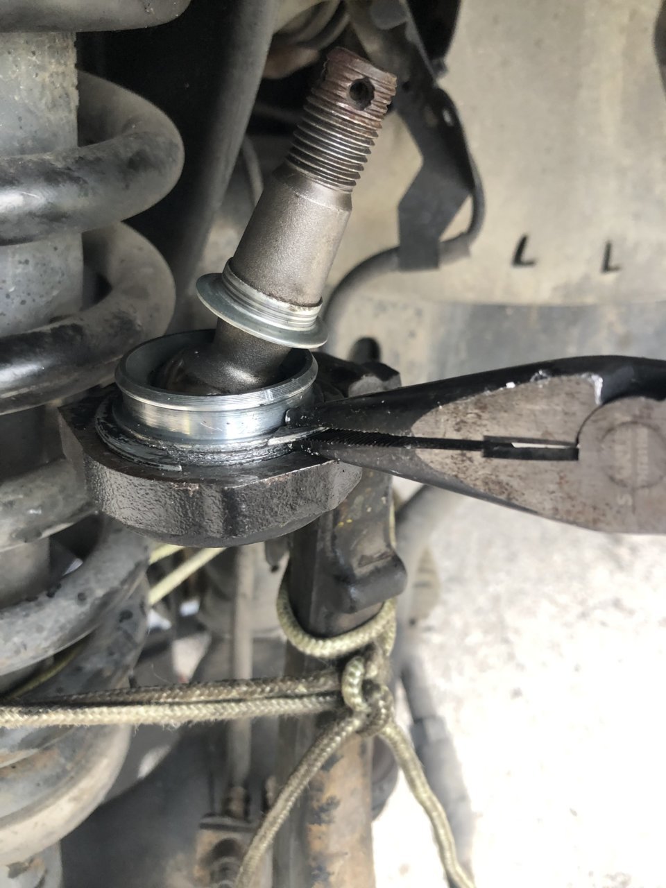

    5BDE6427-E70B-408F-BEEB-FC996F7DE3C6.jpg FC3CF2A4-EDC9-4B1A-8B70-8D4F1D3963C2.jpg 8F4FF17C-8213-4A8B-A4E8-72F7A3A17897.jpg
    stuffed some thin metal in between after lifting it up a little and used the metal sheet to get my pliers in

    Get a flat head under,it and behind it, when you get the end of the clip out of the groove.and you can work it out slowly.
    : I see you got it out faster than I can type! lol good job

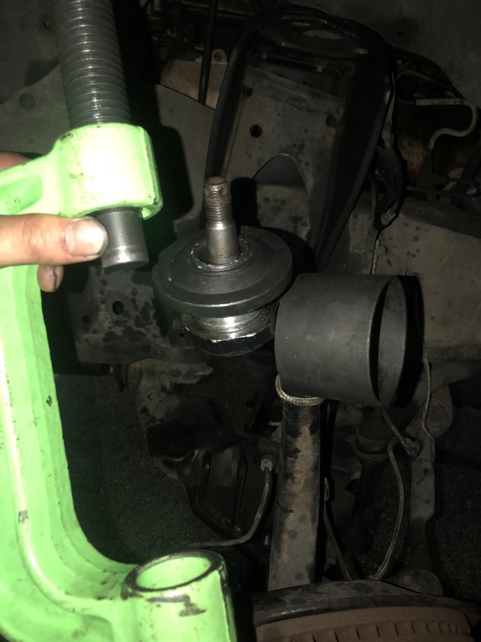

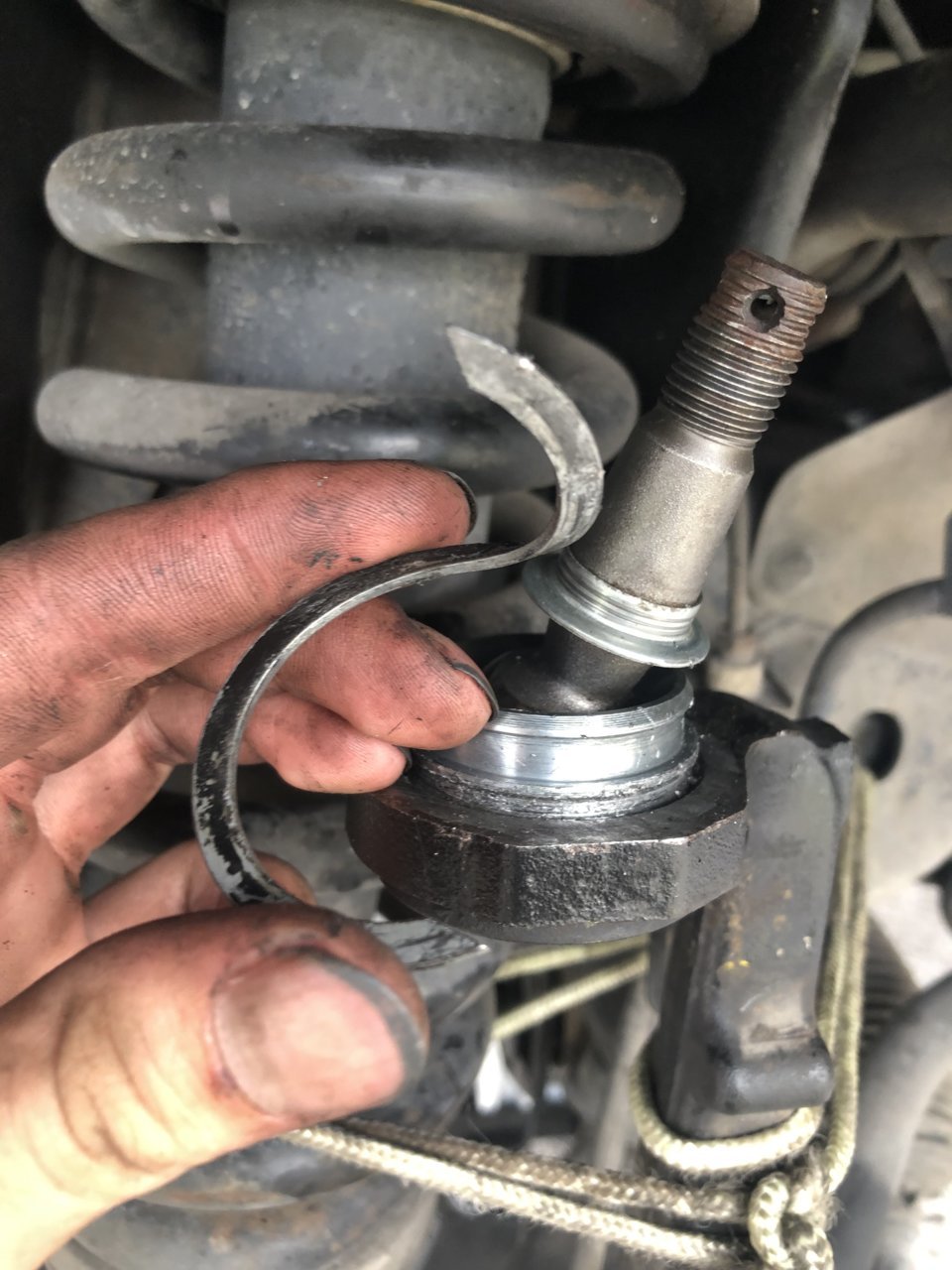

    Does anyone know the correct way to use this tool for getting out upper ball joints?
    bmf4069 likes this.

    ‘02 Limited AC TRD
    Bassani cat-back
    Put the nut on the threads? For my blazer i had to use several pieces of scrap metal to make it fit cause the kit didnt have the right sized adapters. I might have used a 3/4”-1/2” drive adapter on the press shaft.
    potoghi[OP] likes this.

    Looks like the ball joint is almost out. Smack that sumbitch with the Ford wrench (hammer) and it should pop out
    potoghi[QUOTED][OP] and Sirfive like this.

    I’ve done UBJs twice and Jesus Christ, while thoroughly entertaining, this thread is full of some of the worst advice I’ve ever seen.
    Plan to remove the whole spindle. It will make everything so much easier. This starts by removing the caliper and securing it so you don’t kink the brake line.
    Then break the upper ball joint free.
    The best way I’ve found to get the UBJ out from the UCA is using one of the 3 arm pullers that was shown in post #7. Get it snug and with two more turns of the ratchet it will pop right out. Leave the castle nut on to catch it once it breaks free.
    After that, take the (4) 17 mm bolts free from the lower ball joint and the whole spindle is out. Put it in a bench vise and then use a rented ball joint press to unseat and re-seat the UBJ.
