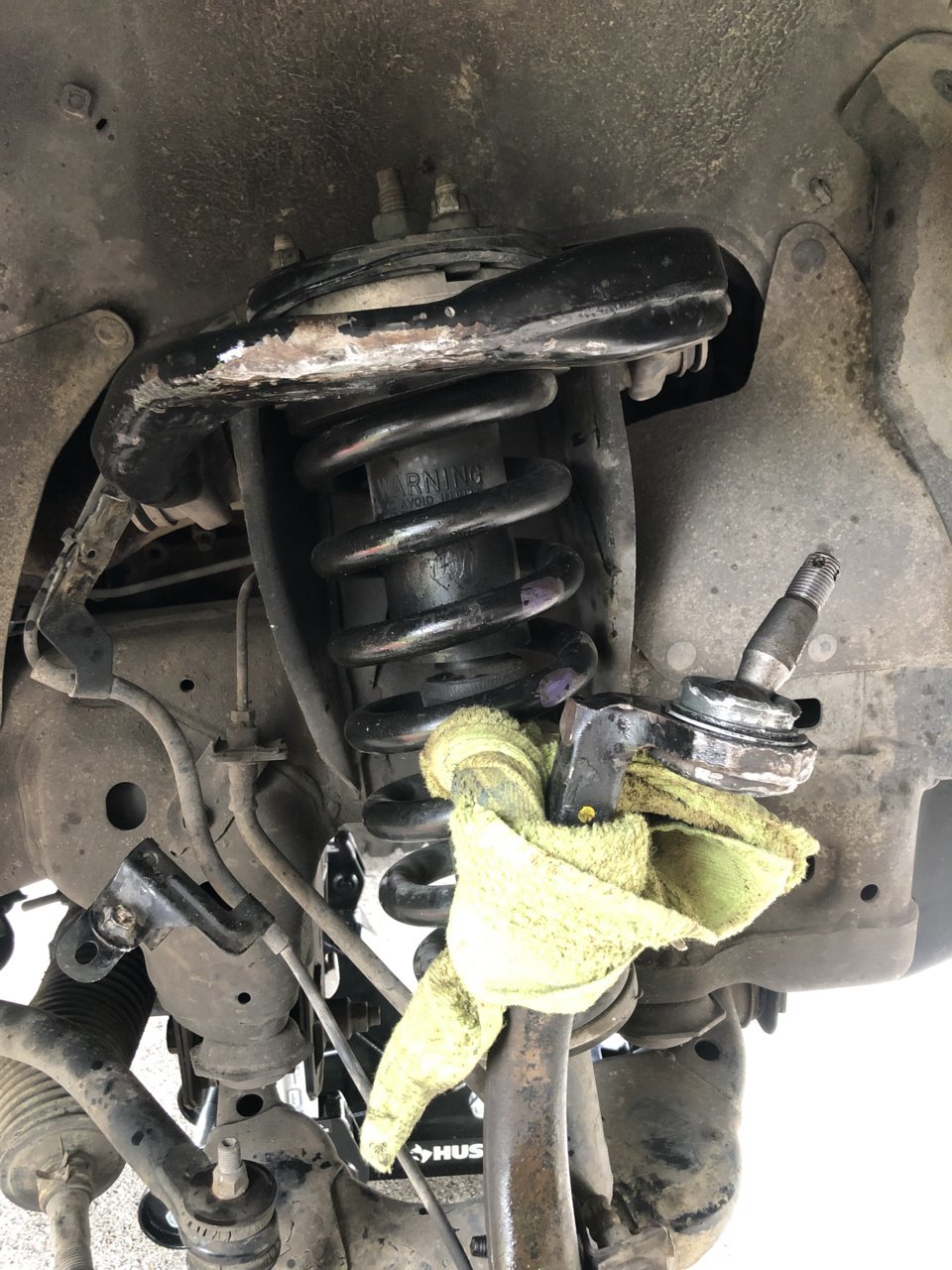

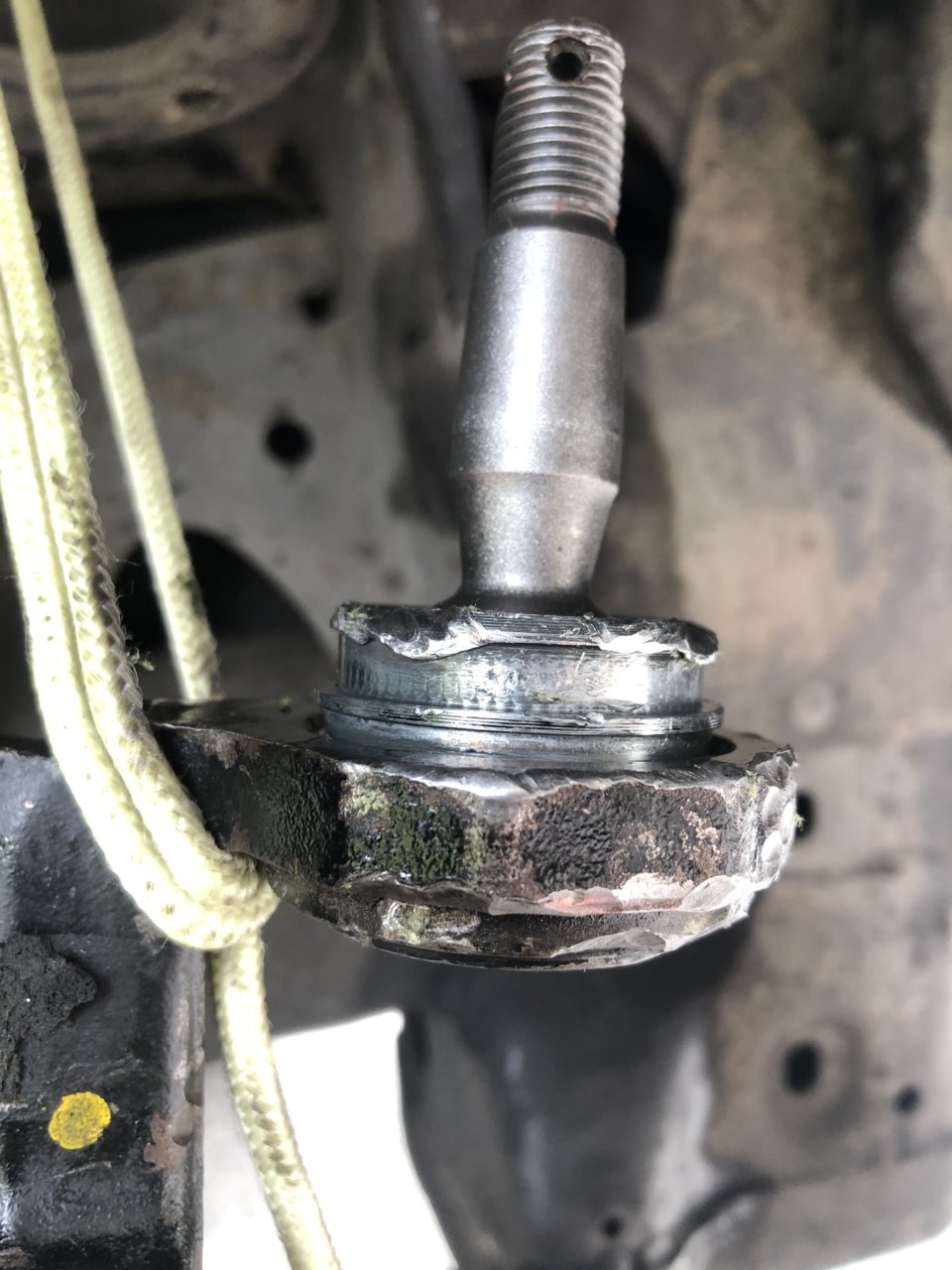

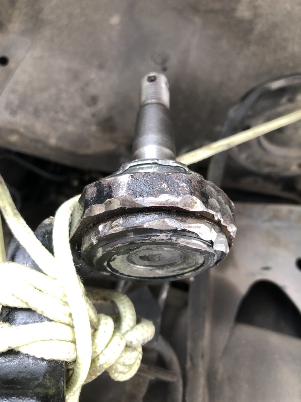

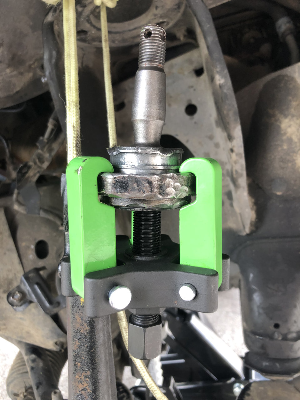

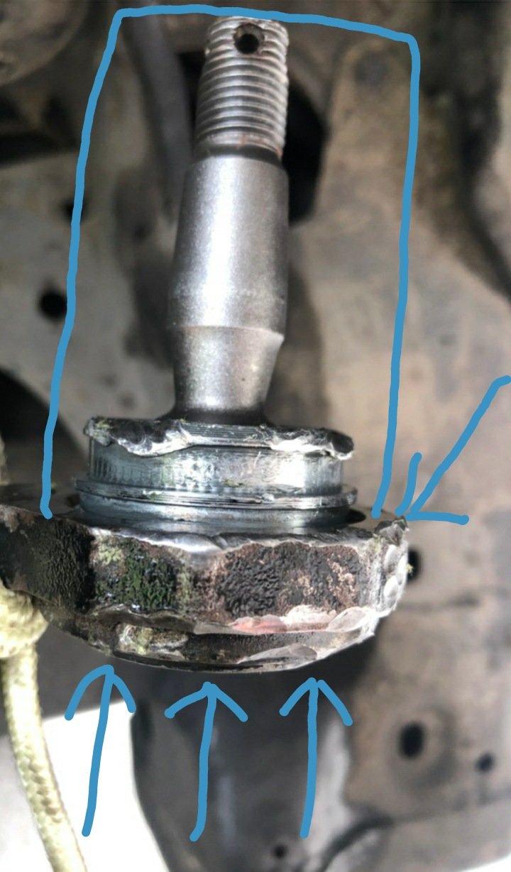

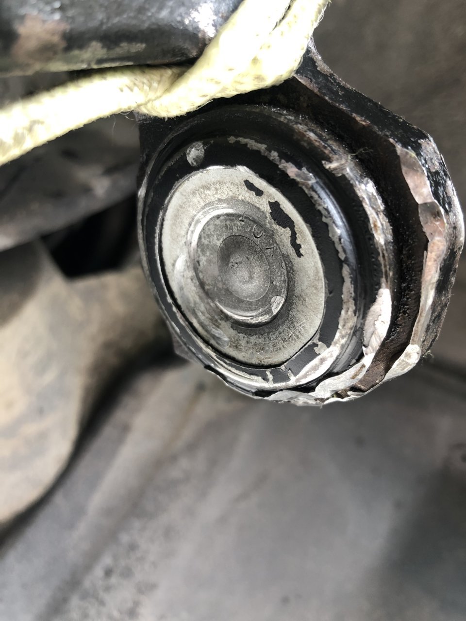

    20389609-6A48-49CD-8CC8-88595D32FBC0.jpg 44508B00-37FB-4596-8123-1B4D37F6C94B.jpg 9835F10E-6FF7-4614-ABAB-6FBE2C258E58.jpg
    the next issue I’m having to deal with is pushing this thing out :bananadead:

    Never done this job before, but shouldn’t it be pressed out from the opposite side?
    potoghi[OP] and Sirfive like this.
  9. May 28, 2021 at 11:18 AM
    #69
    assassin10000
    assassin10000 New Member
    Oct 27, 2020
    #54157
    2,197
    Andrew
    Northern CA
    '05 SR5 AC
    Yep. Clip comes off to allow it to be pushed through.
    potoghi[OP] likes this.

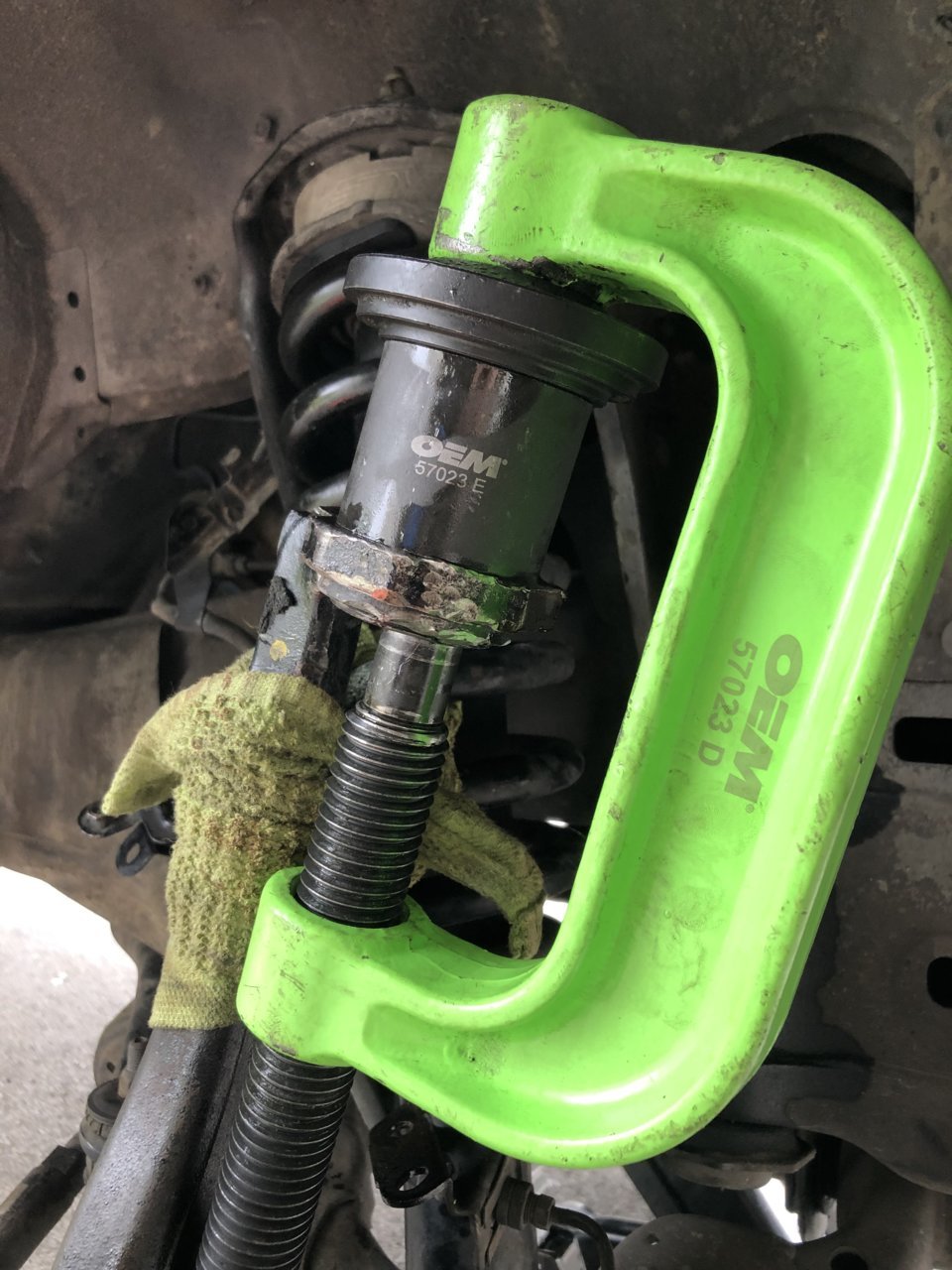

    I’m just following along some video on YouTube from Chris fix lmao. I’m one socket size short to be able to wrench the ball joint tool but I think the pulley puller may be able to get it690CD9B5-9736-44E8-984A-1DA5AD14F875.jpg

    Oh so am I doing it the wrong way right now?
  12. May 28, 2021 at 11:20 AM
    #72
    assassin10000
    Oct 27, 2020
    #54157
    2,197
    Andrew
    Northern CA
    '05 SR5 AC
    Looks like it.
    potoghi[QUOTED][OP] likes this.

    Looks to be the wrong way, might have to file down the damage to joint too.

    My old balljoints from the blazer are buried in the shop somewhere. I thought it would have pushed down, but theres a lip at the top of the socket?

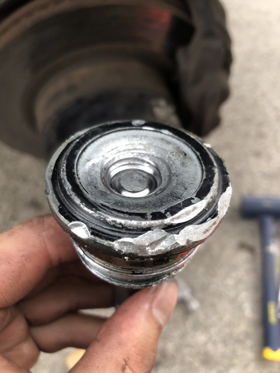

    I’m glad you guys are here. It definitely wouldn’t be denting in the ball joint that far if it was the correct way. I took the puller off and all it took was 2 smacks with my hammer to take it off.

    You need to hang that on your garage wall... or make something out of it. Mistakes are the best teachers.
    that knuckle might be a piece of art, too.

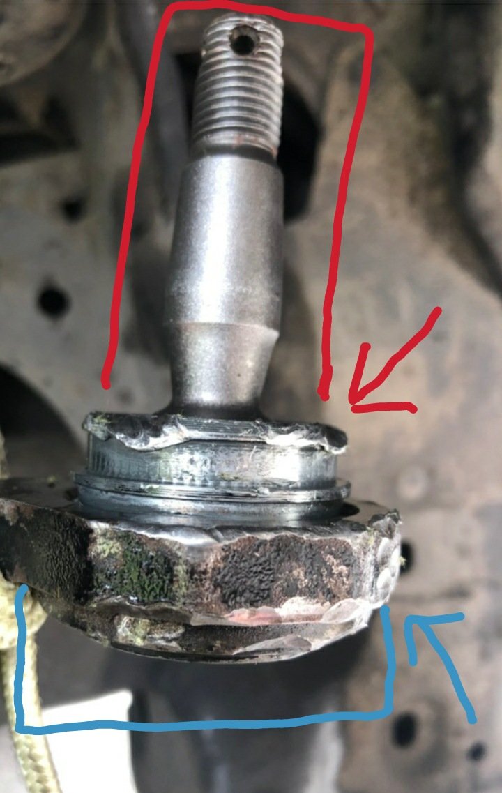

    To press the old ones out you need one cup that will go over the shaft and will sit on the shoulder of the joint here (red) and another cup that goes over the bottom of the joint and sits on the spindle here (blue)
    When you pres the new ones in you'll need a cup on top that sits on the spindle and has clearance for the joint to come in. Press from the bottom up. Be sure that the cup has clearance.

    That’s how I got both of mine off last night..#5 sledge. 4 or 5 stout wacks amd she broke free!

    Put it back in and finish pushing it through.

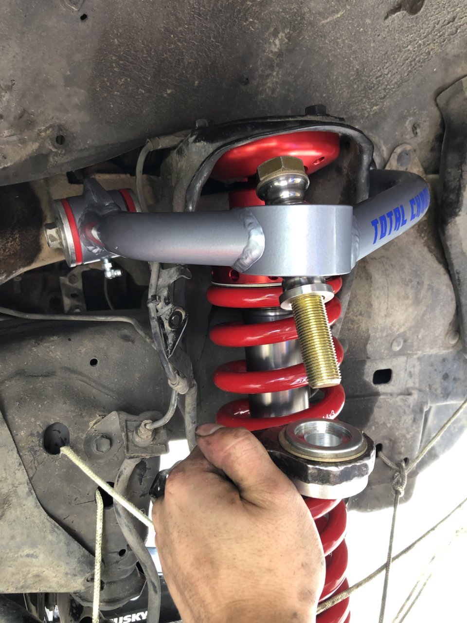

    got the coil over in! We’re so close but yet still so far.

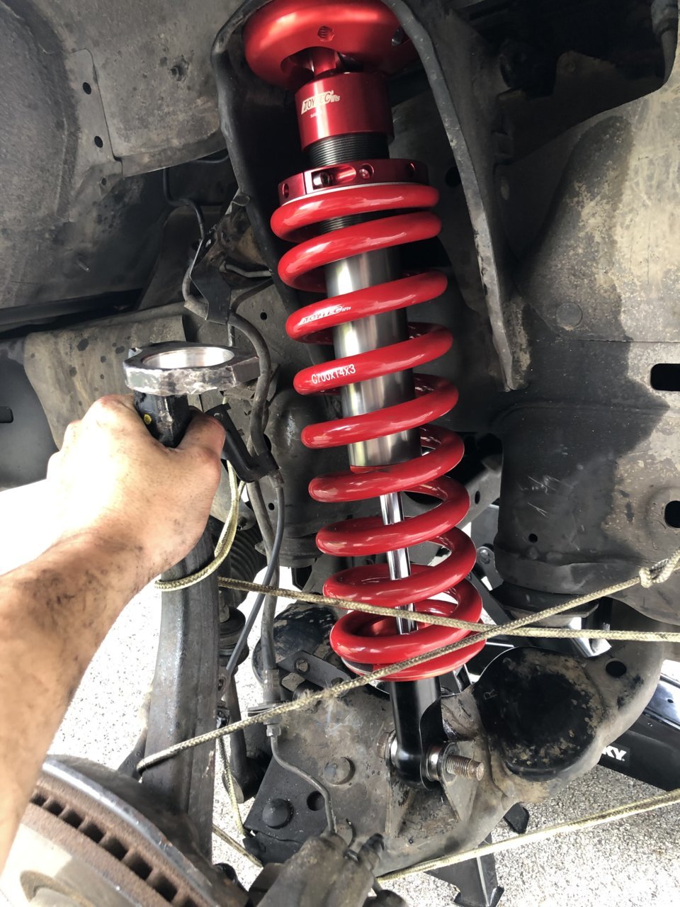

    A78D2DD5-2816-48BB-AB33-4F5941840301.jpg Can the uniball be moved? Or am I just too weak to move it lol. It’s at an angle where it’s hard to slide into the hole
    EDIT: nvm I figured it out! I had to move the control arm and knuckle simultaneously. I’m below a noob

    Yes, you can move it, find something to protect the threads and slip something over to get some ass on it.
    I'm liking how this is coming together. I've got TC UCA's on the parts shelf and I'm stuck in Covid induced shipping hell from ADS...:annoyed:

    the uca is pretty close to the coil :drunk:
