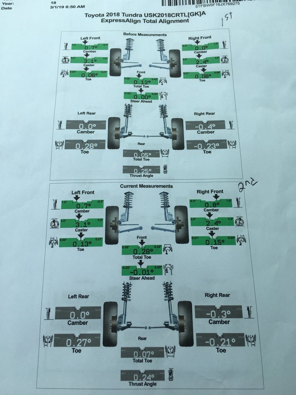

    New specs after adjustment

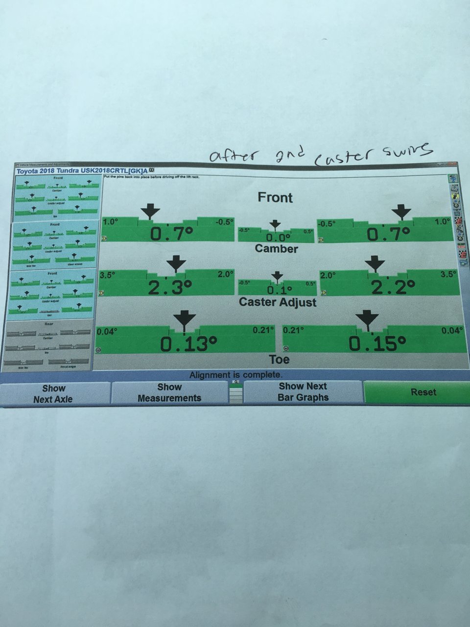

    Specs after adjustment

    Still way too much camber. Your tires will start wearing on the outsides within days like that. I suggest you bring it somewhere else because these yahoos don’t know what they’re doing.

    At least they are equal. It should ride a little better but still needs to be adjusted better.

    Actually, that much positive camber will make it drive worse. Steering will feel very squirrelly when it’s riding on the outer sidewalls of the tire.

    It's better for sure but still doesnt look great @Danman34 is right too much camber you will wear out your tires long before they are due. Chalk it up as a learning experience that most* dealers are not great and find a shop that knows what they are doing. *not all are terrable...but most just want your $$
