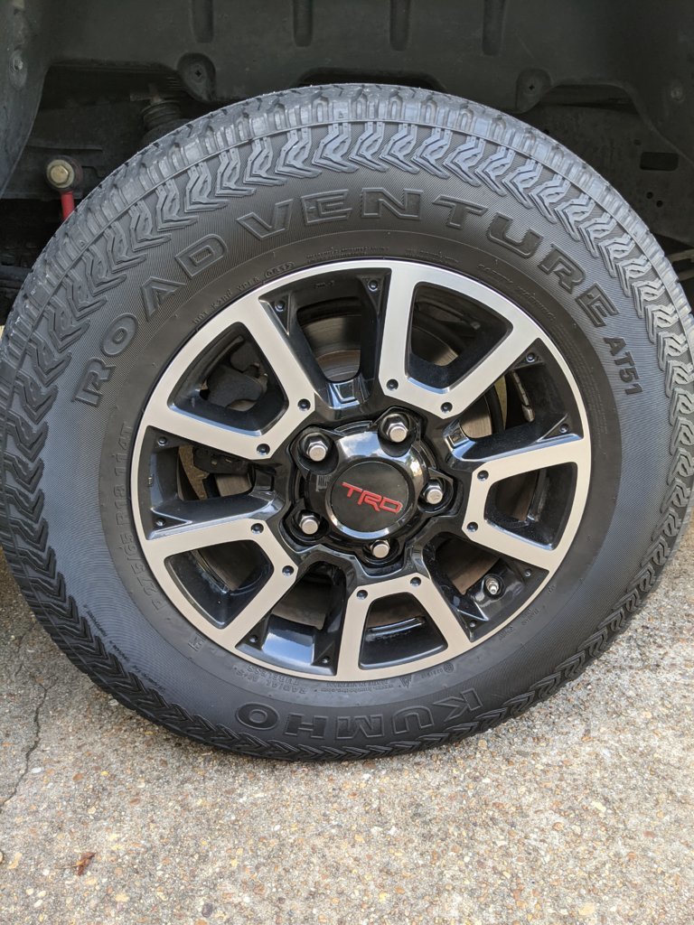

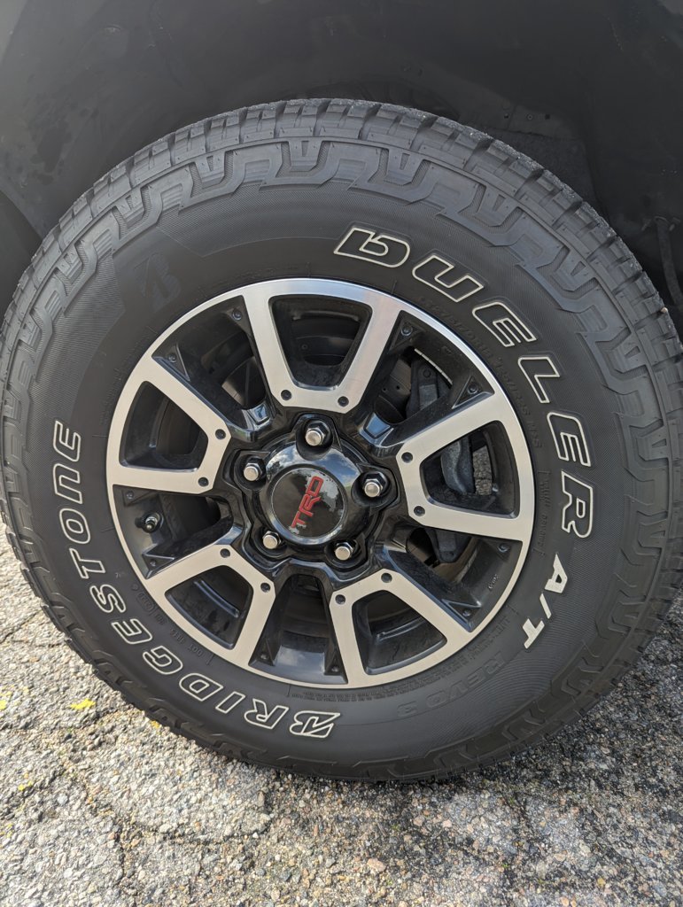

    Can someone please confirm my PSI for the tires, i keep having issues every time i get it balanced and rotated with Costco. I'm sure Costco techs are just improperly trained when they fill it to 31/Front and 33/Rear, "because that's what it says on the door". Even when my tires are bigger than stock(LT275/70 R18 125/122S) I used the calculator online but it came out to 40 PSI. When i take it Firestone for my lifetime alignment they advise me to go with 41 in the front and 44 in the back.
    New Tires
    Lifted Front 1.9 and .75 Coachbuilder Shackles Rear(Bilstein 6112/5100)
    Tires are Bridgestone Dueler A/T Revo 3
    Old Tires:
    Kumho Road Venture AT51
    LT275/65 R18 114T
    Ive been pumping the front to 41 and rear to 44, but this could be wrong for the size. Any help would be appreciated from some who know much more than i do on this subject.

    I have Cooper AT3 XLT 295 70 18 on my Sequoia. Cooper said 42lbs all around.

    I’ve found 40psi to be the sweet spot unless you’re loaded really heavy.

    Do you think the size of them being a little wider makes a difference in the amount of PSI?

    Nope nothing too crazy, just regular upgrades here and there and an audio box and amp. ive been running 41 front and 44 rear, but maybe i need to have the same psi for all 4 tires.

    Higher in the rear is tough to justify with nothing in the bed imo. The rear axle is significantly lighter than the front.
