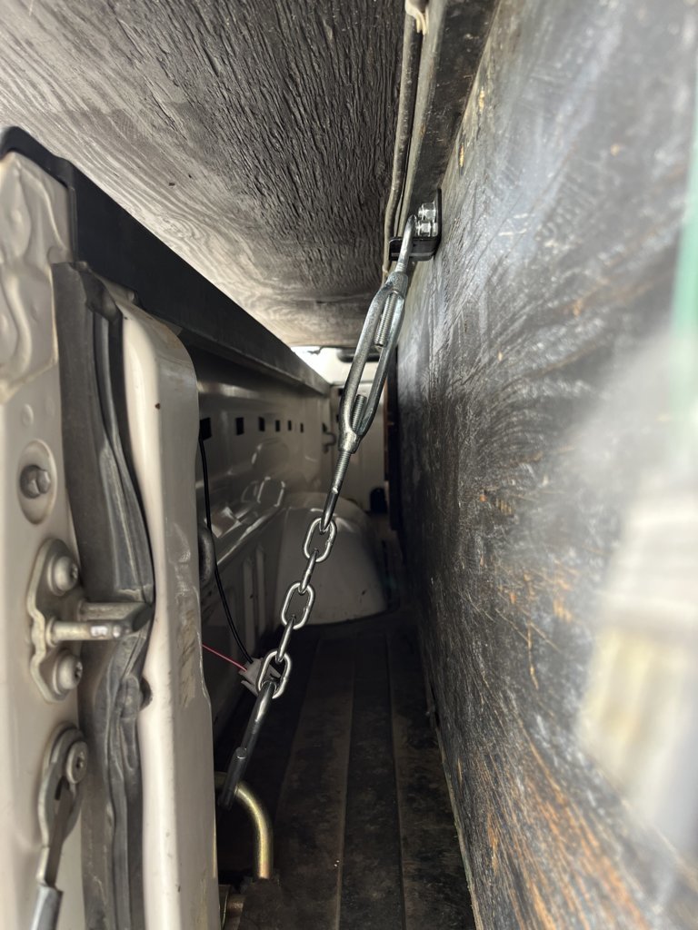

    If you do anything to improve on the safety of this setup, I would HIGHLY recommend taking out all the carabiners and replacing them with Chain Quick Links with a known weight rating.
    Turnbuckles do not connect/thread back to themselves, so you are only relying on the strength of the metal to not "uncurl". I've seen it happen, they are subject to a load and simply straighten out. The chain link I posted above that threads closed is MUCH stronger and SAFER.

    Hey thanks. I have a few of those I've used for tow chains, and the only reason I didn't use them for the tie-downs is because they were too thick to fit through the turnbuckle eyes. At least the ones here at my local hardware store. I tried! Now that we're getting into camping season I'm working on the camper again to get it ready, and I bought this kit. My setup won't be janky anymore.

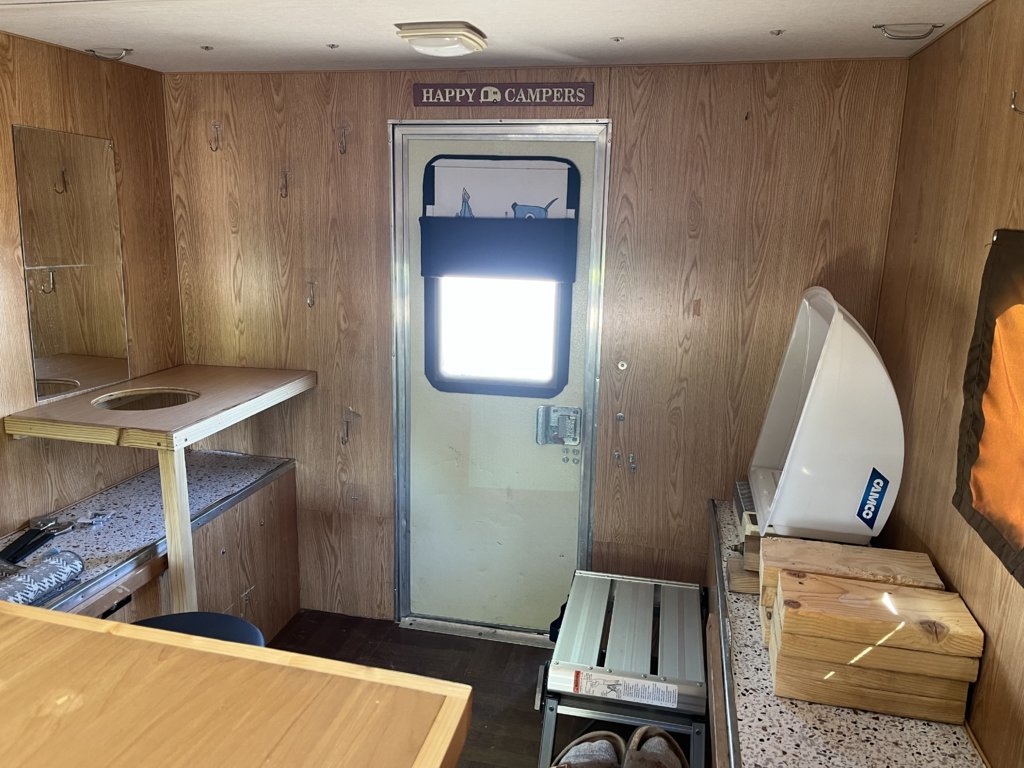

    I've also got my dinette table mostly done. Just need to lacquer it. The camper ought to be a lot more comfortable by the time hunting season rolls around this fall.

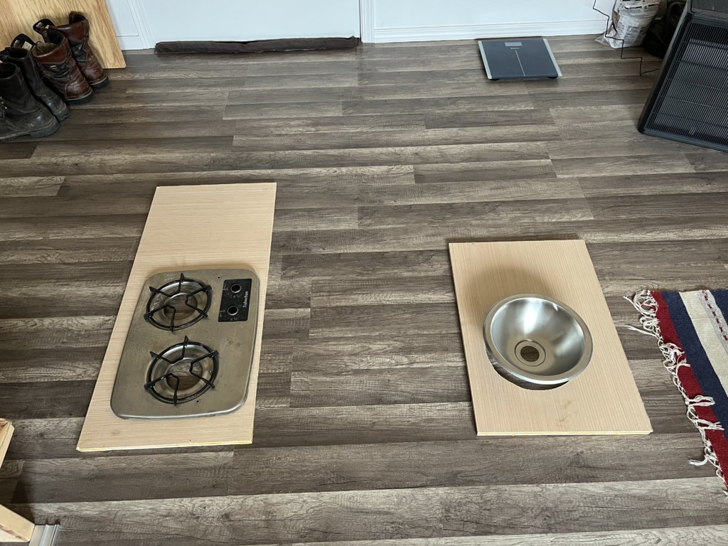

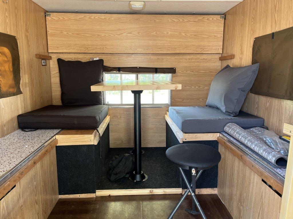

    Sink countertop is ready (previous owner installed the mirrors crooked...my countertop is level). I've got the stovetop countertop almost ready, and it'll go on the opposite side. Not sure if I'll box in the lower area or just put a curtain down there or what. The dinette cushions are just things I got for free. Not sure what the final seating will look like.
