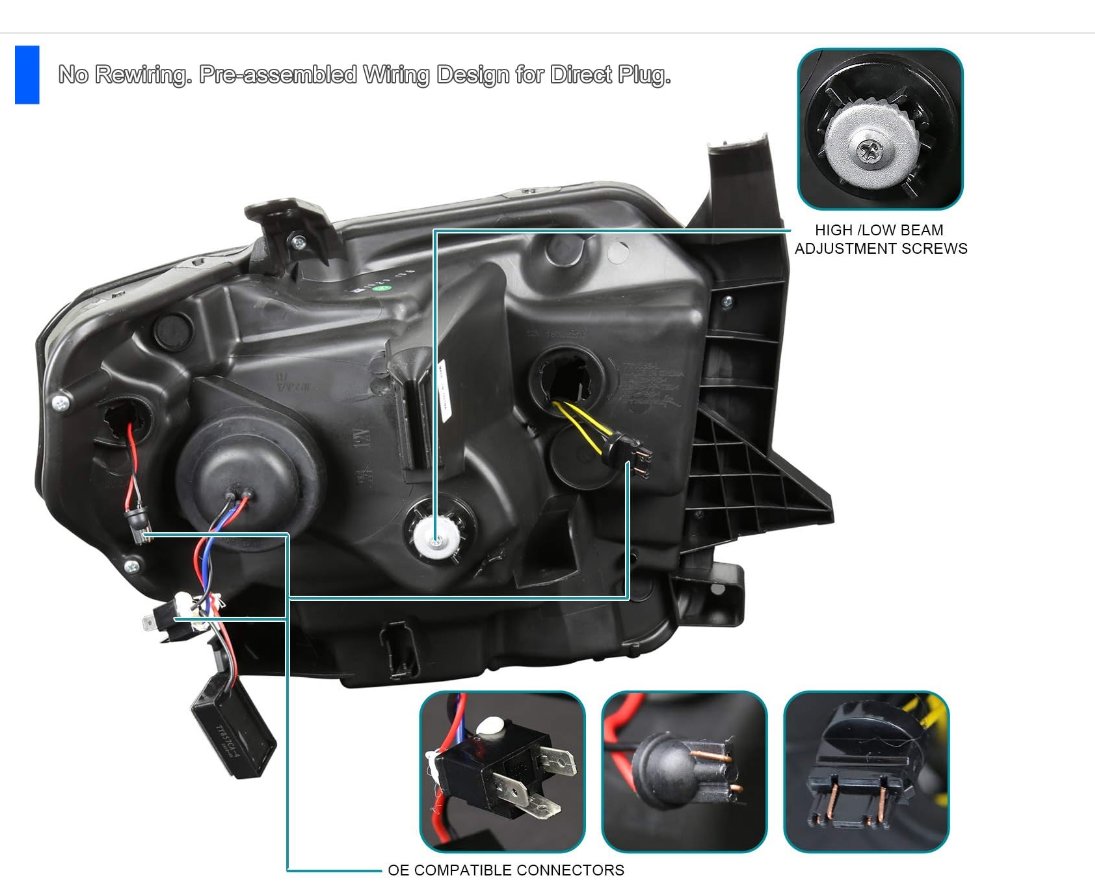

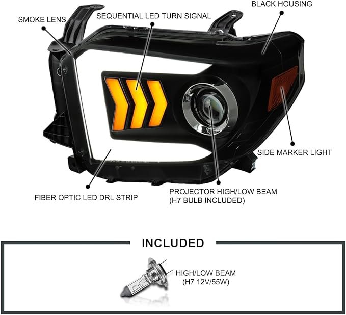

    I have a 2014 Toyota Tundra 1794 edition and installed the Spec-D Tuning LED Sequential Signal Black Smoke Projector Headlights. I would like to get the LED DRL strip to work. Do you have a wiring harness for these headlights or know what I can do to get them working?

    Welcome to the forum.
    According to the website they are plug and play.
    2014-2021 Toyota Tundra LED C-Bar Projector Headlights w/ Sequential Arrow Turn Signals (Matte Black Housing/Clear Lens) - Spec-D Tuning (specdtuning.com)
    Do you have them installed and the big white DRL isn't working?
    It should be getting power from the DRL/turn signal connector..

    Yes, I have them installed and that connection didn't have anything to connect it too. So I need to find out how to wire it in to get them working.

    Yes, there was a connection unattached on the headlights. I'm hoping there is a fix for this.

    I responded on your other thread.
    Can you take a pic and post that connection, I didn't see it on their website.
    Please respond in your other thread...
