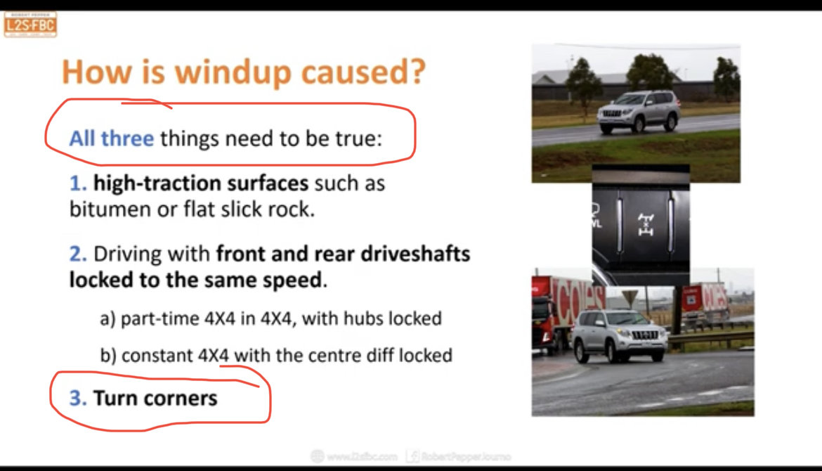

    I try to use 4-Hi at least once a month. Always on wet or gravel roads though, never on dry pavement. Even in a straight line on dry pavement you can get wind-up which can destroy your transmission.
    Here's a really good video on the subject. https://www.youtube.com/watch?v=1EHcrjIlkHk. At 4:44 of the video it has a great visual showing wind-up.

    sooooo, specifically says you have to turn to create windup. No mention of damage while driving in a straight line while in 4wd.

    Go to 9:35 of the video and watch it from there. And I've never seen a 100% straight road. Just small swerves from side to side in your lane can cause windup.
