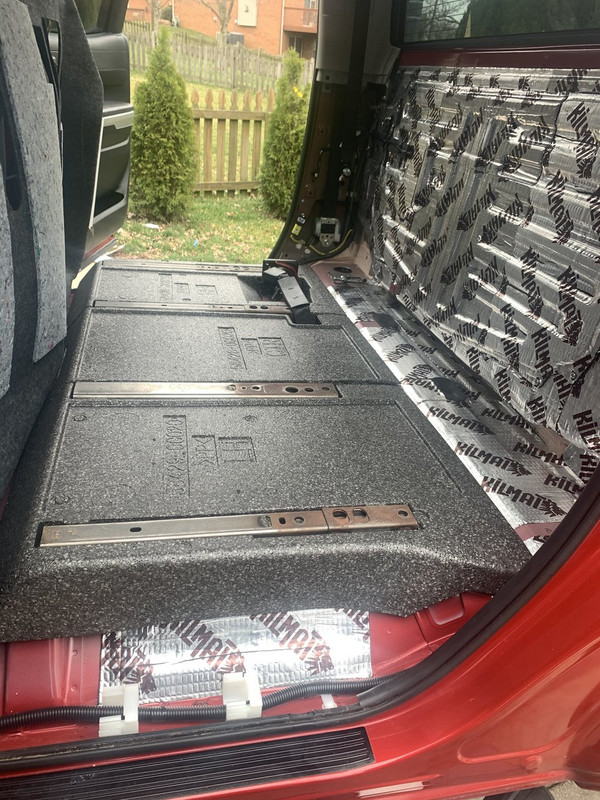

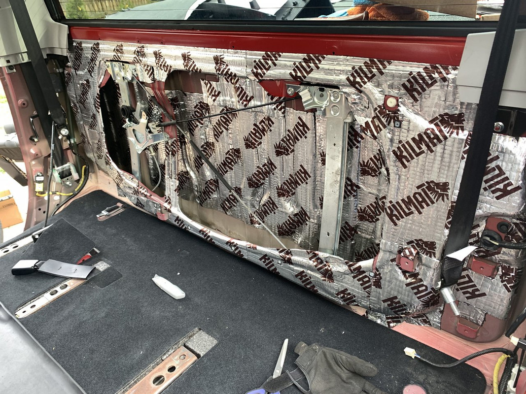

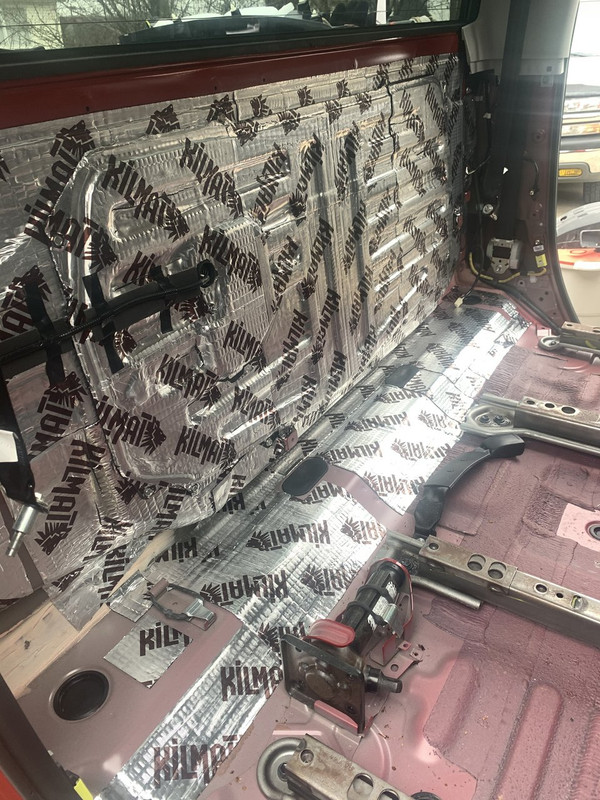

    Wow. Seems like some of you all are using a ton of extra material for the doors. Or I am really under estimating the size of the doors.
    I did my rear floor, rear wall inside, outside, and the rear wall panel completely separate and I used one 18 square foot box and one sheet from the 2nd 18 square foot box. I am just not visualizing how a single door is going to take 15-20 square feet.
    This is the first time I have done such a thing so maybe I did a crap job. Just need a chance to get the doors done. The rear wall and floor alone made a huge difference.

    That looks great! Very tidy work.
    What's involved in opening up the back of the cabin? I've had my seats out before but didn't pay attention to what's back there. Any carpeting to cut or is there just a loose shroud hanging over the metal?
    I'm still waiting to start my install but I can totally see using 18 sq ft per door. One square yard = 9 sq ft. One square yard per surface, two per door.

    It is simple. Pop the seats out, remove the weather strip around the doors to pop out the C pillars if you want to get the material behind the pillar (not sure really how much added benefit that actually gets but is easy enough to remove), then the carpet just folds back you can see it standing up there in the last picture I tied it up to the front head rests.
    The panel is a bunch of 10mm (if memory serves correct) bolts.
    Hardest part is the inside back wall because you have all the rails, tracks, and supports for the back glass. Just have to work the larger pieces back there carefully.
    For $30 in material and took me about 4 hours as I had my 7 year old helping/learning (which usually adds a fair amount time compared to just me doing it but teaching my boy skills and spending time with him is well worth it).
    I will do a full system someday when funds allow but for now I just straight swapped an 8” Alpine sub into the factory enclosure (needed a 1” spacer) but just adding the sound deadener to the back and the sun really changed the dynamics of the JBL system. Can’t wait to get a chance to get the doors done.
