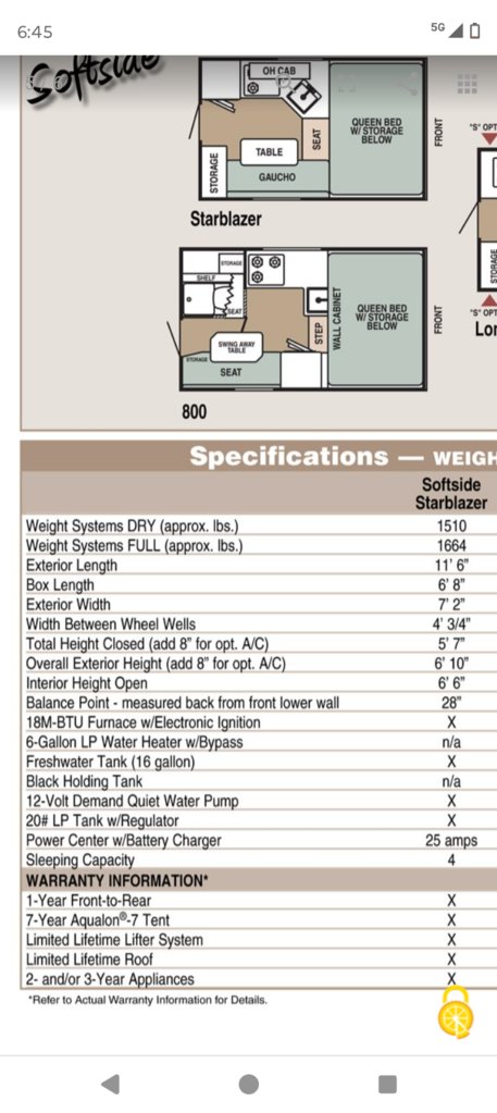

    Heavier than I thought. Still gonna send it :rofl:
    I've removed probably 100 lbs of that worth of water storage and decreased propane capacity. AGM battery probably makes a difference. 1450 is probably about right

    Ha, scale it and you’ll find it’s probably closer to that 1600# mark. You’re over payload for sure (by as much as 450# depending on your trim level), potentially over GVWR and rear axle ratings as well. And the weight is up high making for a poor center of gravity. I wouldn’t send it. Probably wouldn’t drive it anywhere faster than 55mph. And wouldn’t drive it much.

    Ya, I don't really plan on moving it too much but when I do it'll be covering some distance. I think between what I've taken out of the truck, out of the camper, and my VERY minimal gear we'll all be surprised by the weight. I'm not going to put it on a scale until it's packed and racked and full tanks of gas. Weigh her at her fattest. Lol

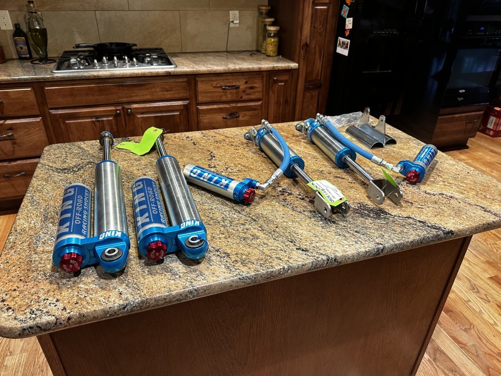

    Anything is better than the factory black ones.
    Depends on budget. I'm a King Shock hooker, so there is that.
    This is what is on my tow rig. More better.

    That is a thing of beauty

    I will pull these shocks off and put them on my next truck...unless I buy a Ford.

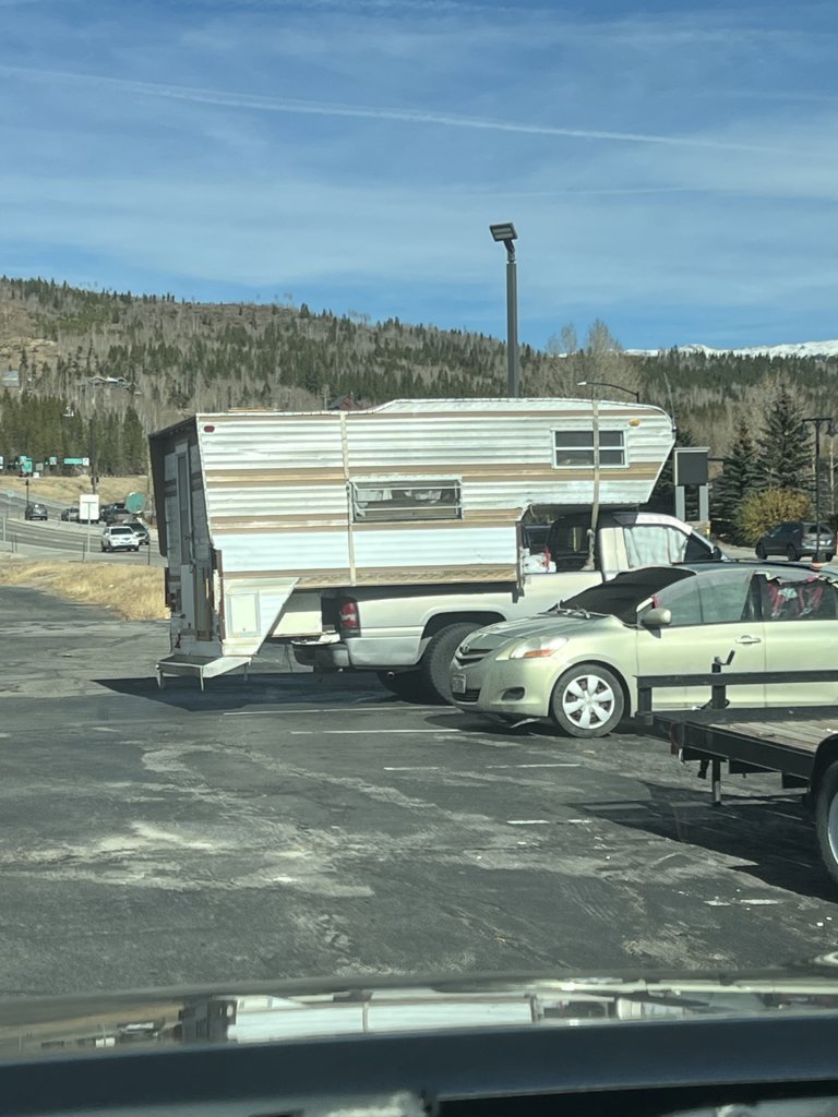

    At least you're not this guy.

    Got them yellow straps though. Probably forgot to pat it twice and say "that'll ride" :rofl:

    Haha. Hangin on by a thread... I actually captured this setup outside of Napa auto parts. I was literally like wait, this can't be for real. Yet it was.

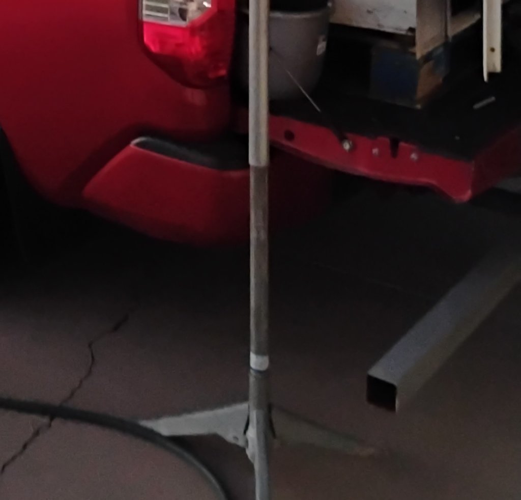

    When I hauled mine home I strapped the anchor points to the running board brackets and sent it. :D
    Then I thought I was going to get crafty and make a hitch mounted anchor point, it didn't work out as planned.
