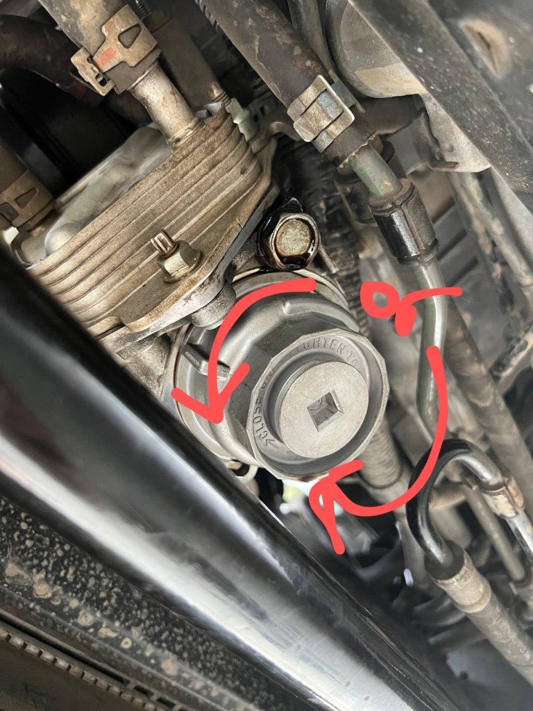

    I'm going to attempt a damn oil change on this truck, yet again. The last few have not gone so well with having that stupid plastic housing seizing once, and cracking twice.
    This is probably the dumbest question ever but which way do I turn that fucker? I mightve actually broken it last time because I was cranking on it the wrong way.
  14. Dec 18, 2024 at 6:21 AM
    #464
    Tundra family
    Tundra family [OP] New Member
    Oct 23, 2024
    #124738
    1,835
    Please don't say righty tighten, and lefty loosy. Tell me to spin it clockwise or counterclockwise, that way we're on the same page.
    Even better. Do I pull the handle of my ratchet towards me at the front of the truck or do I push it towards the rear?

    Clockwise is right and tight.
    counter clockwise it left and loose.

    Counterclockwise to remove.

    Do these seize or something? I know the spec is like 12 lbs, why the hell is it always so damn tight?
    I'm seriously considering running a remote filter setup or an adapter to use a screw on. This thing has about pissed me off for the last time.

    Was a torque wrench used last time on both the canister and the drain cap? The canister can be tightened further when securing the drain cap on the bottom if the person tightening isn’t paying attention.

    It's highly doubtful, Ive been having it done at CHAMPS, I figure if they screw it up it's their problem. I had to replace that housing every time from it cracking, the stupid aluminum one leaked so I went back to OEM

    They have an OEM aluminum one off a Venza that works if you swap over the perforated tube for the filter. It’s what I put on my truck to not have to worry about cracking.
    I’d also suggest buying one of the TRD oil filters if they’re still available - they have green o-rings that are wayyy better quality. Haven’t had to change the canister or drain cap o rings for a couple years now…

    The removal tool has to line up on the tabs on the aluminum housing, same as the plastic.
    The housing in the pic you posted is the aluminum one.

    You sure? I know the lighting is weird but the drain cap and housing appear to be different colors / materials to me…

    Well I was.... until you said that. Now I'm not sure.

    I think it is the metal one in the pic, that's just the 1st pic I found in a search for visualization purposes

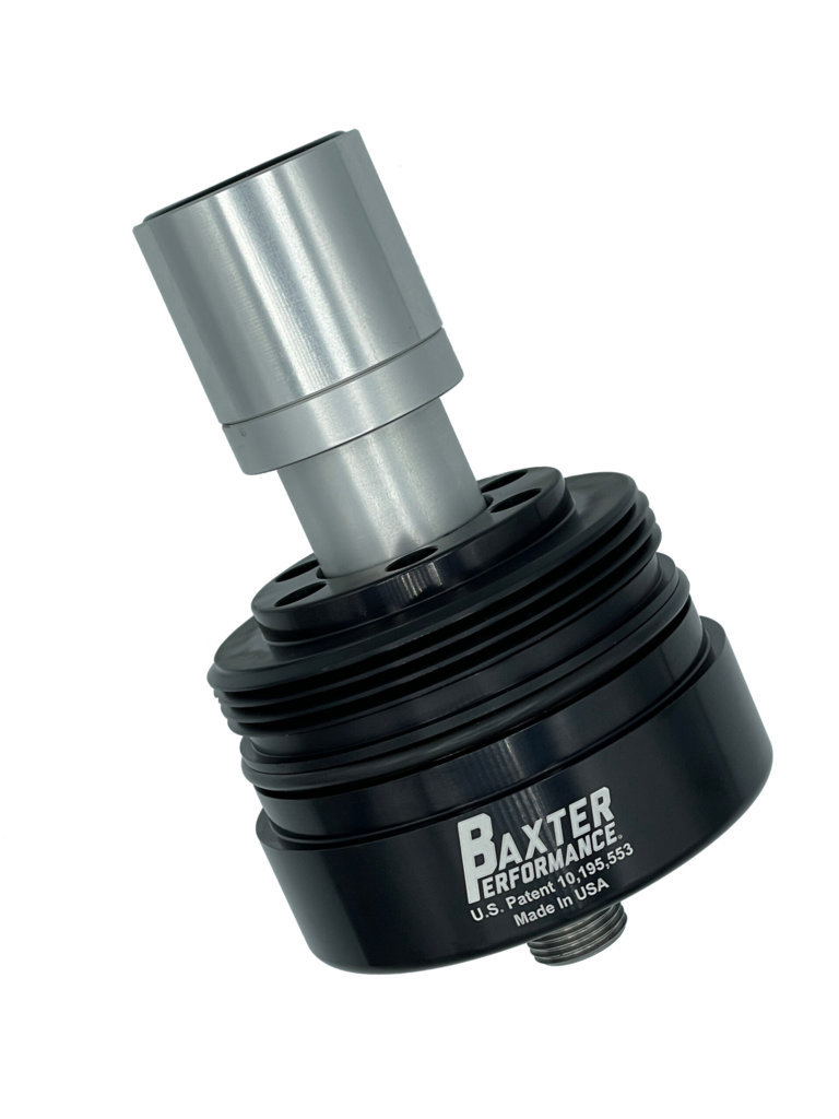

    Either way, if it gives me anymore shit it's going on the next bonfire.
    I feel like the Baxter would pay for itself pretty quick if it stress free and doesn't leak
    I can see this being a problem also, the whole adaptor coming lose instead of the filter screwing off of it.

    Oil change went smooth, no cussing or breaking shit this time. Switched it up to 5w30 hoping to quiet down the VVT noises.
