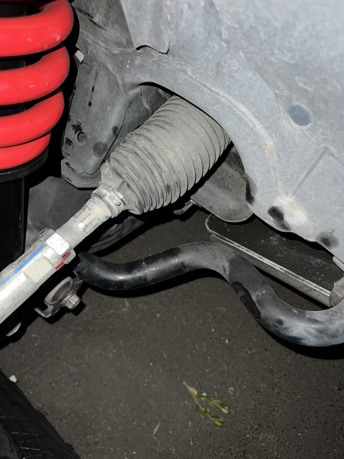

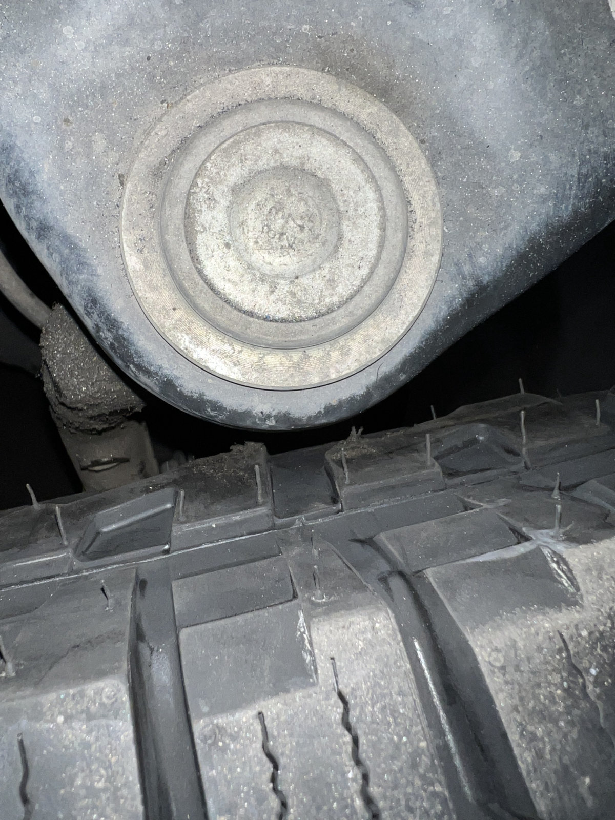

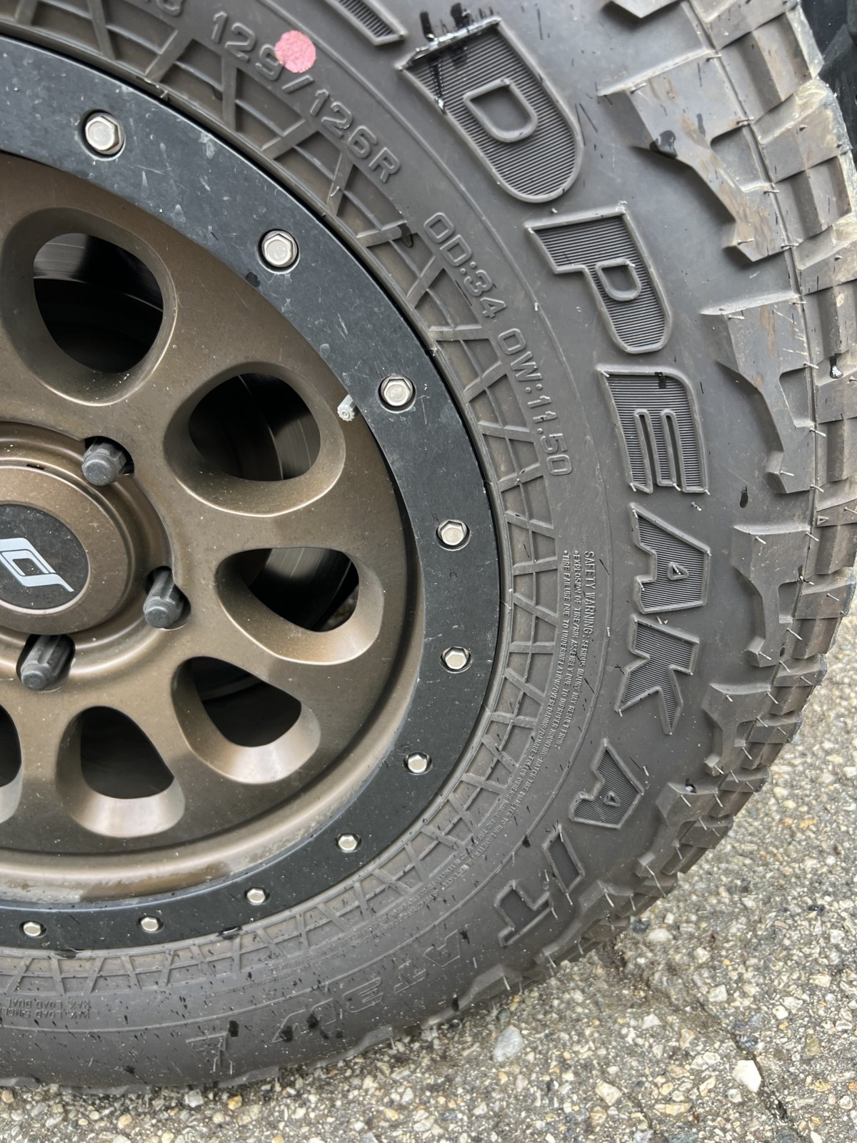

    What's up guys, wanted to see if I can get some help here. I have a 2018 and I'm running Wildpeaks 295/70/R18 on stock Tundra wheels, Dobinsons IMS, Toytec shackles, I got a bmc, on stock UCA's and had a off-road alignment.
    So here is the thing, when at full lock when turning to the driver side my front passenger side wheel rubs on the sway bar. How do I fix this so it does not rub? IMG_7194.jpgIMG_7226.HEIC.jpg IMG_7236.HEIC.jpgIMG_7187.HEIC.jpg

    You could add a wheel spacer to get some additional offset. I'd probably go with a 1"/25mm spacer.

    @Gaston ok. So you think it’s the offset? So different wheels should fix this issue?

    remove the sway bar?
    295 on the stock +60 is the problem. most 295s are on a +25

    Yes, some additional offset. Spacers would be your cheapest route or new rims if you'd like. As mentioned above, removing the sway bar would obviously fix it but if you like the handling with the sway bar then you wouldn't want to do that.

    Thanks guys. Sounds like rims will be my next upgrade. I want to do it right and I have heard negative reviews on spacers. Definitely want to keep the sway bar.

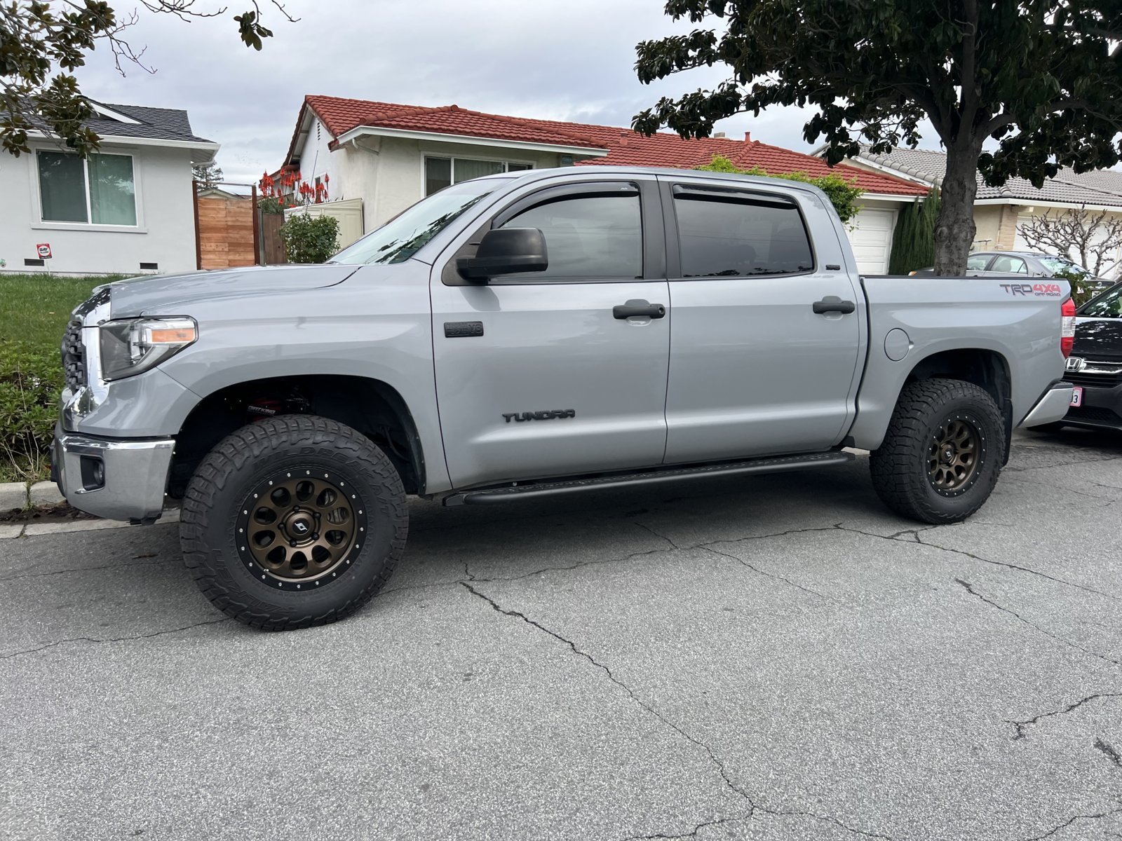

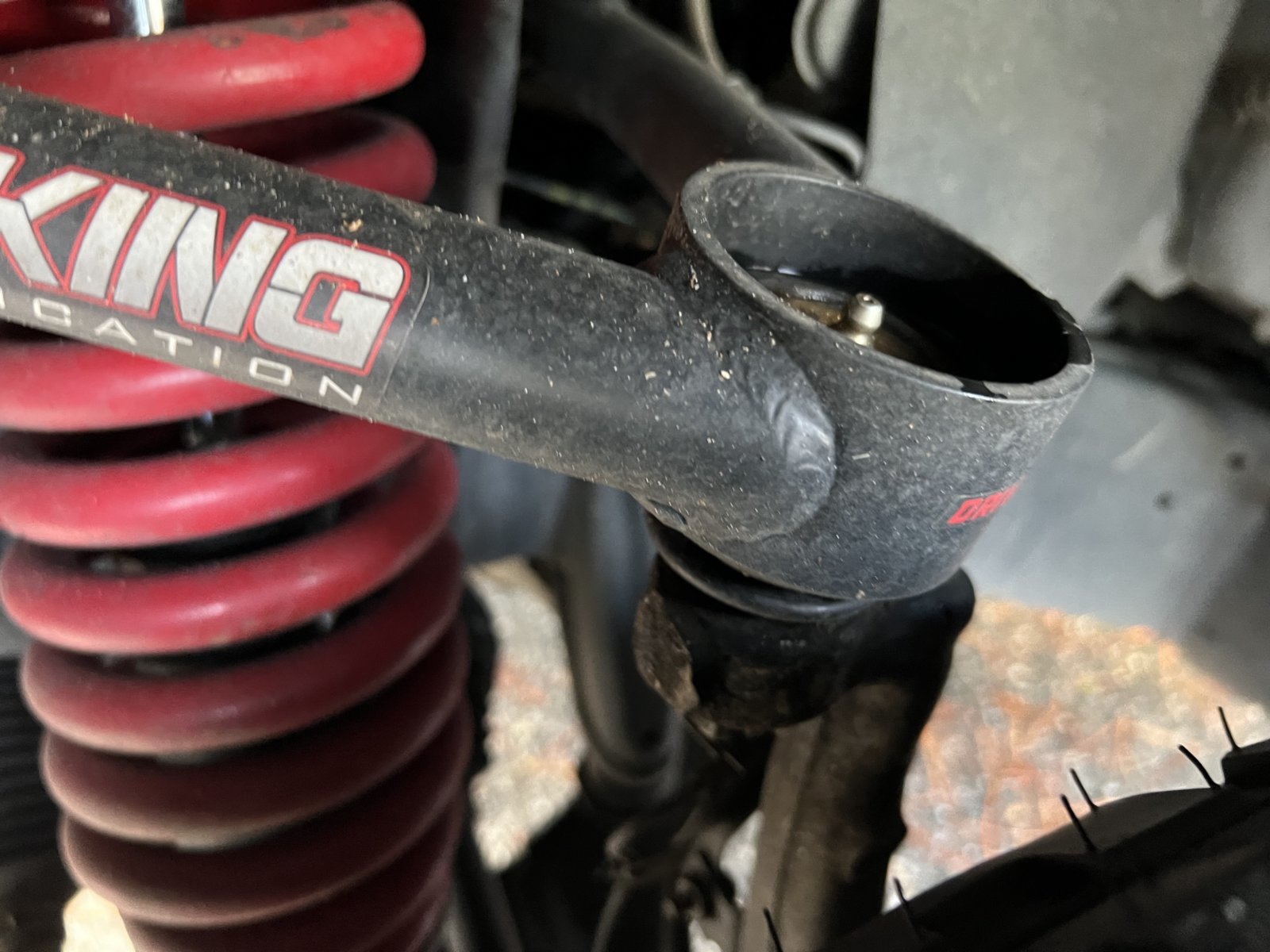

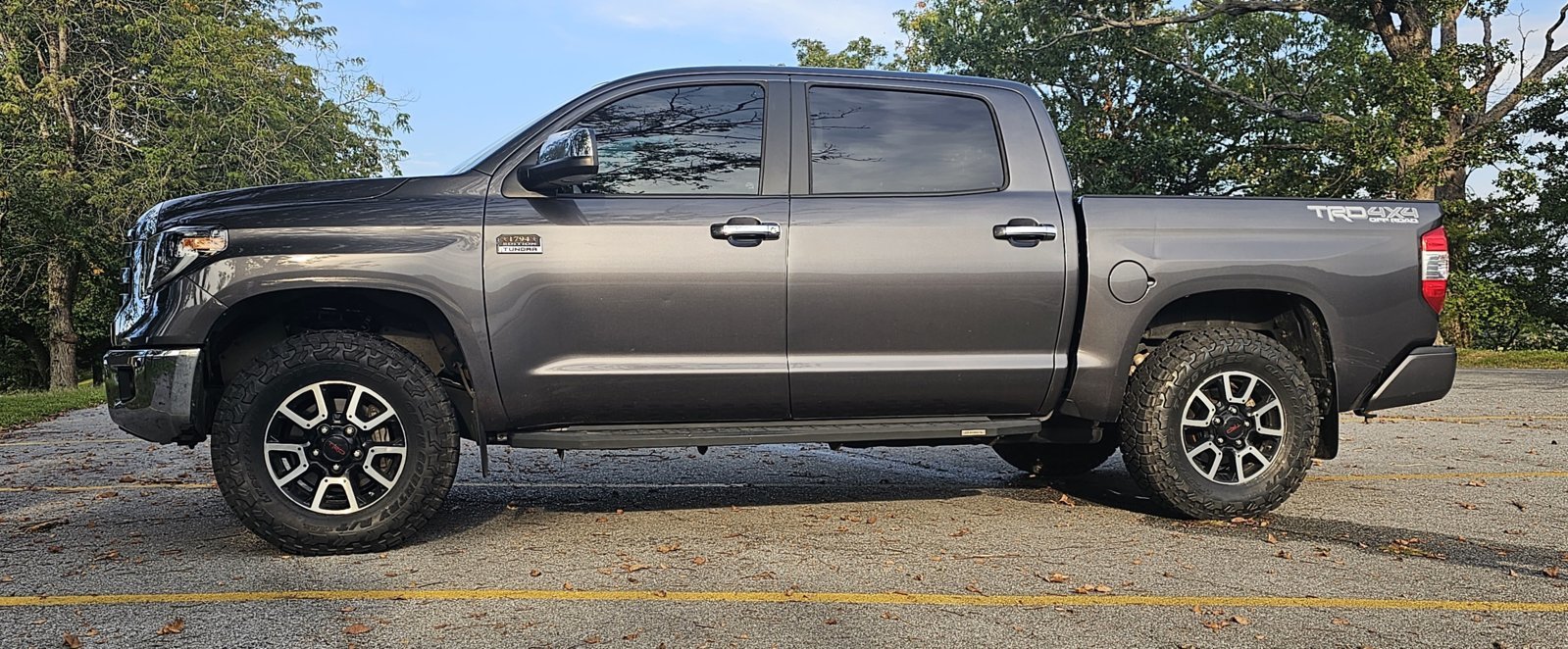

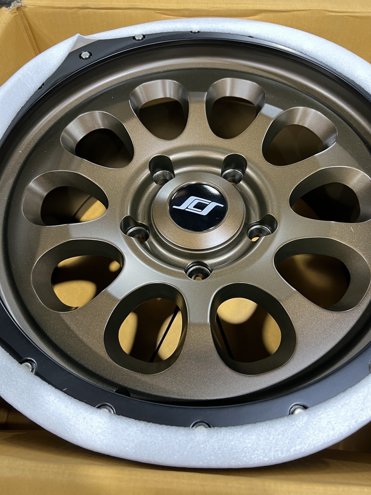

    Late post. But here is the update. Went with Ray 10 wheels and dirt king uppers. This reduced the rubbing. Still need to do the heat gun on the front passenger side as it rubs slightly in reverse when turning towards driver.
    Here is how she sits now.
