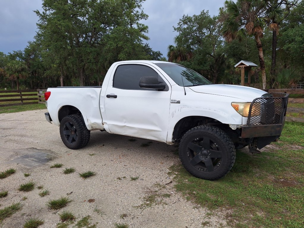

    Those 20” Rockstars will be perfect for hauling duties.

    Damn right bro. If you squint it's pretty much an F350 platinum now.

    If rockstar wheels were a hat. I won’t knock em’ though if they were a good deal.

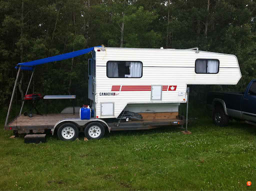

    My Father inlaw did the exact same thing with his truck bed camper!!
    Kinda like what I did with the James Baroud Pop up tent.
    Once you unloaded the SxS off the trailer it became your front deck.

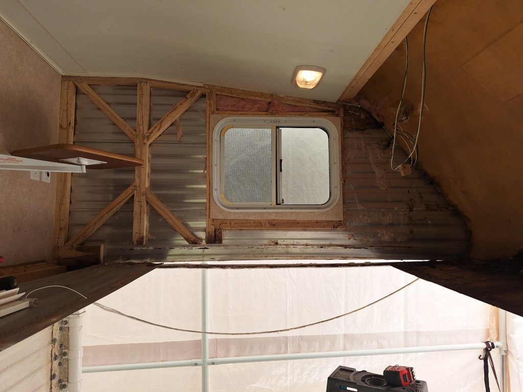

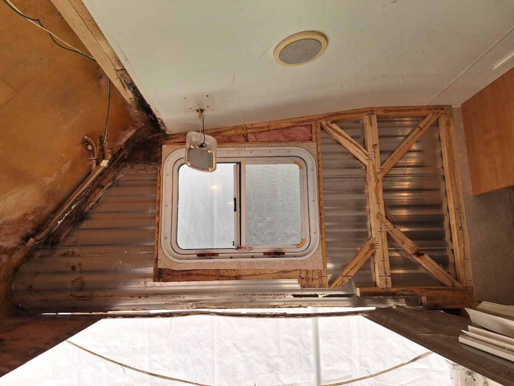

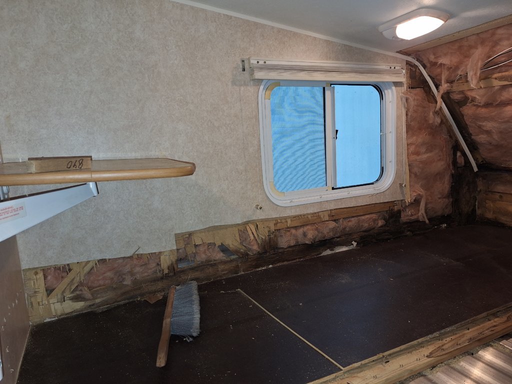

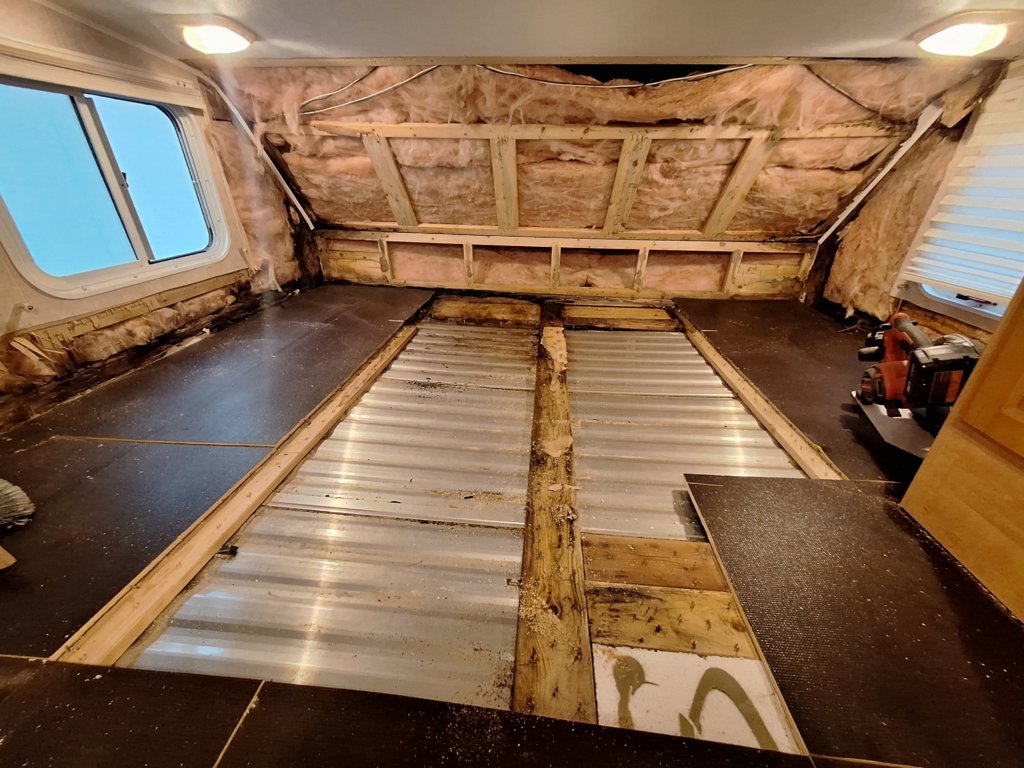

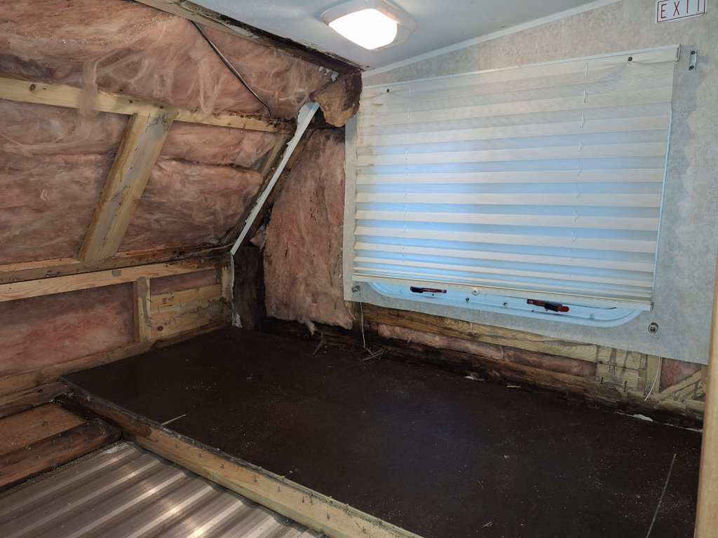

    More demo. My plan right now is to piece PT 2x4s back in, but then sheath both walls with quarter plywood instead of just paneling. I think that will be enough support for it to last at least this trip and hopefully a couple more years.
    The rot in the ceiling corner may have to wait for another time. The truss is still in decent shape and i dont think the roof is leaking anymore. It's lower on the priority list atm.

    Will it shed water? If so....rock it.
