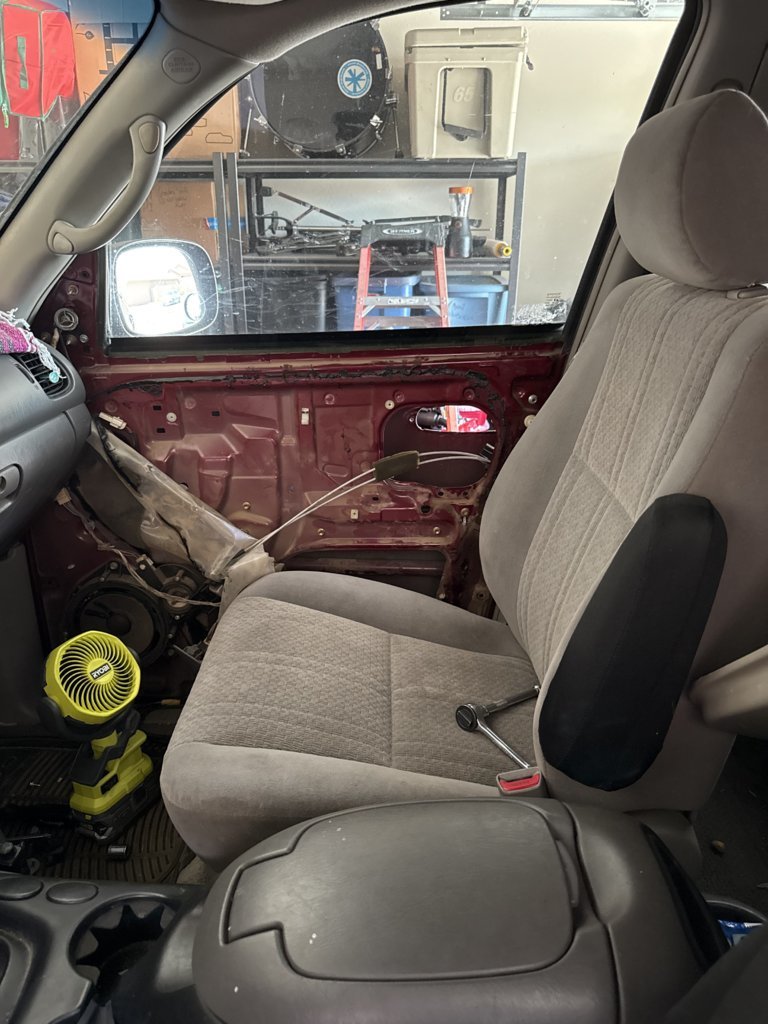

    Revamping this thread because I'm in the same pickle. I replaced the actuators on both driver and passenger side today. The driver side worked for a couple of minutes but then started locking and unlocking back and forth without stopping; I checked all the wiring and couldn't find a short anywhere, so I figured it was a bad actuator that got delivered so I put the old one back in while I wait for a replacement. I then tackled the passenger side and everything worked perfectly, I checked the handle on the inside and outside, made sure everything locked and unlocked, put it all back together and then shut the door.... Well, then the actuator decided to lock the door without pressing the lock button and the passenger door is completely locked with the interior panel on. I was able to dislodge the panel just enough to get my arms in and play with the rods, but pushing them down to unlock wasn't doing anything. I've been at it for over 3 hours and decided to take a breather for the night before I break something else. I'll take a closer look at everything tomorrow.

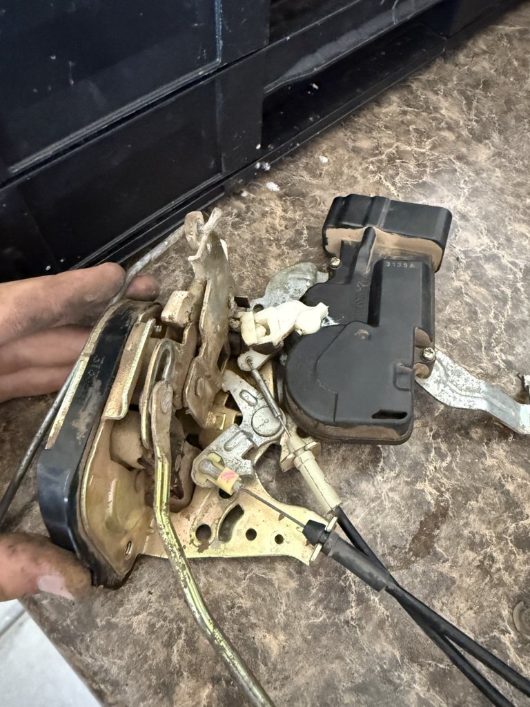

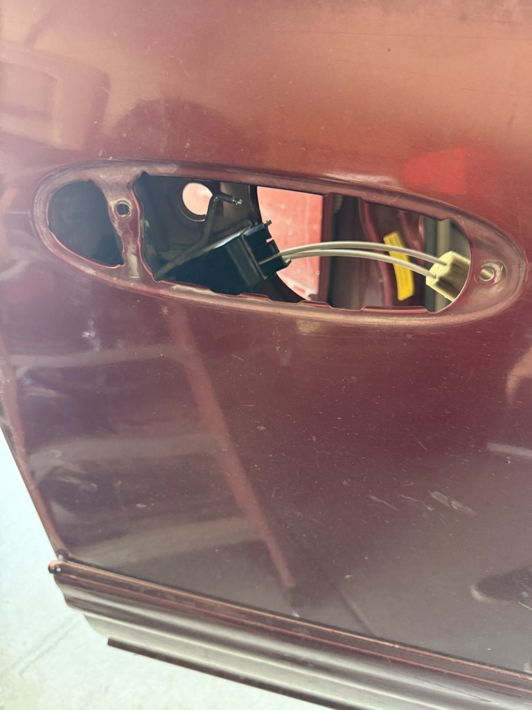

    I was able to get the door panel off by unbolting the seat and moving it into the back seat, which allowed me to take off the door handle IMG_3004.jpg

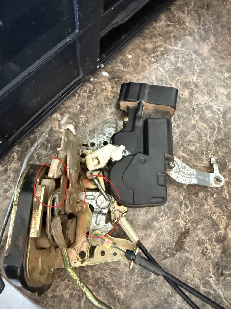

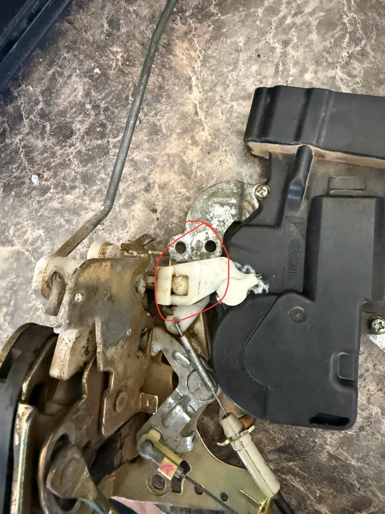

    then the actuator is controlled by a ball that rotates to open and close the locking assemblyIMG_3006.jpg the inner door handle is pulled by a wire which pulls the silver piece back and hits a wheel that pushing the lock open.
    The door was stuck because the ball was stuck in the locked position. To open it all you have to do is push down on the locking rod with one handle and pull the inner handle (or if your handle was broken like mine, you can pull the metal wire inside the black tube) and it forces the actuator to unlock and then opens like normal
