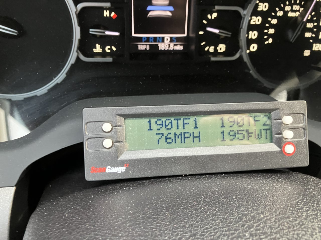

    I just use a scan gauge 2 and you can add a speed option and adjust it by percentage off. Works great since I monitor transmission temps and engine temp.
