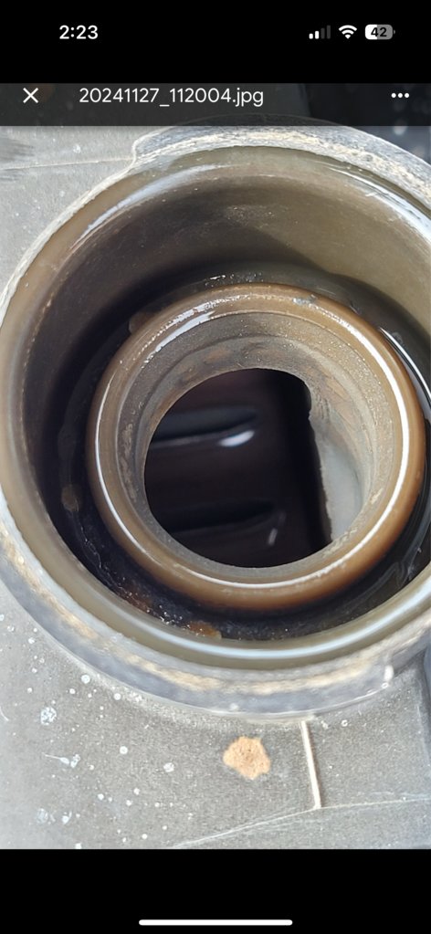

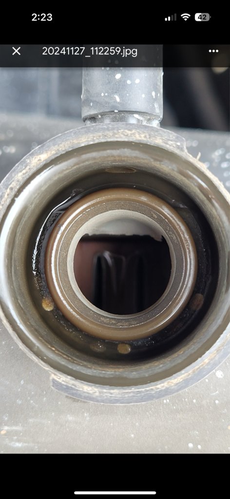

    04’ Tundra. Seller says timing belt/water pump were replaced about 40k miles ago. Says the coolant is not rust colored, it’s pink
    Transmission fluid looks alright to me but owner is unsure of when it was last changed and he’s owned it for about 40k miles / 5 years so I’d replace it just because if I bought the truck

    I mean, it's hard to get a read, but the fluid looks like typical trans fluid, still ruby red, not garnet or burnt. Coolant, for how little it costs to get ~3 jugs of pre-mixed SLLC pink from Toyota, you may as well just drain and fill the coolant when you get it. Same with the transmission. Even with unknown history, there's little risk to doing a simple drain/fill on the transmissions used in our trucks. Just make sure you get the correct fluid. 00-02 uses ATF DexIII. 03-04 uses T-IV. 05-06 uses WS.

    Thanks for the info! I was not aware of the transmission drain and fill being an issue on these trucks. I know flushing them can cause issues but just a pan drop, filter change and new fluid could cause issues?
    everything else checks out with the truck including the rust (south west truck)

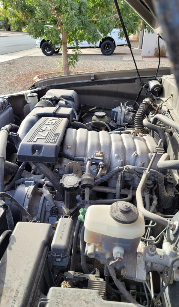

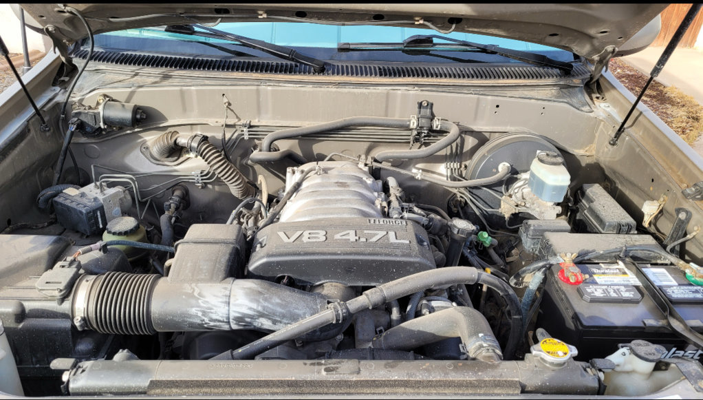

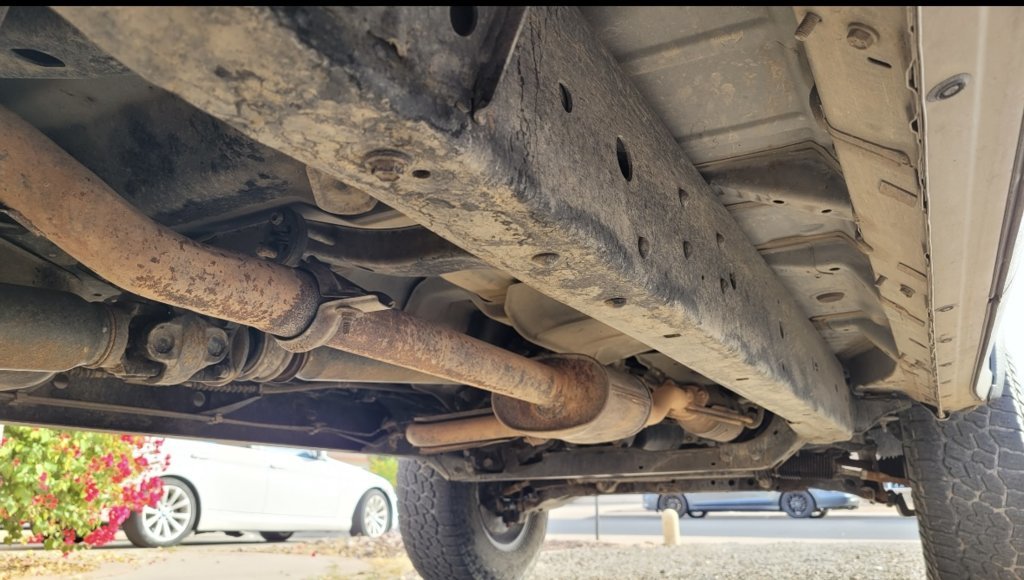

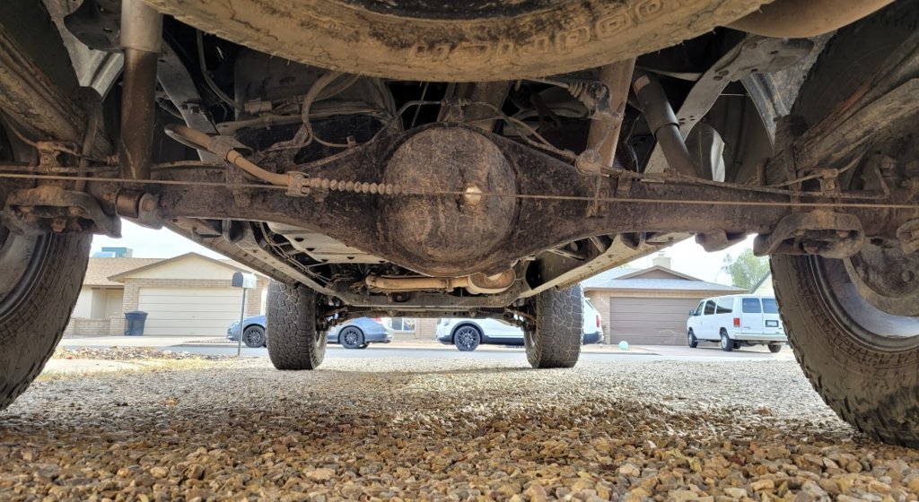

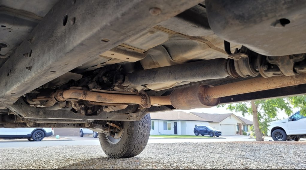

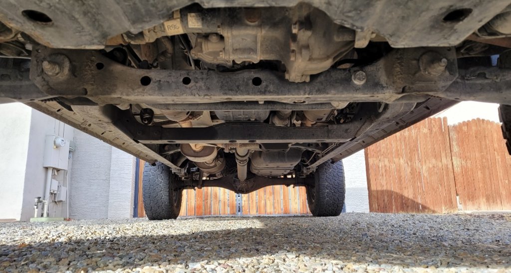

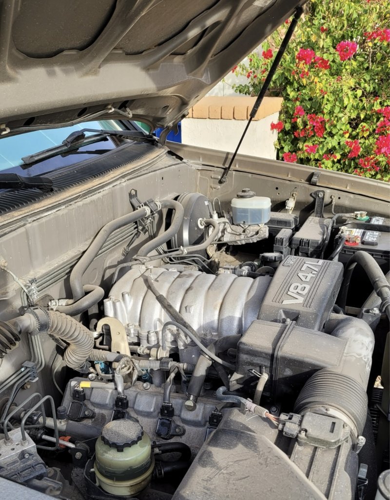

    thanks for the info! While I got you, you mind confirming my thoughts on the frame? Engine bay pics just in case something looks out of line. Haven’t seen the truck in person, it will require me to get a plane ticket

    Frame looks to be in good shape. Not seeing any of the typical delamination, bubbling, or flaking as so often seen. Looks like the inner CV axle boots are slinging grease. They might be OK, or they could be dry. Can't tell from the pictures. The rear shocks are mis-matched and the driver's side is shot. It's leaking. I would have to assume the fronts are in similar disarray. Not a big deal, suspension is pretty easy to replace if you have some mechanical knowledge and common sense. Couple of observation in the engine compartment: Brake fluid looks old and dirty. Will need to be changed. There is coolant spray and crystalization indications in the engine compartment. Could have been an old leak, could be currently leaking from somewhere. Would probably recommend a new radiator. Along those same lines, there is no indication of the timing belt and water pump being recently changed. Will be best to have those done, and replace the radiator at the same time. Looks like some of the ignition coils have been recently replaced on the passenger side. I'd be cautious of this. Why were they replaced? I do think it's in decent condition, but might need some love. What's the asking price?

    appreciate the in depth response!
    The Denso radiator looks to be only about $150 so may be good to just replace that since I wanted to replace the coolant.
    Good catch on the crystallized coolant, not sure when/why that wouldn’t have happened if the radiator is still functioning
    owner said the previous owner did the timing belt and water pump at 204k, about 40k miles ago (about 6 years ago). I was reading the thread referenced above and it sounds like I can do a simple check to see if it has been done?
    when you say inner CV slinging grease, are you referencing the cam adjustment spots on each side of the frame (lower control arm bolt) that are greasing? I had thought those were areas that get greased with a grease zirt?
    On the ignition coils, owner replaced the spark plugs, maybe that would explain the some new indignation coils?
    Here’s another picture from the drivers side, any additional thoughts?
    At this time I’m worked out a deal at $7500, in my area I think it would be worth a bit more which is why I’m willing to fly to get it. Clean title

    You can use all of this to negotiate the price down. Use typical shop rates, so get quotes for the radiator, timing belt and water pump. If there's no "Aisin" sticker under the hood anywhere showing the TB replacement mileage and date, or if there is no shop paperwork, be wary. Just because he says doesn't mean that it's so. There are no grease zerks on the LCA cam adjusters. That is for sure a loose or broken CV boot. Again, use it to negotiate the price down. It could mean new CV axles, or it could be just new clamps and grease. It's ok if the PO replaced the ignition coils, but why only a few? Usually once one goes, all are ready to be replaced, and best practice would be to replace them all. And, only with Denso. I think at $7500 you're probably doing OK. Just know you're going to need to put some money into it, but overall it seems pretty solid. Always tough to gauge from afar.

    RE: Radiator can still be functioning, but it looks like the radiator cap blew based on the height (and cutoffs) of the spatter/spray patterns.. Radiator needs replacement, the top cap is miscolored/faded, a sure sign of age.
    That brake fluid is dirty as shit and needs to be fully flushed.
