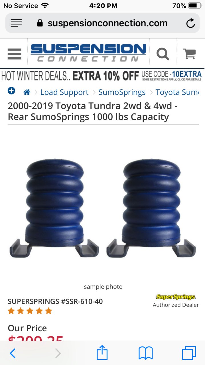

    I have these but I think they are 1500 pounds just have not put them on yet CE437E1A-23DA-4E31-9AD2-EFB2526153FC.jpg

    Who installed your lift?
    Do you carry much weight?
    If the springs are bad the Sumos are just a bandaid.
    I don’t think you’re looking at a catastrophic spring failure, but I’d get them replaced sooner then later.

    Your springs look very very flat. Some of the newer trucks seem to have some bad springs. Unfortunately big lift blocks are just going to kill them faster. Lift blocks are a poor way to lift a truck.
    Lift companies use them because it’s cheap
    If i was you i would return the sumo springs and use the money towards a full custom leaf pack

    When the leaf springs have a negative arch (like the picture shows) it’s time to replace them.

    Thanks guys. I had the same shop that put my lift on does the dealership uses. I am not going to put any money in it. I will carry it back to the dealership. They told me that it will be fine to tow my 5000 pound boat with my lift. If not I will trade out. My out town trip has been cancelled due to the Hurricane coming in. So I will talk to them come Tuesday.

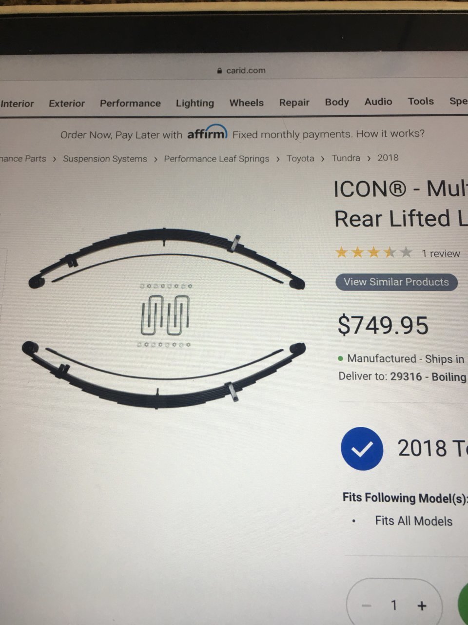

    So should I upgrade the springs? Also has anyone used these before. I will still have to use a block. image.jpg

    Those springs don’t give 6 inches of lift. You need custom.

    A custom spring pack will suit you very well. It will handle better and you can build it to your desired height.
    Blocks put a ton of leverage on the leaf spring. When you press the gas, the axle wants to twist. Our leaf springs are pretty weak (compared to how thick they are on a 1 ton truck for example). We also have a ton of power. So when you add in a lift block, the axle can now really put the twist on the spring. This constant stress wears the springs out faster. It does seem like the gen 3 springs wear out quicker. Maybe toyota softened them up in 2014?

    This kit is great, however, will only provide 2.6" of lift (unloaded) in the rear. Like someone else said, you'd need a custom set to get the full 6" that you need. That's the best way to go though, to replace the whole leaf pack. I'm in the process of trying to decide what to use to lift my Tundra, but I've lifted countless Jeeps and always prefer the full leaf pack vs. blocks.

    Actually that pack has an option to go 4” unloaded. So that plus the Coachbuilder #3 shackle will get you almost to 6 inches.
    http://iconvehicledynamics.com/shop...ta-tundra-multi-rate-rxt-leaf-spring-kit.html
