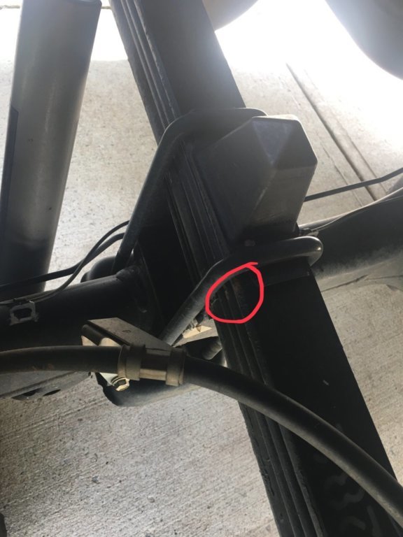

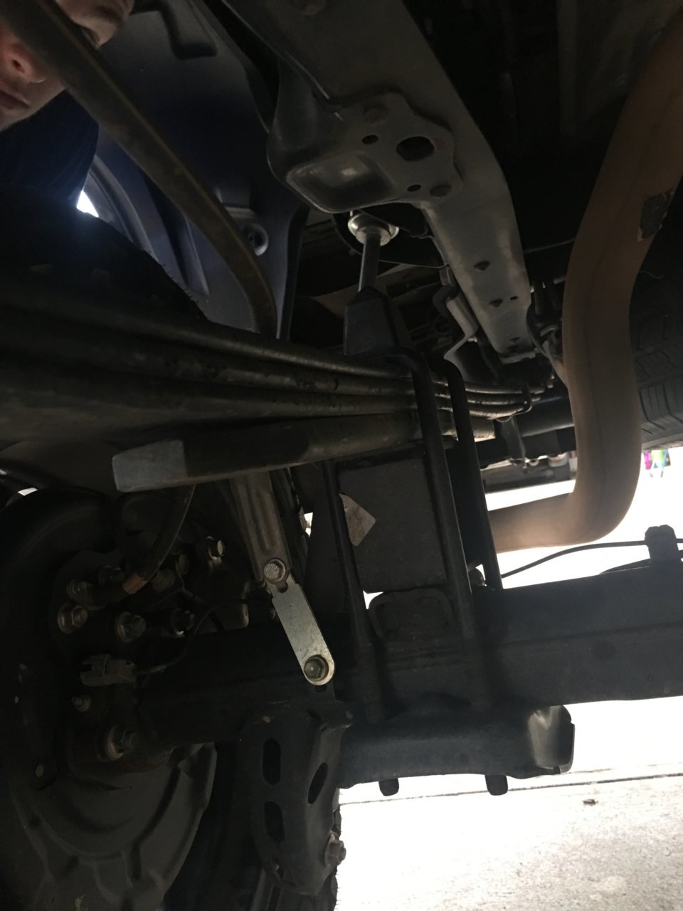

    I zoomed in to the passenger side and it looks like the leafs spring is broken. Give that a good look.

    952C1229-30CE-4391-9ACE-F3F674578D2A.jpg I think it maybe my springs. What do y’all think?
