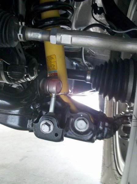

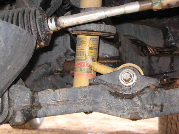

    How Coilovers Work 101
    A coilover assembly has two major components, the damper itself (shock) and the spring surrounding said damper. As an assembled unit, a coilover will not change over all length at full extension. The upper and lower mounts of the assembly are a fixed extended distance (it can't get any longer regardless of preload).
    There are several ways to add ride height to your vehicle with preload depending on what kind of coilover you have. With a stock coilover, you can add a preload spacer. With aftermarket like Bilsteins you can set the lower spring perch mount higher. With tunable and rebuildable coilovers (such as King, Fox, Icon, etc.) you can add preload by adjusting the preload collar. With any of these methods, the overall mount point length of the assembly DOES NOT CHANGE. The truck will sit higher because you've preloaded the coil assembly. Spring rate with stock and aftermarket coils are a constant. Meaning if you had a 600 lb/sq in coil spring rate, and you added 1" of preload, it would take 1200 pounds (left and right coilover) of additional force over the springs to bring the truck back down to stock ride height. "Smoother ride" is completely subjective as it depends on terrain, driver preference, valving, unsprung weight, sprung weight, etc. etc. etc. But when you preload a spring, the spring will always have some stored energy. The amount of stored energy is directly proportional to how much is preloaded (Hooke's Law). That additional stored energy in a preloaded assembly is what subjectively changes the perceived ride quality. I personally think the stock springs are too soft for anything other than street use.
    Coachbuilder "shims" are commonly referred to as top-plate spacers everywhere else in the word. A top place spacer is added on top of a coilover assembly. Meaning you will physically be increasing the overall length of the assembly. This is the key difference. A top plate spacer in essence makes the coilover longer. Meaning if everything else stays the same, you will push the LCA lower with a top plate spacer giving the vehicle a higher ride height. A single CB shim is a 1/4" top plate spacer, and with the coilover working angle on tundras, would equate to just shy of 1/2" of lift. Two shims = 1/2" of spacers with about 1" of lift. Nothing changes with the spring rate or ride characteristics with a top plate spacer (except with factory upper and lower control arms which use loaded (tension) rubber bushings). The tension in the bushings would be increased. Most people's butt-to-shock meter won't be able to feel the difference but those that spend a lot of time tuning can definitely feel the additional tension. Seems like a no brainer right? Add a top plate spacer and you keep a stock ride and get a little lift? Well it's not that simple. By increasing the over all length of the coilover, you are also increasing the length of the coilover when completely compressed. Meaning if you actually get your truck dirty, and get into a full bump situation, your coilover will bottom out before your factory bump stops. Meaning the shock itself becomes the new bump stop. Here are some of my favorite examples of what happens when the shock is the new bump stop:
    Now if you're strickly a mall crawler, maybe you never run into the situation. An easy band aid is to add bump stop extensions to your stop bumps. But then you are bumping earlier than with stock geometry and yadda yadda yadda.
    So...it's up to you what sacrifices you want to make now that your informed. Up to the owner to figure out what's going to work for you, your rig, and your driving style and terrain.

    IDK, im a bit skeptical. Are two quarter inch spacers really going to lead to this type of damage off road? Maybe at very high speeds, but even yes, i still doubt it.
    But hey.. im wrong a lot, so if i am , let me know ;)
