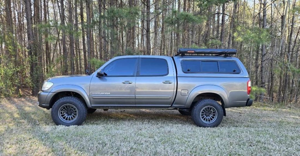

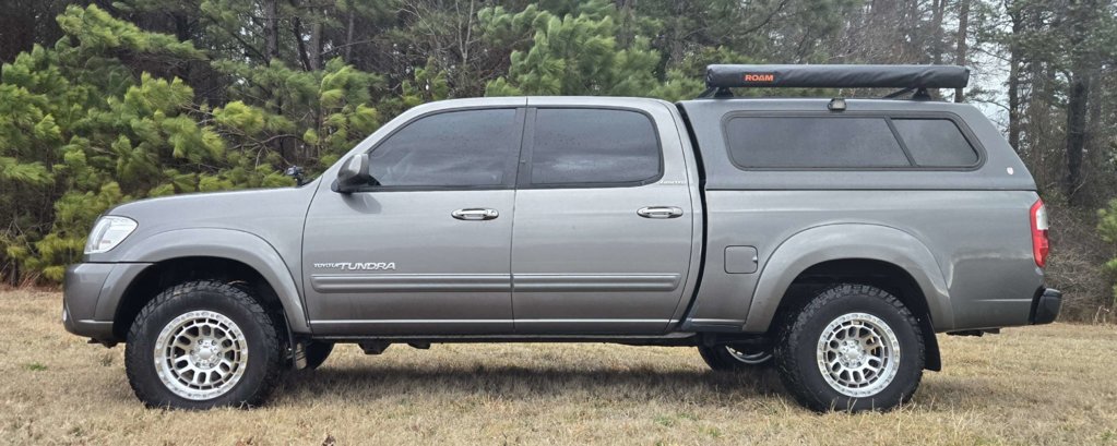

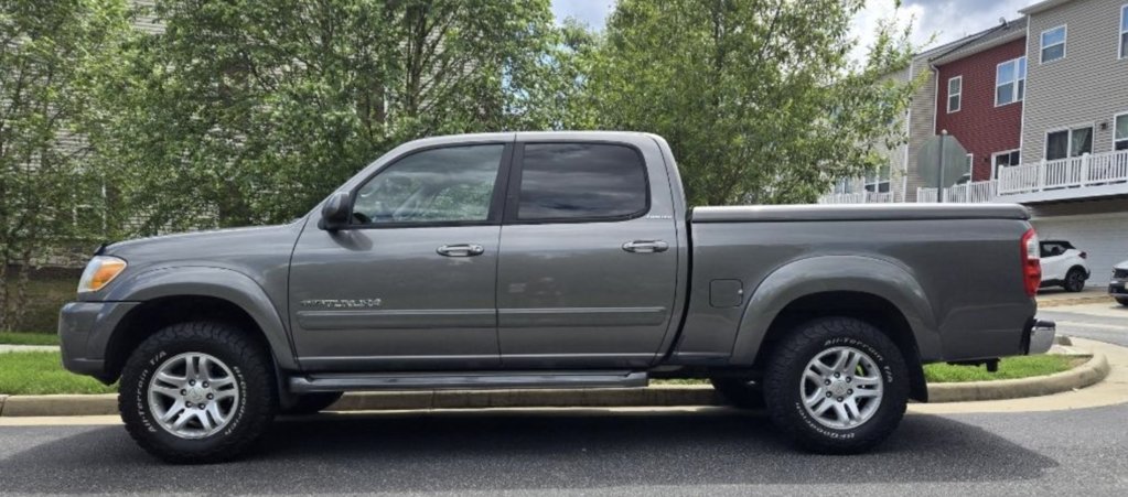

    Going in for a re-do. Icon Stage 1 maxed preload based on the instructions in the front...177k tired leaf packs in the back. Freedom UCAs, extended end links in the front as well. Sits at 21" front and a hair over 21 in the rear. Topper and 175lb drawer set up in the bed. Perfect stance just not the height I'm looking for. Contacted Accutune and Alcan for some advice. We'll see what happens. Pic 1 is when I first bought her...heavy ass grandpa hard tonneau on the bed. Pic 2 was yesterday. 265/70/17s in both pics.

    Are you looking for more height? Are you planning on sticking with that tire size?

    Damn. That thing is sexxxxxy AF

    Agreed. What wheels are those? @wtrbrdm ?

    Should be going under the knife in 2 weeks or whenever I get a weekend free. Waiting on the final items to come in slowly.
    RRW RR7-S with 275/70/17s
    Radflo front coilover
    Durobumps
    Fr33lanceFab gusseted spindles with extended lug studs
    CVJ Axles and fresh oil seals
    ECGS needle bearing delete
    Already have Freedom UCAs, extended links, OEM LBJ and LCAs installed
    Radflo rear shocks
    Archive Garage MD leaf packs
    Archive Garage u-bolt flip kit with #4 bumpstops
    GX front calipers
    Advics rotors
    Akebono pads
    Fr33lancefab Wildwood LSPV delete
    Front and rear stainless brake lines
    Should be a fun weekend. Gotta install the Weboost, fridge slide and other odds and ends in too. I need a different hobby.

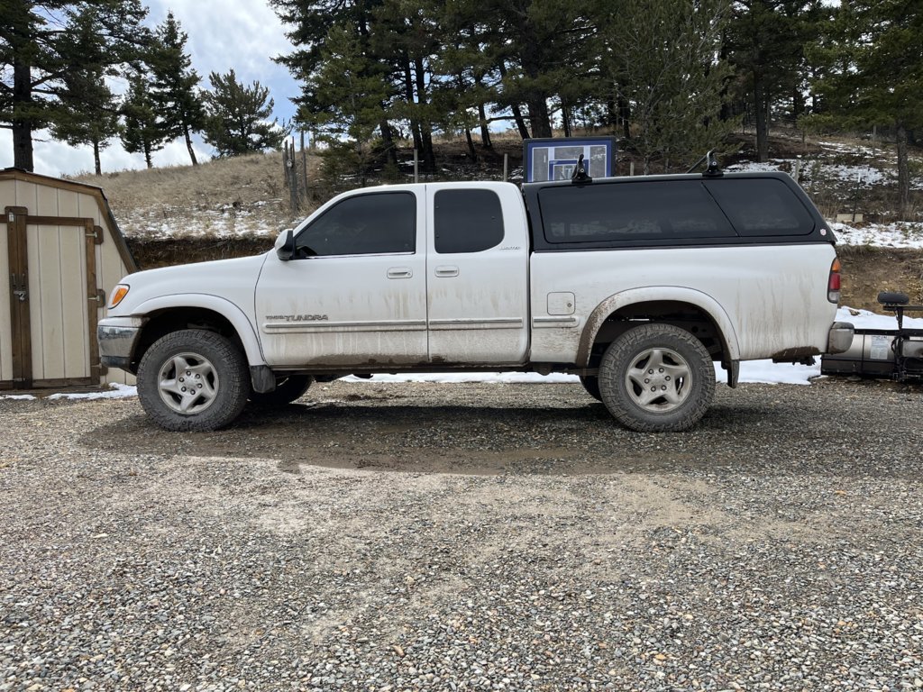

    I don't think my measurements are very precise, but here goes.
    Before suspension work:
    Front hub to fender: 20.5"
    Rear hub to fender: 20.5"
    After suspension work:
    Front: 21" (passenger side 21.5")
    Rear: 21.5"
    This is after some settling, but only a few days.
    Suspension work:
    Front: OME 2883 with Bilstein 4600, + 1st gen offroad 1/4" spacers
    Rear: ATS HD leaf springs with Bilstein 5100 and Total Chaos 3/4" lowering shackles
    I don't really even feel the need to stuff bigger tires in there to fill in the space. Really just slightly lifted the whole truck, probably not even perceptible to the untrained eye.

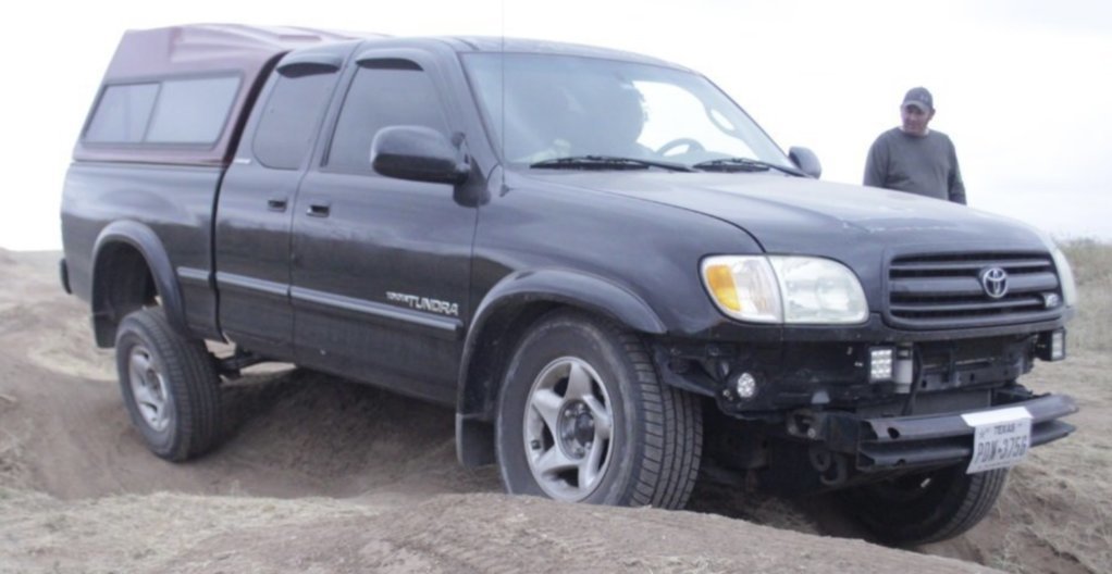

    Imma keep it stock
    2000 5VZ 2WD AC
    2885 with 4600 front, 5100 and 1" leaf blocks rear. with Sumo Springs
    LF 24"
    RF 24"
    LR 23.5"
    RR 23.5"
    Most recent pic...

    Those fuckin wheels dude.
