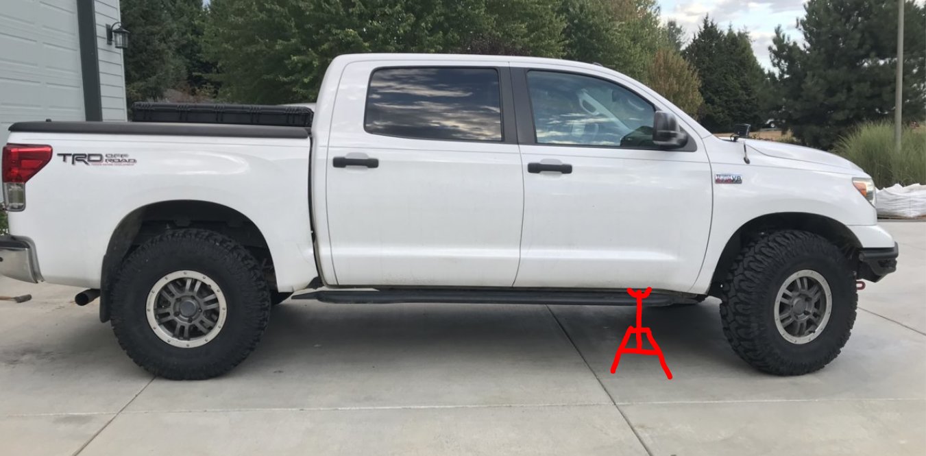

    I want to do a tire rotation and I can’t figure out how to get the front tires on Jack stands. If I Jack it up from the LCA I need another Jack since there’s nowhere to put stands.

    I got a set of 6 ton jack stands that have a ~26" max height, I jack up the truck from the lower control arms like you are saying and when I max out the floor jack I put the jack stands on the frame under the driver and passenger door, and then I can let the truck droop out just fine (not sure if the 3rd gen frame has a good spot in that location or not). Or if I am feeling lazy I keep a foot long chunk of a 4x10 that I put on top of my floor jack that makes it tall enough. But that is sketchy... so I don't do that often.
