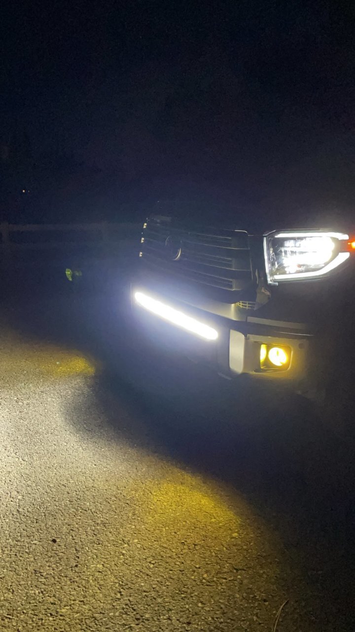

  13. Sep 3, 2021 at 9:04 AM
    #43
    memario1214
    memario1214 [OP] Hotshot Offroad Staff Member Vendor
    Dec 13, 2015
    #2252
    12,757
    Colton
    Missoula, MT
    '21 Limited MGM CrewMax
    Diode Dynamics SS42 light bar INSTALLED - Driving pattern is admittedly not the ideal pattern to go down low, but I'll be swapping lenses anyway :cool:
    No glamour shots at the moment, but they'll come eventually!

  14. Sep 3, 2021 at 9:10 AM
    #44
    infidel
