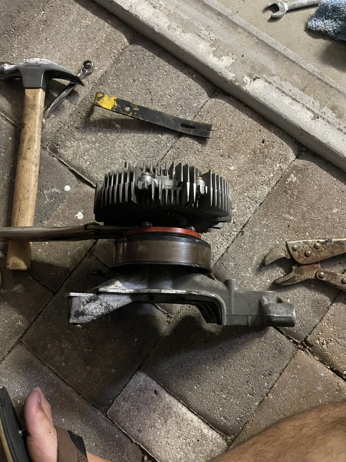

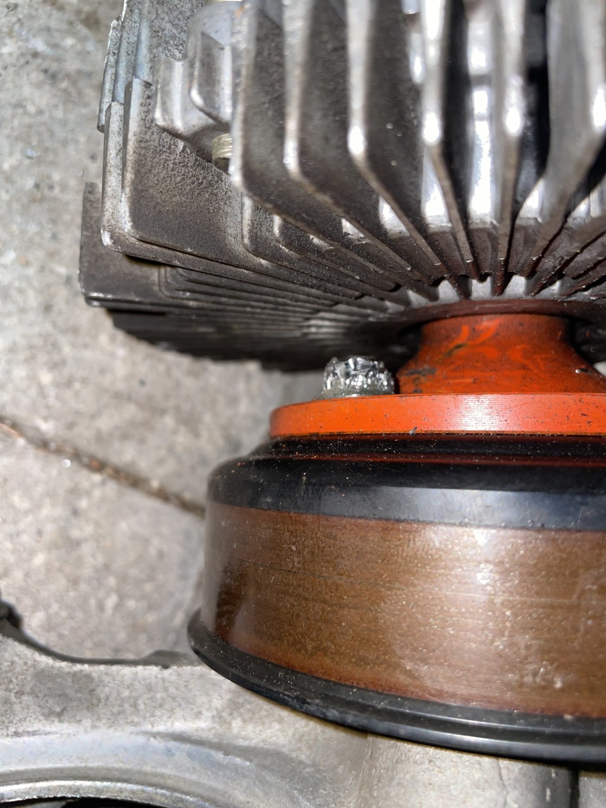

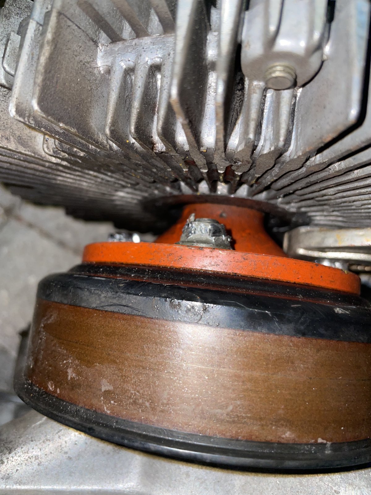

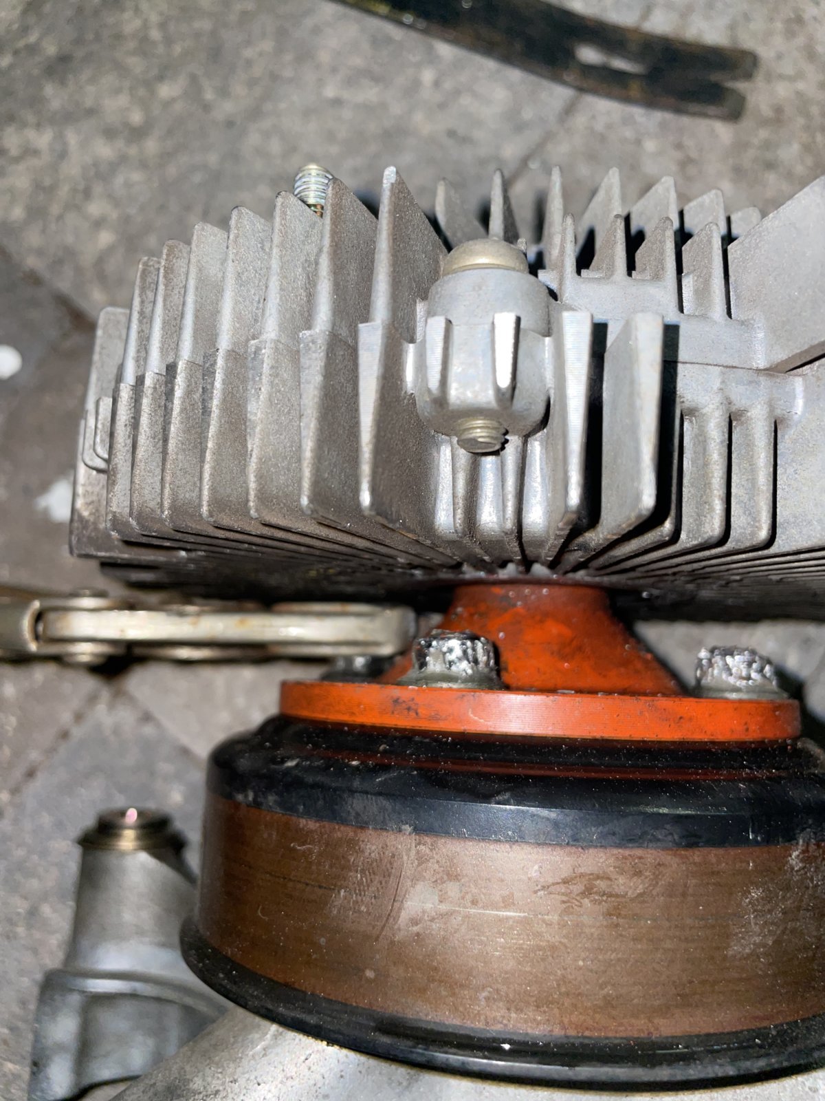

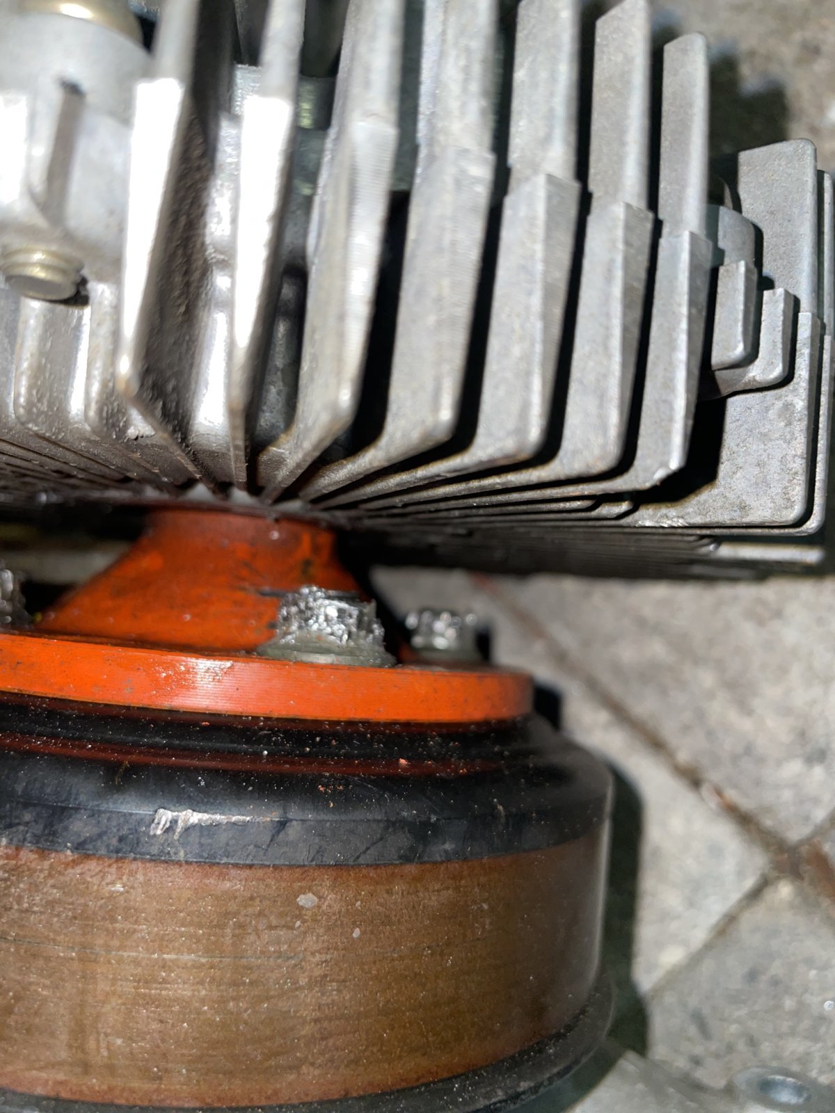

    Currently doing my timing belt on my new to me 2000 Tundra AC and ran into an issue with the fan clutch. First time doing this job. I tried taking it off the studs while they were still on the engine block to no avail, so I took off everything I could to continue the timing belt job, sprayed the bolts with PB Blaster and let it soak for a day. I eventually got the fan bracket out since it was necessary.
    After that I thought I’d be easy peezy, I got a torch, two vice grips and more PB Blaster. Plan was to spray it down, heat it up, let it cool and go ham with both vice grips. You’d think that would work? Nope! Didn’t even budge once on any of the bolts no matter what I did.
    I was going to replace the bolts after I got them off anyways since I knew they weren’t going to be salvageable, but looks like I’m all out of ideas. Any advice from here on out?

    Wow. You gave that a proper mangling.

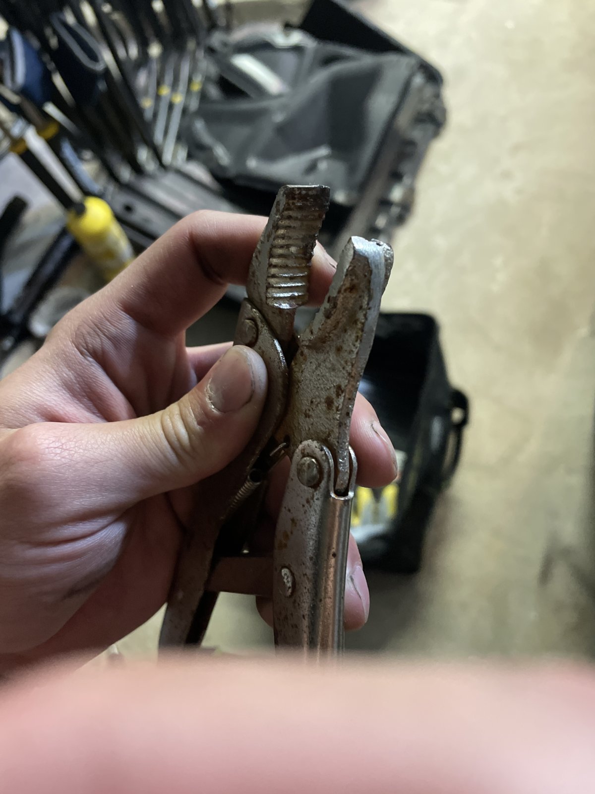

    I actually broke a pair of vice grips when squeezing one of the bolts. Unreal how seized the bolts are. The rest of the job has been pretty smooth aside from he AC Compressor bracket screw being striped and seized, but took me about 15 minutes to figure out

    Angle grinder with a cutoff wheel then replace the pulley assembly and fan clutch nuts.

    Use a file and try to grind flat spots on the nuts again. Try to heat the nuts up with a torch, then have at it again with the vice grips. Or, try a nut splitter.

    I think you're going to need something a little bigger than a Dremel. You'll never be able to get a flat, straight cut with such a small tool. You're going to want to be careful not to damage the fan clutch flange.

    You’re probably right. I completely forgot they’re bolts and not nuts, so I need to use something bigger. I should have an angle grinder lying around, but no vice to hold it in place. I’ll have to ask a neighbor or something

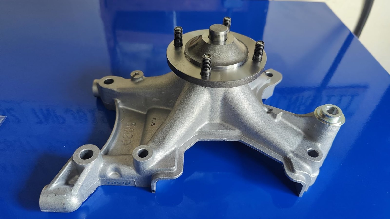

    You have stripped nuts, not bolt heads. The fan pulley bracket has studs that stick off it.
    Have a look at this tutorial on a nut splitter:
    https://www.youtube.com/watch?v=Yb_lFOCU6IU

    Gold. Gonna pick one up tomorrow along with the 22mm impact gun socket I need to do the timing belt tensioner

    Wouldn’t it be easier to just cut the nuts off and replace the studs or are those included with the fan bracket part?

    The studs are pressed into the OEM fan pulley bracket I believe. I don't think Toyota sells just the studs, but I'm sure someone motivated can get around that.
    The threads on OP's fan bracket studs should still be fine though, so long as he doesn't damage them with a nut splitter or whatever else is used to cut the damaged nuts off.

    Yeah going for the nut splitter approach and then going from there. If the studs get damaged I'll have to get a new fan bracket, but oh well. For the price I got the truck for, I'm more than okay getting some new parts for it so I don't have to worry about it for 15-20 years like @shifty` said.

    This would actually be a good candidate for the bolt induction heater as @vtl suggested. Just need to potentially size up with a slightly larger wrench when the nut expands. Good cause for having an SAE set on standby in case it runs between metric sizes.
    The nut splitter and potentially replacing the fan bracket may be cheaper in the short term though.
