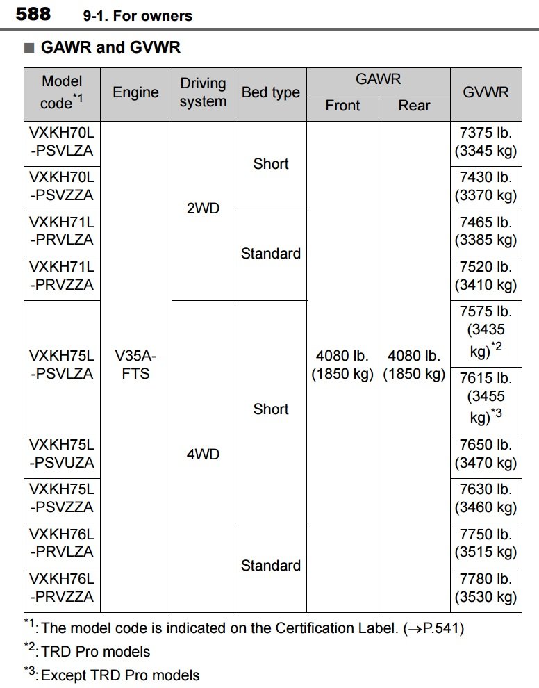

    Sorry guys, this is effectively a 70 series Landcruiser, not just a Prado. It's built to take a load. If you're not carrying a load, just air down the rear tires.
    For Toyota Newbies, there are 70 series (real) Landcruisers, then there are (lightweight) Prados. Here, literally, is a page out of my manual. (I have a 75)
