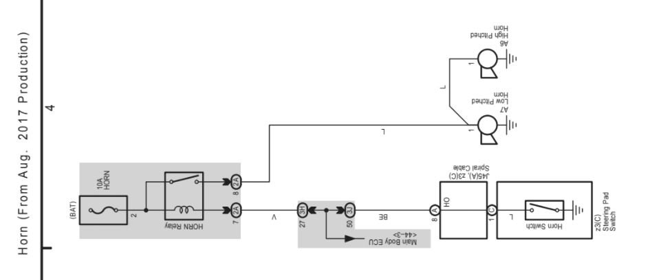

    This could help. A little newer than what you have tho

    I have the older version of this but it doesn't show any of the routing. Only difference between this one and the one I have is that my 2011 drawing shows 2 horn switches. I'm going to check under the airbag to see if the short linking wire might be bad.
