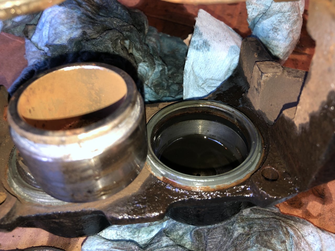

    I’ve taken care of my 2002 Tundra since brand new. Here is what my front calipers looked like last week when I changed them out. I bought brand new reman’d calipers to replace these as it was easier than doing the rebuild myself. 3 out of 4 calipers were frozen.
    Maybe one of your calipers was slightly frozen and your quick braking shocked it and blew it against the brake pad and froze there (seized) until later? Lots of corrosion in my caliper chamber and those rubber seals inside wear out over time. Something to consider.

    Wow thanks for the info! I suspect you guys are right about the brakes and I've been thinking they need to be done before this even happened. But would this explain the problem with the engine not wanting to rev? it was like I had no throttle response to the input I was giving until it shifted and now it seems to have gone away.
