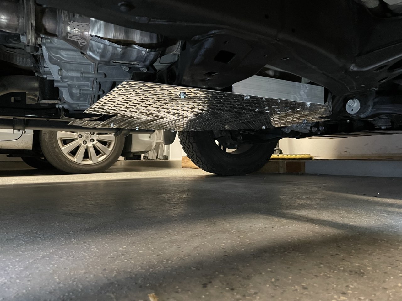

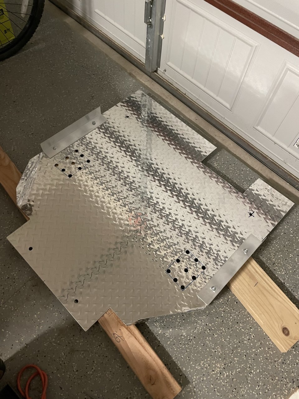

    After a negative experience with Valhalla's, I was forced to build my own for an upcoming trip. I built this for my 2018 Tundra from $200 supplies from HomeDepot:
    The supplies included a rivet gun where I added rivets to the angle sections that were also attached with bolts.
    HomeDepot was the only store with the 3x3 Aluminum Diamond Shield.
    Let me know if you need any dimensions. I used long vice grips to do the two bends. I would have liked about two more inches on each side, so I may also do a steel build and powder coat from local vendors, but this helped me sleep better during my trip up to Dallas.

    Very nice! Dimensions would be great. Interested in doing this myself
