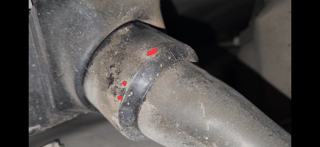

    See photos... used a smoke machine to find 4 pin holes in the fuel filler neck. They are perfectly round and are all in a line (line beads on a bracelet), but not evenly spaced. Getting evap leak codes out the wazoo... are these holes supposed to be there? Screenshot_20241017_215232_Gallery.jpg Screenshot_20241017_215146_Gallery.jpg

    Is that the steel filler neck or a rubber isolator? If the latter, the holes are no issue. If the former, than no, should not be there. System is sealed and the only place for vapor to escape with the engine off is the vent line.It looks like the filler neck, but hard to tell from a pic.

    It's all steel. I know removing it and installing a new one is ideal, but if I just used a fuel friendly filler to "caulk" the pin holes, would that suffice?

    JB Weld

    This is what I would use. However, it is critical to sand and degrease if you expext it to last long term. That said, if there are three visible holes, there could easilly be a fourth you are not seeing. Might be worth the time to pull it out and examine.
    Do NOT just fill the hole. Need to leave a small blob on the surrounding area for adhesion.

    Test the theory by applying a sealing tape over the holes and resetting the codes. If they stay cleared, likely the issue and you can strategize your permanent repair.

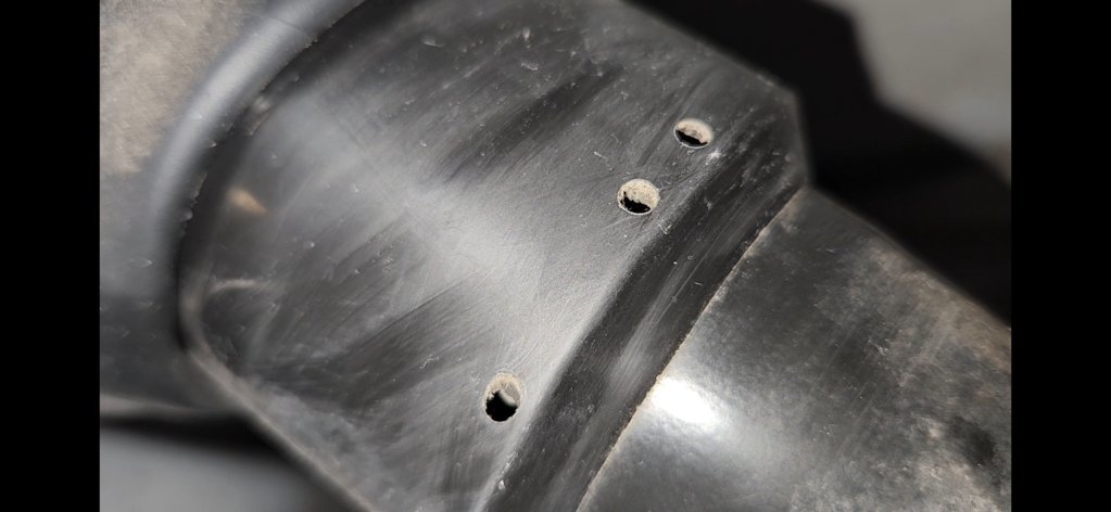

    So, I cleaned the filler neck, and these holes look manufactured. Thoughts?? Screenshot_20241029_192120_Gallery.jpg

    #6...do this. Have a dealer order one and compare.

    Are those holes above the area where the cap seals? If so, they would NOT be the leak source.

    Ok, so some dip-sh*t has already replaced the fuel filler neck before I bought it- with a model that is from an earlier year. Somewhat understandable because the one they were supposed to use is like 500 bucks and the one they used is like 100... but come on..... that being said the holes ARE supposed to be there- bloody hell. Anyway, thanks for the input guys.

    So,yesterday I pulled the bed to deal with rot on the bed floor. Noticed that my filler has four perfectly drilled holes in it, just like yours. Not sure I understand why they are there and what they lead to. If they are drilled all the way through, i do not understand how it doesn’t leak and fail the evap testing. Didn’t have the time to stick a flashlight in there to see if they are through drilled, but thought you would want to know. Fyi, i have no evap codes

    Those holes are prob part of the burp system, may keep gas from burping back out of the filler neck when fueling...just a WAG on my end.
