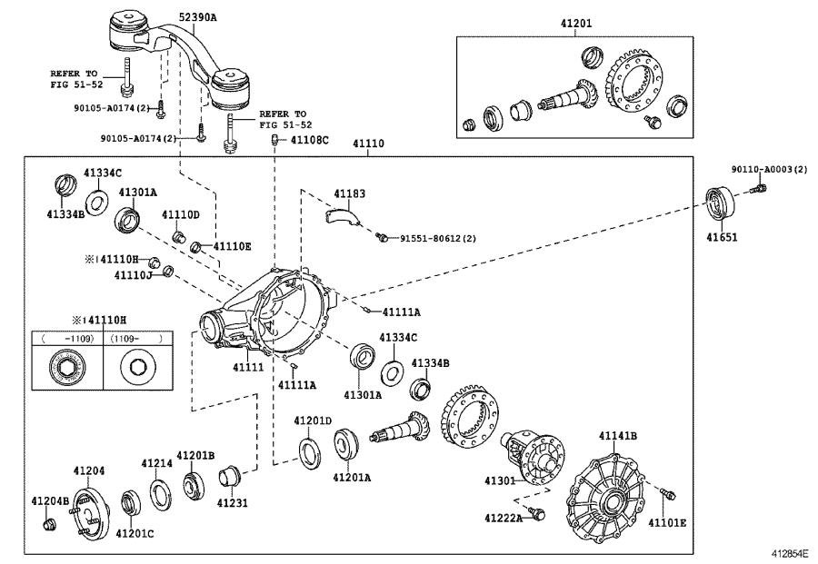

    Is it possible that it's there but they didn't put it in the diagram?

    Think this is the appropriate diagram. Believe the 2021 Seqouoa is independent rear suspension? Rear breather appears to be part number 41108C. Could be hissing from too much pressure inside, or as previously stated, breather is one way, could be hissing (normally) due to lower pressure inside when it cools.
