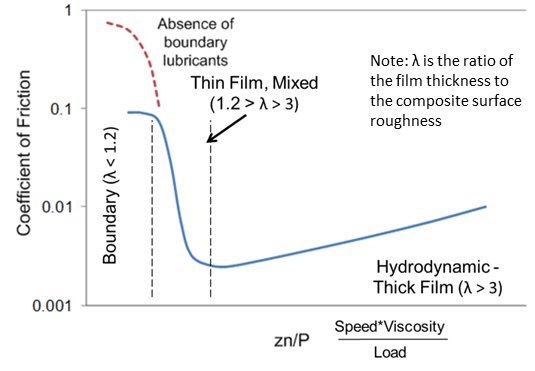

    You are asking the wrong question. We are not talking about high RPM, like 5-7K rpm. Question is 1.5k RPM high low-end torque / load vs 2.5K rpm same load and torque. Which one will have more bearing wear?
    Not sure if you have any engineering background, but if you look at the Stribeck curve you can see that high load or torque with lower RPMs may cause the oil to shear with boundary lubrication. You can see from the graph that increasing speed, in this case RPMs, will increase oil film strength and lubrication.

    There may be some connection there, but may not be so simple. I think thicker oil will protect main bearings more: look what GM recommended in their recent recall for the 6.2 V8- increase in oil thickness. IMO, main cause is stratospheric torque below 2k rpm, which lots of trucks and newer direct injection engines have. Even LSPI happens because of this same issue.
    However, looking at the oil lubrication curve, one can increase the oil film strength by either oil thickness or speed/rpm. Increasing rpm may be more simple than increasing oil thickness to achieve the same oil strength.
    I have 35s on my truck that are about 12-15 lbs heavier per corner and have wider diameter. Some 35” LT tires people run are 70lbs per tire. That is about 30-32 lbs heavier per corner, in addition to the increased diameter. This will further put more strain and load on the engine at low rpm’s, below 2k.

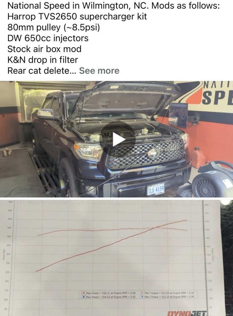

  26. Jul 21, 2025 at 8:08 AM
    #56
    Silver17
    Oct 3, 2021
    #68847
    3,754
    Northeast
    2017 TRD 4x4 Harrop SC
    This is a good representation of that in graph form! I had saved this dyno sheet because it was very similar to my setup, actually a slightly less aggressive pulley selection. It’s definitely an enjoyable torque curve, as in it’s really not a curve at all, just a nearly flat line.
