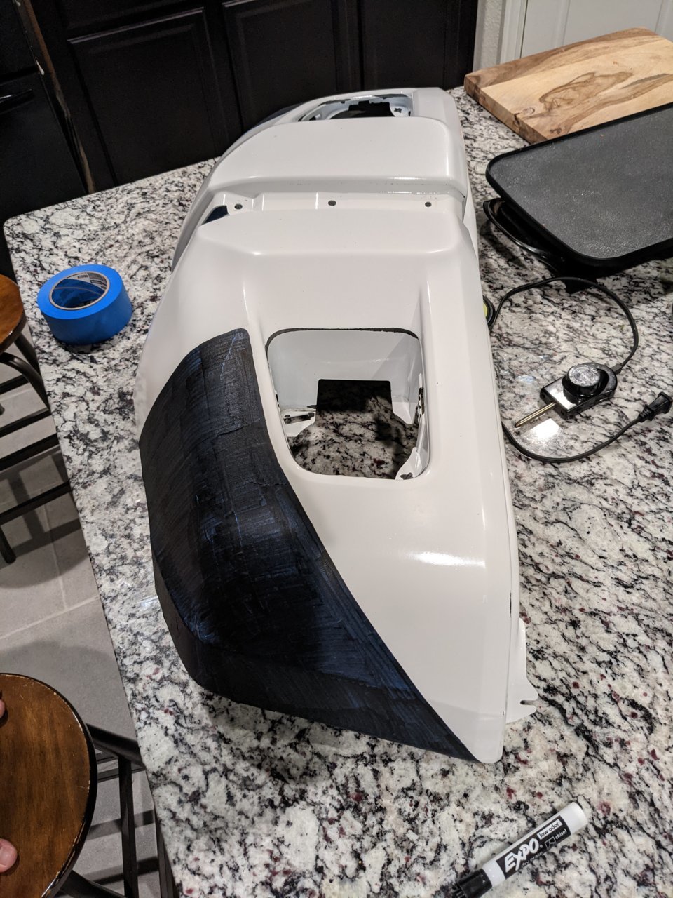

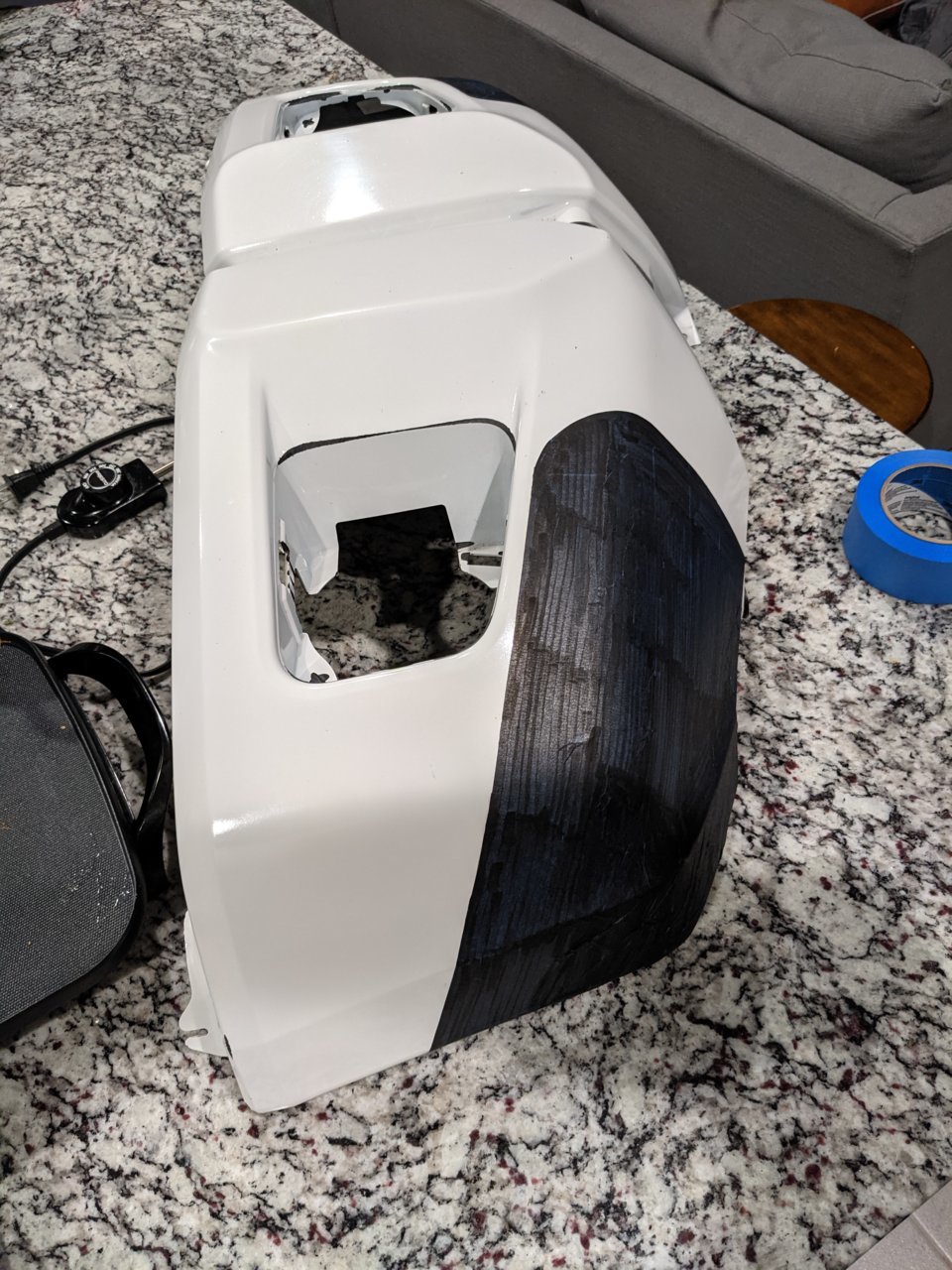

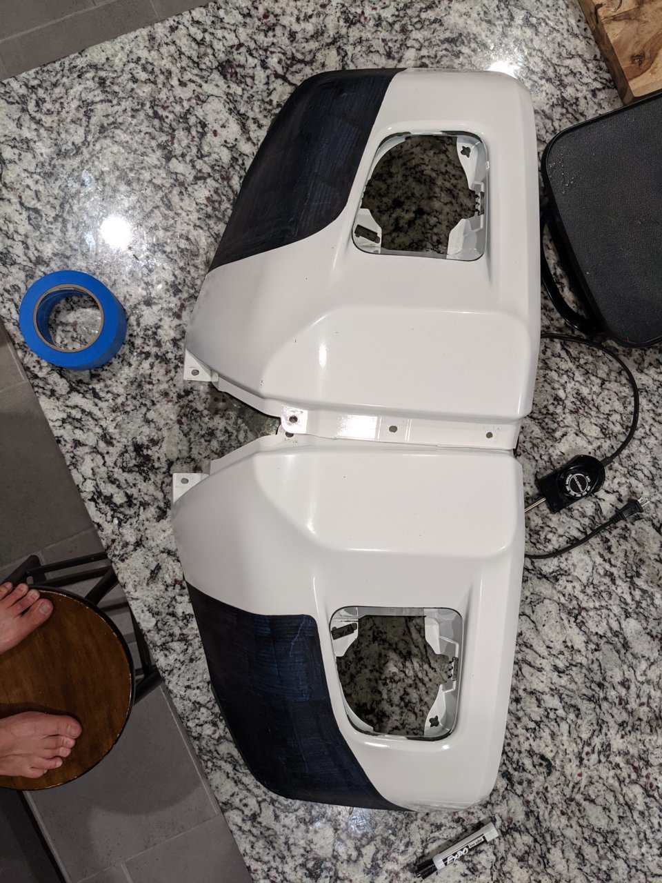

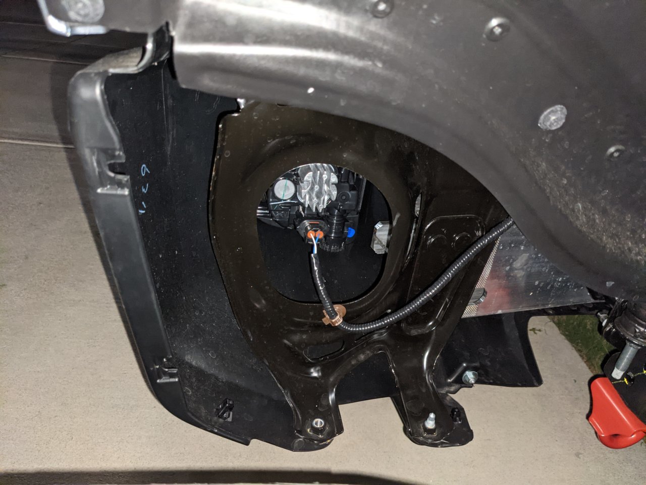

    I got a bumper, starting to put together some ideas...
    AggiePhil and TRDFerguson like this.
  8. Sep 17, 2021 at 8:25 PM
    #98
    TRDFerguson
    Oct 18, 2018
    #20730
    10,698
    Jake
    Southeast Greater Basin, AZ
    2018 MGM CrüeMax
    Do you have a game plan for what you’ll do about the brackets behind/under the caps? If you can keep one lower mount point intact this might work great, and you’ll have to chop out minimal structure behind the fog.
  9. Sep 18, 2021 at 5:10 AM
    #99
    Mr. White
    Mr. White [OP] Poco Loco
    Aug 12, 2020
    #50707
    204
    Steve
    San Antonio
    2020 Family 4x4
    Ya, I was initially thinking about cutting a lot more of the end cap, but I realized that I need to keep the inmost lower mounting point because it indirectly holds the center section of bumper as well. I'll trim the steel bracket where I can, but will be keeping one lower mounting point.

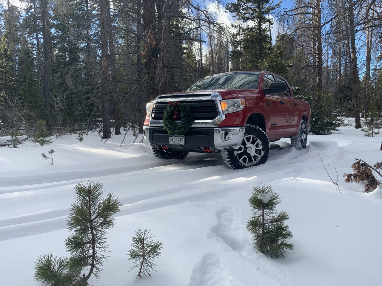

    Doesn't look like this thread ever went anywhere in terms of an off-the-shelf aftermarket solution. But check out what this guy did on his own with a hole saw. From what I can tell, it looks AWESOME!!! Also, it looks like a set of factory new black plastic end caps are only $250 so I may consider buying a set and doing it on those instead of my color-matched ones.
    2mchfun likes this.
  11. Apr 2, 2022 at 4:02 PM
    #101
    TRDFerguson
    Oct 18, 2018
    #20730
    10,698
    Jake
    2018 MGM CrüeMax
    That looks legit. I might have to think about this.
    AggiePhil[QUOTED] likes this.

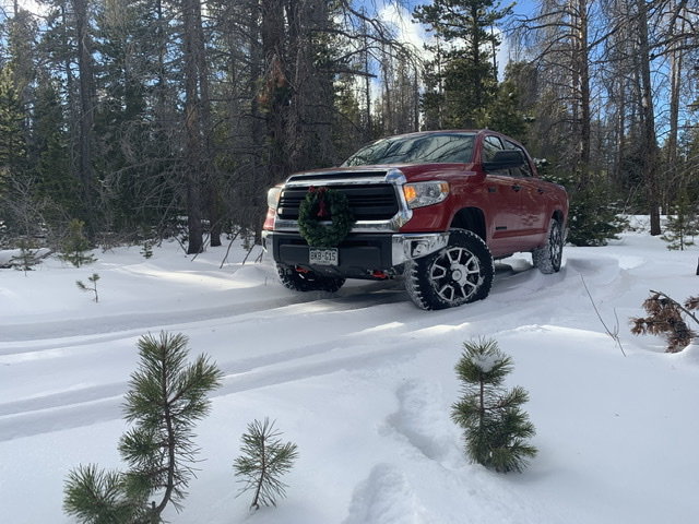

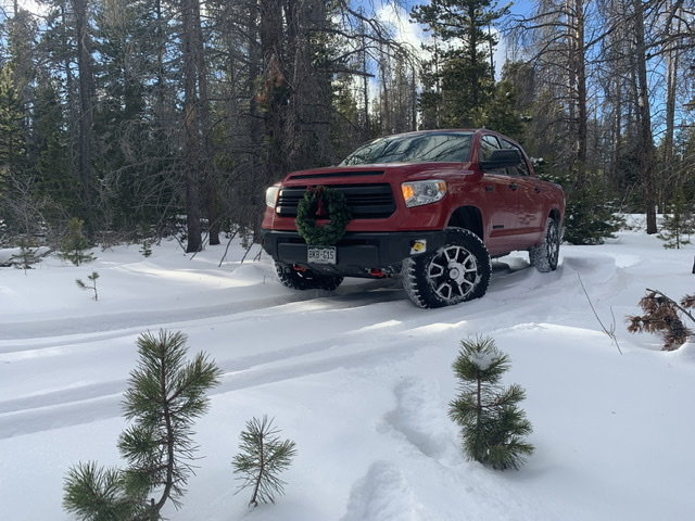

    Not mine but a damn nice looking viper cut.

    Some folks have, since this thread began, made a lot of headway in accomplishing a perfect viper cut for the tundra. It’s apparently a difficult truck to do it on because, in part, the fog location. I plan on doing this mod in the next couple months and I’m wondering if anyone here has developed a true measurement or template to make that cut? I’ve seen one thread devoted to how one guy did his, but I’m pretty dumb and much of it went over my head.
    and that orange one above me, that owner doesn’t post much but I’d love to pick his brain
