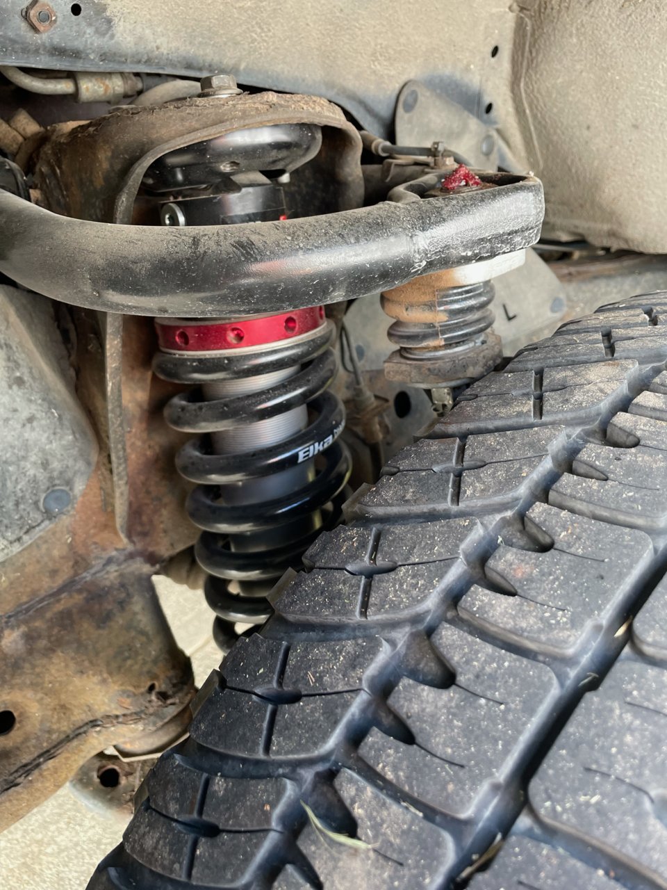

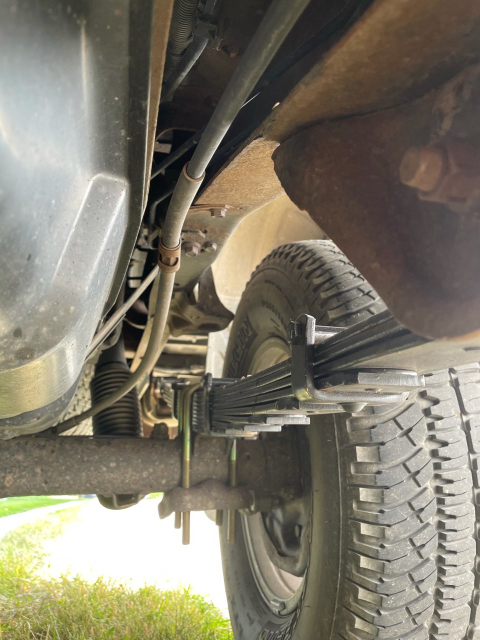

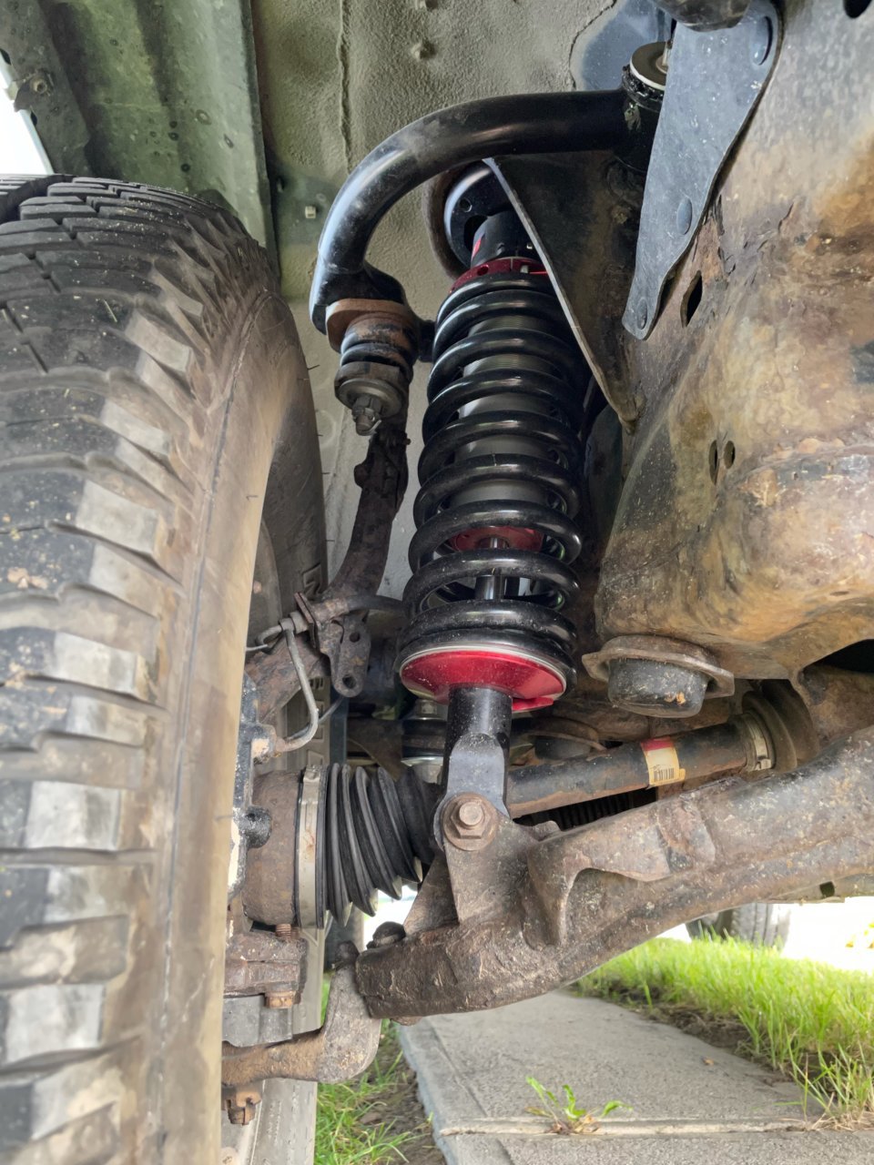

    hendybop
    hendybop New Member
    Apr 12, 2021
    #61721
    8
    MT
    2003 Tundra SR5 V6 Manual
    Elka 2.5” coil overs and shocks Deaver leafs SPC UCAs
    I have had a chance to run some rugged roads here in Montana and am very happy with the suspension. Very smooth on washboards and ruts. Excited to upgrade my wheels (after financial recovery). These pics show the SPC arms, Elka coilovers, Deaver leafs.

  15. Sep 7, 2021 at 3:43 PM
    #75
    Lil Steve
    Lil Steve Living the dream
    Apr 15, 2020
    #45041
    724
    Steve
    Gilbert, AZ
    2002 Tundra SR5 Access Cab 2WD V8
    Looks great! Might want to cut down the excess on those u-bolts to avoid bending them on the rocks.
