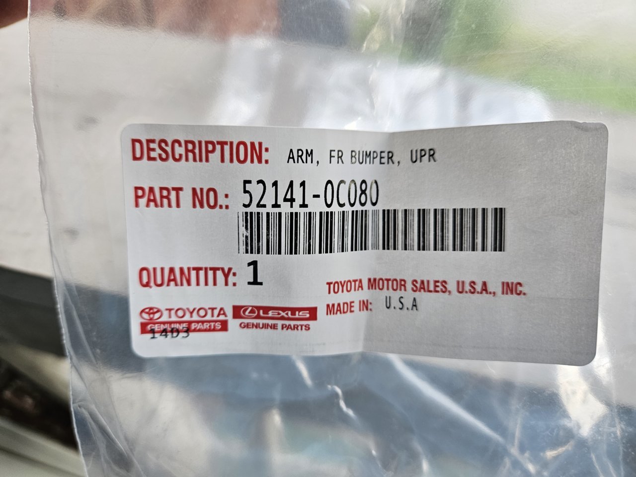

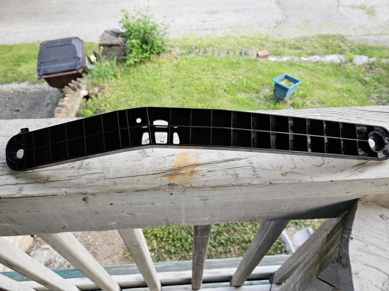

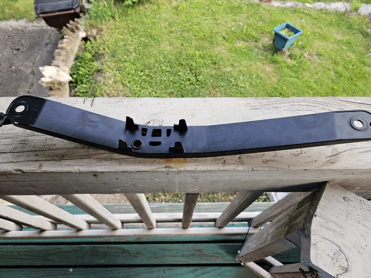

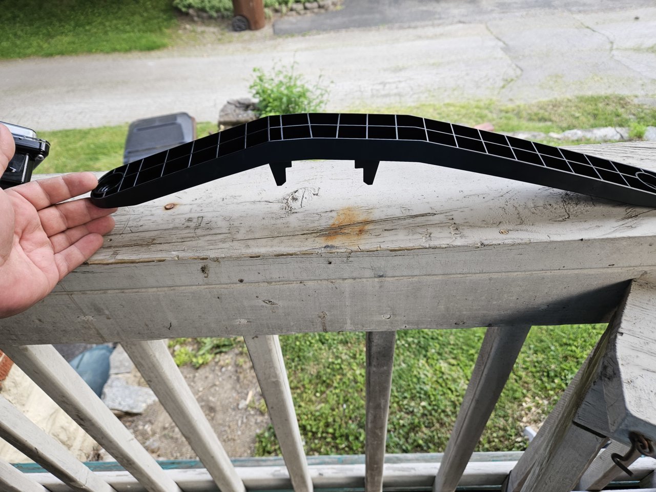

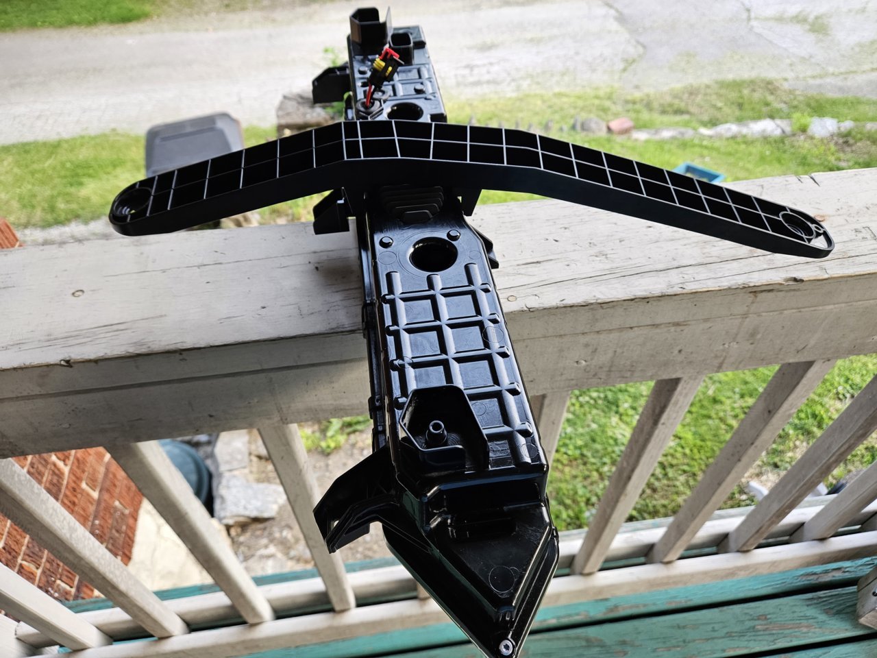

    Can confirm your part # is correct, 52141-0C080 , came in today

    Reviving this old thread: has anyone been able to confirm the bracket above (part 52141-0C080) fits behind the DD light bar for support and in front of the grille shutters without any further modifications? I seem to remember someone mentioning the 6 bolts that keep the grille shutters in place need to be lengthened or something along those lines? I ALMOST have all my parts lined up but I don’t want to tackle this project and then leave the front off because I wasn’t fully prepared. Thanks!

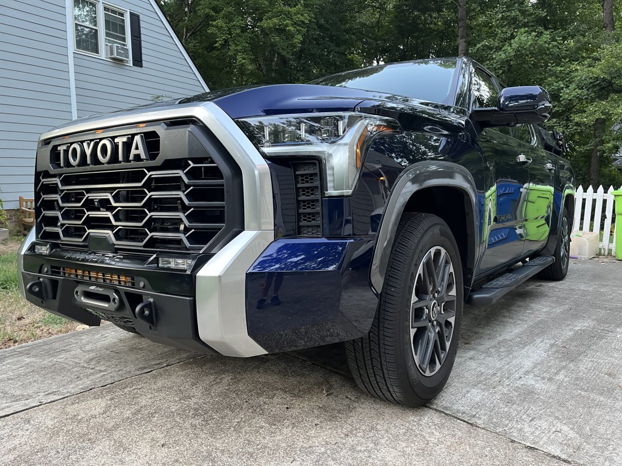

    Ok! Took one for the team and can confirm my project is not done as I had hoped. That OEM bracket for the light bar seems like it would provide support for the DD lightbar but it bumps the active shutters back about 1.75 inches requiring longer bolts and likely some 1.5 inch nylon spacers as well to help support. It looks like there is enough room behind the shutters to accommodate but I’m not positive. Hate to think I bought the $85 bracket that won’t work with anything other than OEM light bar (which I don’t want) and then I STILL need to go with BD kit if I want it to fit properly in front of the shutters without significant adjustments…
    Oh well! For now enjoy the pic below with no grill light bar installed :(

    I’m assuming those are OEM marker lights. Did you get them hooked up? If so, what did you use for wiring?

    They are OEM and they fit perfectly. Unfortunately they are still just place holders until I can locate the harness that plugs into the back of each light (it seems to be non-existent - Toyota aint sharin' it). I'm tossing around the idea of wiring directly to the pins somehow and being sure to waterproof thoroughly with heatshrink and electrical tape. Then I can tap into the fog light fuse as soon as I can find it.

    From what I’ve read somewhere on this forum, the TRD PRO fender flare light shares the same connector as the grill so this might work?
    https://thetrailhunters.com/shop/exterior/2022-tundra-trd-pro-fender-flare-marker-light-plugs-kit/
